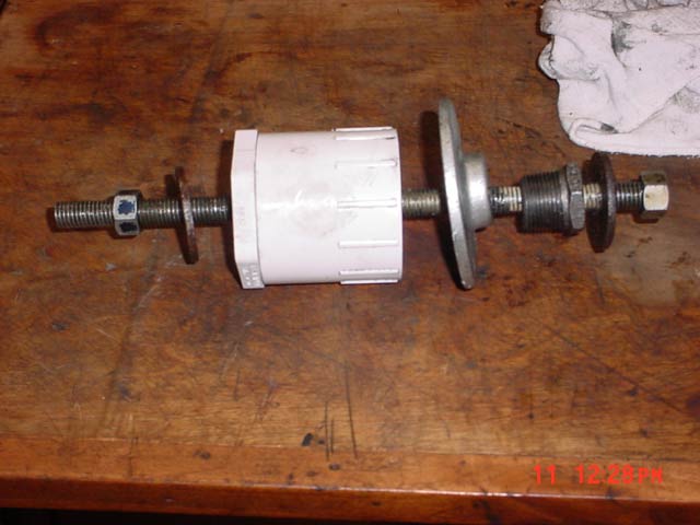

Another (Homemade) Bearing tool
If the stickers work, I will look into a wing, and ground effects. (and some "dubs") Jon
Make sure the bearings are started square. I just tapped them in a little so they were started, and then tightned the nut. I did one side at a time, that way I could ckeck that they were going in square. The PVC is a 2" coupler, threaded on one end and slip for the plug on the other. The O.D. is actually 2 13/16 at the ribs. Jon
Cost more in shipping than the tool itself! It does fit the bearing openings great. I thinkI will refine it with some stickers and such.
Another tool I made. The link http://jon.belandtechnology.com/subaru/bearing%20tool/ has more pics, shows it in use. Jon
