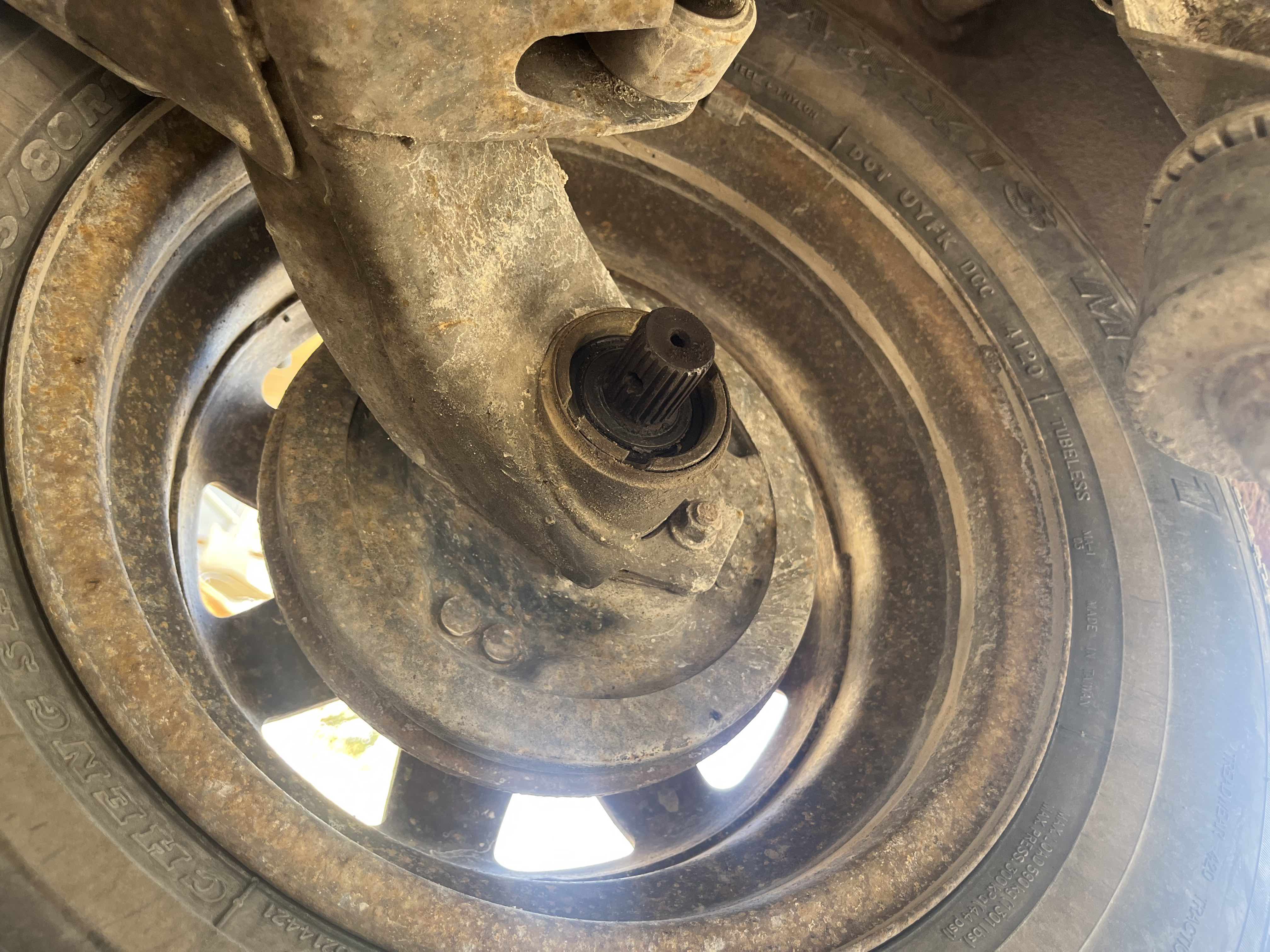

Thanks again for the replies, I ended up just putting the outer end of the cv back on the spines with the roll pin in it just to be safe cause I hadn't heard back yet I wanted to test drive it, but its good to know its fine like that. And I just reattached the drivers side axle that I could get the outer off, cause it seemed like that axle is actually fine, it was just the passenger. Problem now is it seems like the wheel bearing is going out on that wheel. I assume I let the cv axle get too bad and it messed up the bearing. I've never done a rear wheel bearing on these, how bad is that? I think I actually have new bearings for it with my parts, but do you need a press or any special tools or tricks or anything?

Sooo, thanks to all your tips, everything has come out pretty easy. I dropped the diff by unbolting the hole mustache as recommended here, and no problem, on the insides coming off the diff and the first axle pulled right off the splines coming out of the wheel, but the other side won't budge. Any tips? I put a torch on it and have been tapping all around it with the mini sledge, but nothing, no movement at all. And you can't really get in there to do anything about it. You can't pry on it or anything ya know. So, couple questions: -Any other tips for freeing the outer end? when the rest of the axle is just hanging there. -And just to clarify, it is fine to drive around with just the splines sticking out of the wheel assembly? the bearings can't get loose or anything right? tried attaching a photo of this, how it looks now, if the photo works, is that cool to drive with it like that? Thanks a bunch for all the help!
