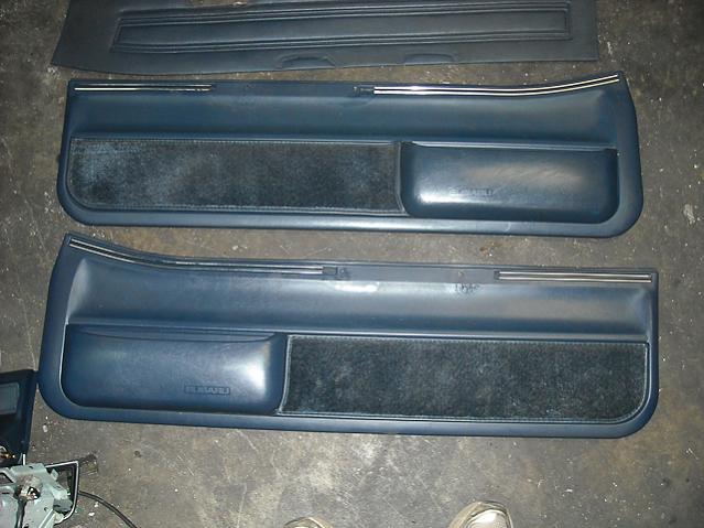

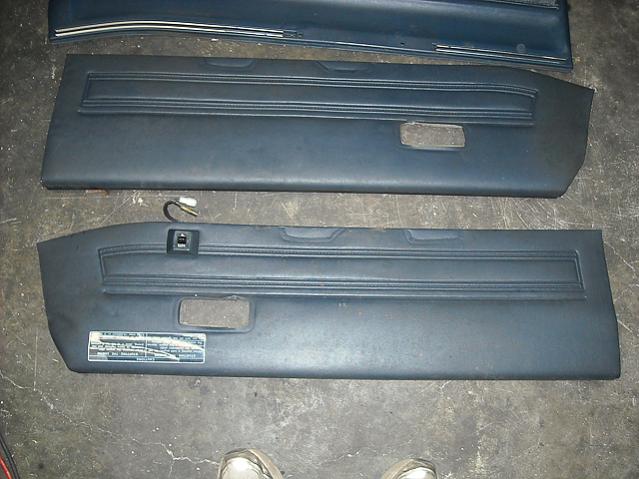

	Sorry for putting these here guys, but for some reason, he hasn't gotten the pics of the door panels I got for him. Tried three times to mail them but they never show. I'll get this deleted as soon as he see's them. Thanks!
