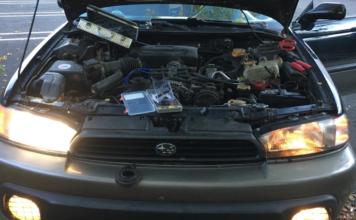

Turns out two of the wires on the headlight connector which I spliced in were reversed. Who knew it'd still partially work? I found someone else who had done the same thing and had the same exact problem (dim lights, one lamp would go dark when high beams were activated, and high beam light partially illuminated on the dash). I reversed the wires and now everything just works.

I replaced the popped fuse but the left/driver lamp is still dim. The left/driver lamp turns off when I activate the high beams (right/passenger works fine) and the high beam light is still partially illuminated on the dash. The fuse didn't pop after I replaced it despite turning on and off the headlights and high beams repeatedly. I replaced both the right and left H/L fuses. I swapped the two relays and I can feel them both click but the problem persists. No love. I'm next going to replace the electrical connector for the drivers side to see if that helps. I also have an extra multifunction switch and will connect that to see if the problem is there. Any other advice?
Yup blown fuse for H/L LH. I'm going to replace it and hope that this restores full lighting. I'm not sure what caused this fuse to blow but I will mention that the electrical connector for the left headlamp was looking mighty crusty so I cut it out and spliced in a brand new replacement connector. I'm not sure if this is related but a few weeks ago the grounding cable under the fuse box to the battery in the engine bay snapped so I had to cut and crimp. Any other ideas on what I might check?
New issue which began just the other night. The driver's headlamp is very dim and I am also seeing a partially/half illuminated high bean light on the dashboard. Whenever I turn on the high beams the driver's side lamp does out. Passenger's side is just fine. So far I've replaced the bulb, replaced the connector by cutting out the old one and splicing in a new one, and cleaning the grounds. So far no love. Ideas of what I should try next?
