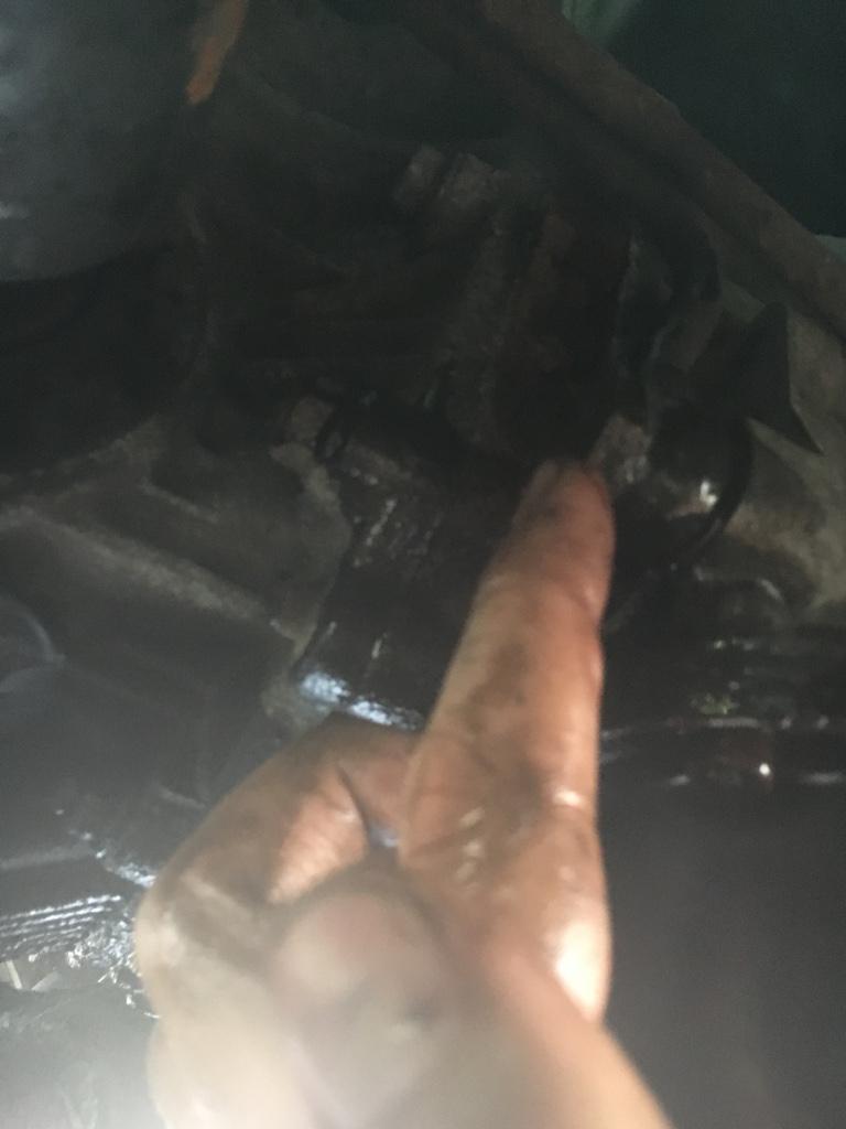

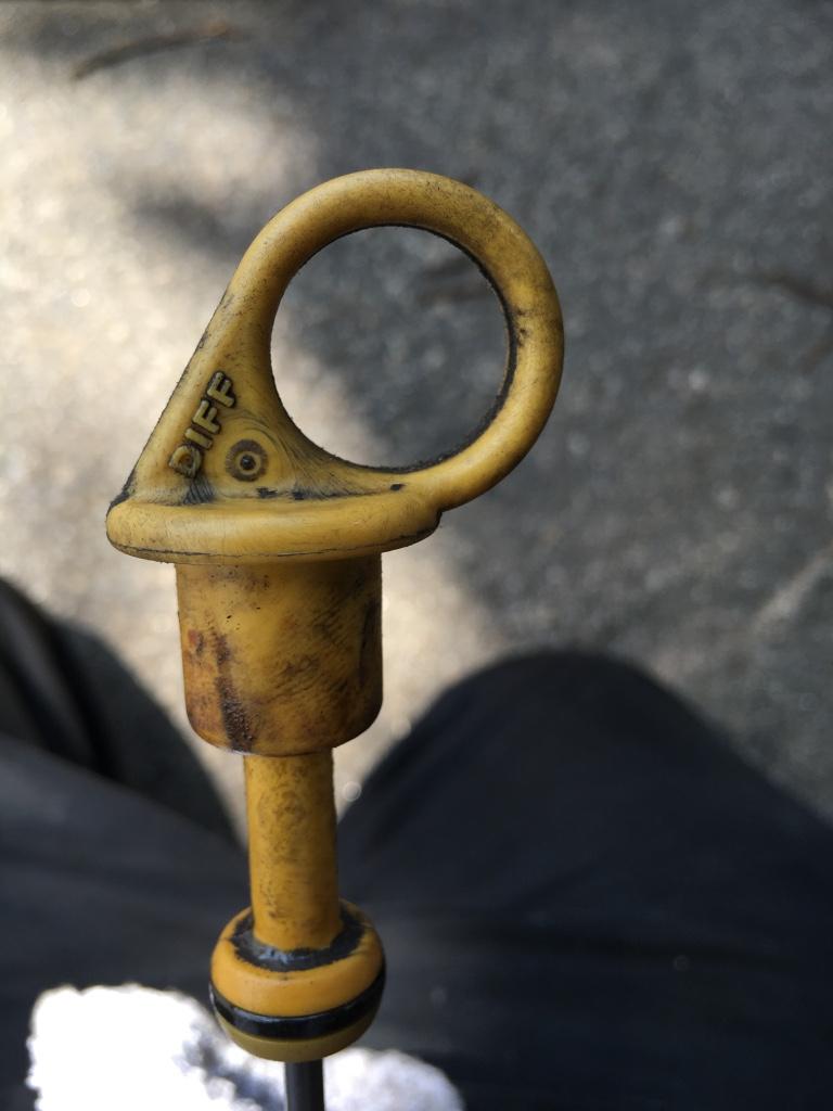

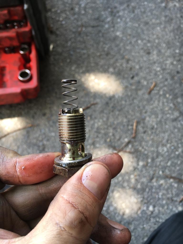

bstone replied to bstone's topic in 1990 to Present Legacy, Impreza, Outback, Forester, Baja, WRX&WrxSTI, SVXI think I screwed things up big time. I found the diff dip stick under the air box no problem. I crawled under the car to remove the diff 21mm front diff drain bolt. I found such a bolt closer to the driver's side and removed it. Out with the bolt came a spring which looks like this I still don't know if this was the right bolt for the front diff but only about 1.4qt of fluid drained out and I then added 1.4qt of Mobil1 synthetic 75w-90 gear oil. After everything was back together I turned on the car and immediately heard and saw the red fluid squirting out at high speed from where I had taken out the drain bolt. I turned off the car and tried over and over and over for 2 hours but was not successful in getting the bolt with spring back in without the high pressure squirting. In the end I had the car towed to a local independent transmission shop. Did I remove the wrong bolt? How stupid did I make things?
