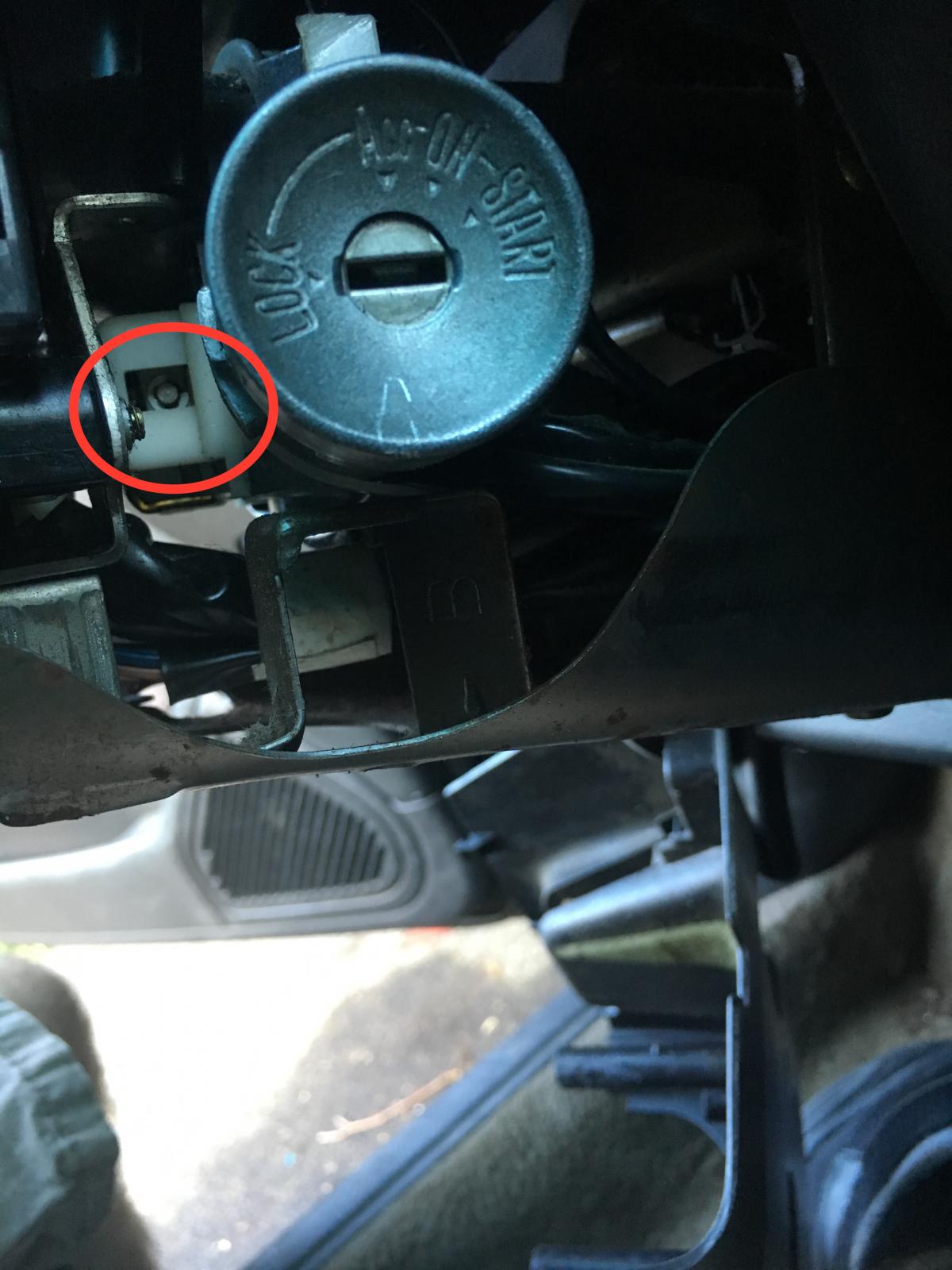

bstone replied to bstone's topic in 1990 to Present Legacy, Impreza, Outback, Forester, Baja, WRX&WrxSTI, SVXThat little thing circled in red is the key-release mechanisms. I took a long, thin screwdriver and if I push on the little button in the middle the key will release. After messing around with it the key regularly releases. I also removed the first cable on top to stop the dinger from dinging which I find really annoying.
