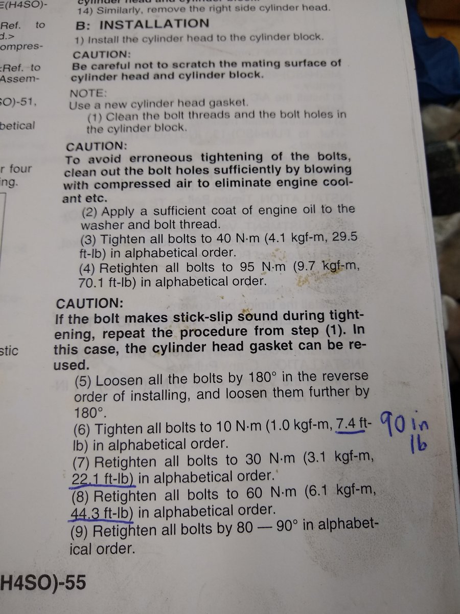

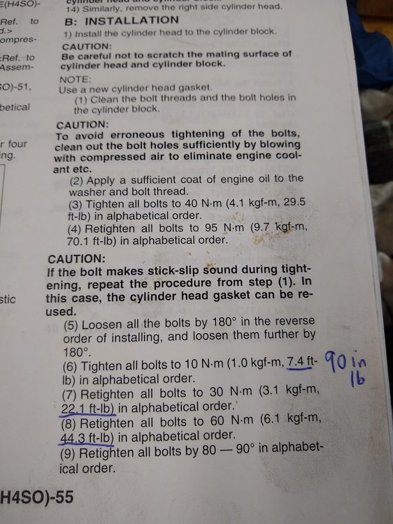

89Ru replied to 89Ru's topic in 1990 to Present Legacy, Impreza, Outback, Forester, Baja, WRX&WrxSTI, SVXPerhaps this is one of several errors. I skipped steps 3,4 and 5 below. Was following some advice that stated these steps were for new bolts only. I started on step 6 with existing bolts. One other question. How many passes do you make? I found that the early steps take 2-3 repeat passes in alphabetical order to get all bolts to the specified final torque for each step.- New head gaskets won't seal

2007 Outback 2.5i EJ253 with AVLS. 100k miles. Basic problem: Can't get heads to seal with 15 psi into cooling system. Dropped 1/2-1 psi shop air in one hour. Filled with coolant. Dripping coolant on driver side in multiple places. Next step is to use some kind of sealant on the gasket. What I'm asking is which sealant. Details below. History: Bubbles in overflow tank and gurgling noises in cabin. Never overheated under my watch but I just bought this car, have only 1500 miles on it. Did radiator exhaust gas test twice, once before sale and once after for two minutes, both clear. Drives great btw. Hot heat in cabin. Radiator level drops and would not draw coolant from overflow tank on cooldown. Coolant temp fluctuates as expected with significant air in system, between 180 and 210. Blue exhaust gas tester solution stayed blue until exposed to tailpipe fumes, then turned yellow. Tried new radiator, new water pump and hoses, bled air I don't know how many times. Finally got fed up and pulled engine out, pulled heads off, valve rockers, and cam cover and sent to local machinist. Existing gaskets: unknown vendor MLS (multi level steel) with copper spray. Machinist said warp at .002" and .004" and machined them down. New gaskets: I used Fel-Pro solution: PermaTorque MLS with LaserWeld, gasket #26415PT with the blue coating. Reused head bolts. Rinsed bolt holes with oil x2. Skipped the bolt stretching steps and just did the torque to 7.4, 22, and 44 ft-lb. Then 80-90 degrees, 45 degrees, and lastly 45 degrees on center bolts. Cam covers resealed with permatex ultra grey. Reinstalled rockers and let sit for 24h. Left timing belt off and cams loose. Did leak test as mentioned with air into throttle body coolant hoses. Tied heater pipes together with heater hose. Tied water pump intake to coolant crossover pipe with scrap hoses. Won't hold 15 psi shop air with sealed cooling system. Filled with coolant and slow drip off DS head with 15 psi. Unbolted. Rechecked flatness of heads and short block in eight locations with t square and .002 feelers, pretty much unchanged from before installing. Took heads back to machinist and he just laughed saying no one in this state can measure Ra smoothness, he has been doing this for 40 years and does them all the same. I showed him the Felpro handout stating machine to 60 Ra (600 Rz). He suggested a can of copper spray. He did say he has some other type of cutters but they come out "the same." So where to go from here? Do I need a new machinist? I've seen some use permatex aviation gasket sealer. Subie dealer says use composite gasket p/n 11044AA633. Since this car already had MLS gaskets with copper spray I'm thinking of abandoning Felpro and going with Subaru OEM gasket. In that case, which one? Sealant or not? I have a bunch of pictures to upload when I get a minute.- Mizumo Auto t-belt kits
