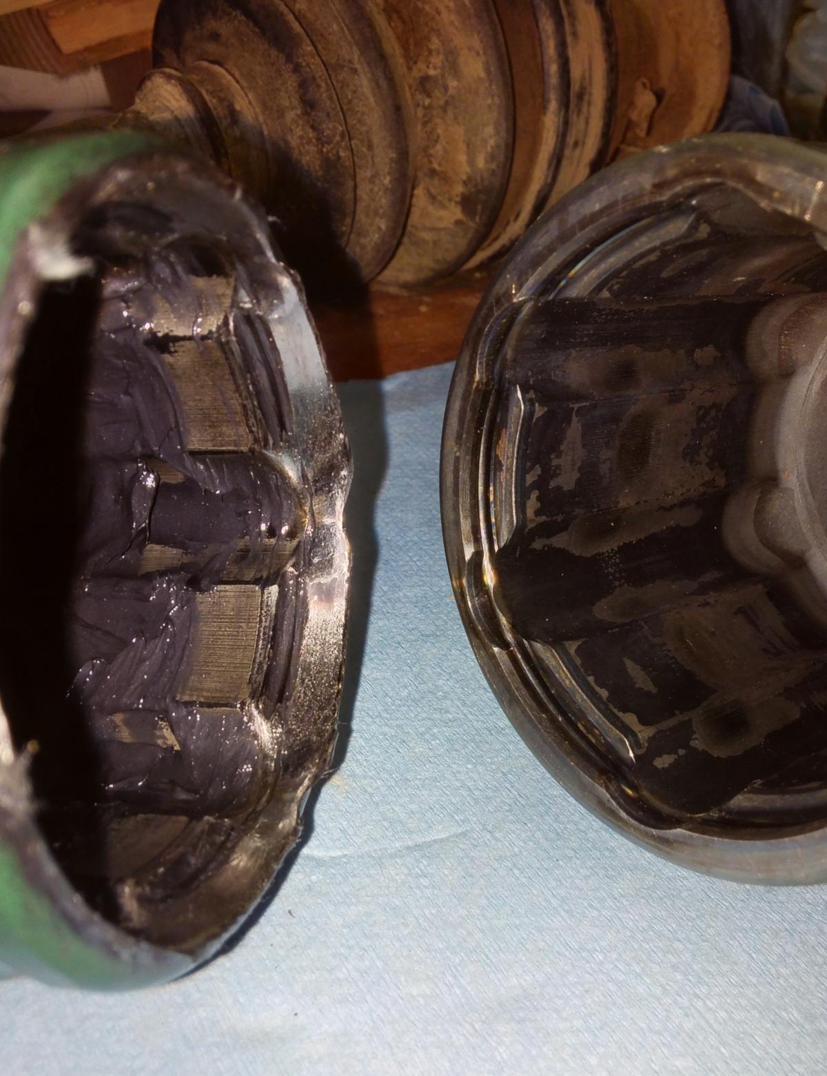

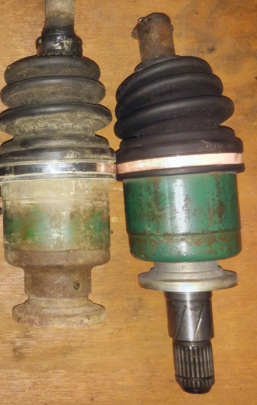

  6. Thanks for the replies. As for the clips, they are inside the diff (both sides, I checked). I haven't had any issues with the cups popping out of the diff, it's the shafts trying to pull out of the cups. See attached for the first one I broke, I was in a bad spot and had to hammer down, by the time I got out, the balls had worn the whole outer ridge away (where the snap ring used to live). I found the snap ring deformed inside the boot. Thankfully I had a spare CV to swap in, but now I'm fresh out of spares. As for lift, initially I just had the FWD rear struts and the diff in the factory location. This was fine with the original diff on the old tires, but when I swapped in the LSD, the new cups being shorter caused the first incident. Here's something else I noticed...the right side CV shaft (passenger side) seemed about 1/4" shorter than the left. It's not really the shaft being shorter (I checked with them both out), but either the diff isn't centered on the body, the bushings are really worn, or I have something bent/twisted. After the first incident, I elongated the holes in the mustache bar to shift the diff closer to the passenger side and even out the distance between the CVs, and that seemed to fix my issue for a while. However, I realized 235/75R15 tires, even with tons of massaging to the fender wells, just don't fit. I ordered the SJR 2" spacers and also made a drop plate for the diff to compensate. At that point the CV shafts were basically parallel to the ground with the car sitting flat, which seemed like the safest position for the CVs. First time I took it out like that, I think one of them popped out (I recognize that sound when the balls are skipping out of the grooves), but then popped back in after a minute. When I got out to look, the diff was noticeably twisted towards the passenger side, like the driver's side CV was wedged against it before it popped back into the grooves. I need to pull the diff again to check if the mustache bar is bent now, but I'm concerned if my axles are stretched this close to the limit, I don't want one odd bounce to pop one out again. Like I mentioned above, the main issue started from the modern (shorter) CV cups frankenstein'ed onto my old axle shafts. @Numbchux: is it really feasible to find longer cups or shafts? That was basically my first thought, but after a lot of reading in these here forums, I got the impression that they're all basically the same for this generation. Edit: attached pic
