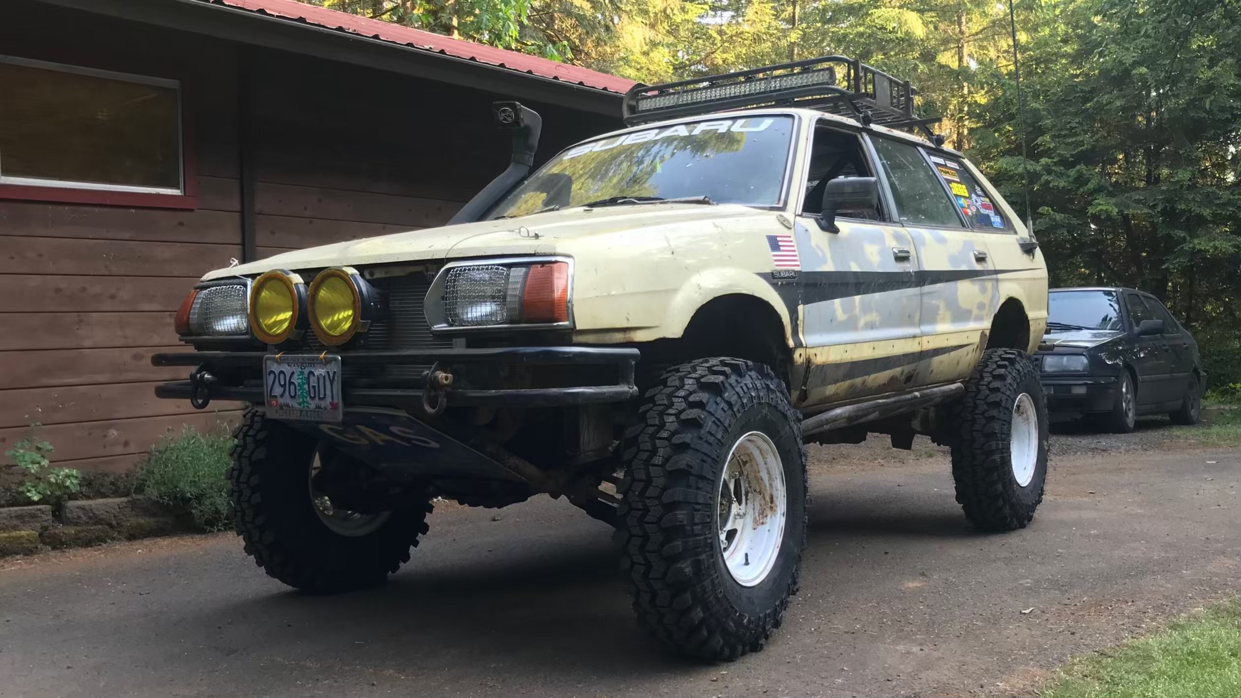

  4. Somebody buy this thing! $5000. There’s a hatch nearby that I want to go pickup. I’ve even been toying with the idea of parting it out if there is enough interest. -Samurai transfercase with 4.16 gears and parking brake. Less then 500miles since rebuild $750 -Ea82 5 speed dual range $250 -Subaru to samurai drivelines (3) $600 -Welded r160 diff $100 -Phantom grip LSD r160 $200 -8 inch lift $600 -Hybrid ea81 rear axles $100 -Ej25d $150 -Engine adapter and flywheel $200 -17 gal RCI fuel cell $100 -33x9.5x15 sx2 mounted with wheel adapters $1100 -9000lb winch on hitch receiver $200 -Gl10 rear disk brakes complete $300 -16inch Billistein coilovers, need charged $500 -14inch King 2.0 coilovers $800 -Toyota MR2 aluminum 3 row radiator with rewelded outlets $150

  7. I used an old piece of mustache bar and welded it to the stock crossmember to support the front. For the rear I built a crossmember that bolts to the radious rod blocks and welded the stock mount to that. You can see the crossmember I built in the pic below before I welded the diff mount to it.
  8. I built my own crossmember to hold the engine. It won’t fit with a 4 inch lift. 6 is minimum but 8 is better. I have a samurai transfercase but Nissan 720 is the most common to swap in.

  10. In theory it’s really simple. Transmission in permanent 4wd to transfercase to diffs. Requires a minimum 6 inch lift and at that height you should already have the lift blocks connected so you build the mounts off of that. I put a transfercase in my ea81.
