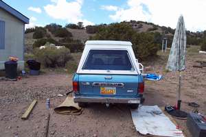

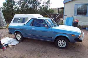

  13. The '80 is running. The chassis and drivetrain has 62,000 miles on it, and feels like it. Work completed: - replaced fuel tank - replaced rear cv shafts - replaced hood - replaced exhaust - installed some ugly spare inside door panels (waiting for moosens for nice ones) - adjusted rear ride height - installed trailer hitch Work to be done: - install weber carburator - make new lower inside door panels out of 1/4" mdf to allow for speakers - install AM/FM/Cassette - have wheel alignment done - install various tailgate trim - paint - a few odds and ends Klaus

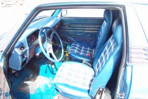

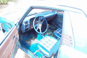

  17. Hey all, my beloved Brat died last week. I was out in LA when 4th gear went out, drove 850 miles home in 3rd. It finally gave me a reason to fix up my '80 Brat. Over the weekend I swapped the exhaust, fuel tank, rear drive shafts, and some other small minor stuff overfrom the '78. The '80 has 61,000 miles on it and looks reasonably clean on the outside, and mint inside. Over the next few weeks I will fine tune more stuff, including the addition of my weber. There are a few parts that I'm missing. I need both inside door panels, steering wheel center and an ashtray, blue and clean. Klaus

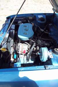

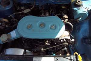

  18. I ordered 4 new factory .5 over pistons from Folger Automotive's pleiades. Ordered and received re-ring kit from rpmrons.com Ordered and received new oilpump from rpmrons.com Ordered and received torque cams from deltacams.com Ported the heads, having a 3-angle valve job done, and do some minor reshaping of the combustion chamber. I'm also considering replacing the exhaust system. I'm kinda considering installing a dual range tranny (which one would bolt up to a '91 Loyale 4wd?). Also, I will install a new clutch, new struts and new tires. Klaus
