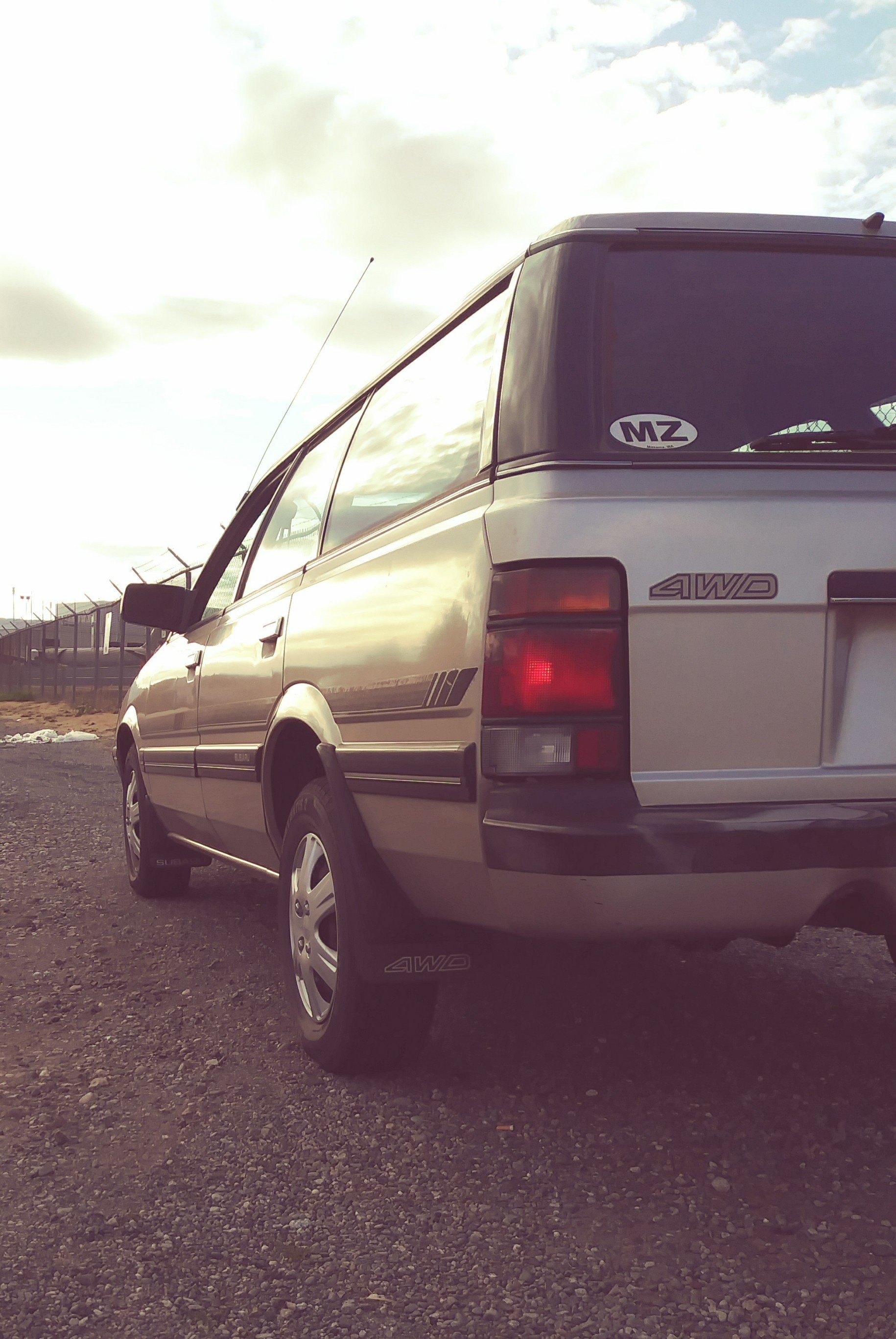

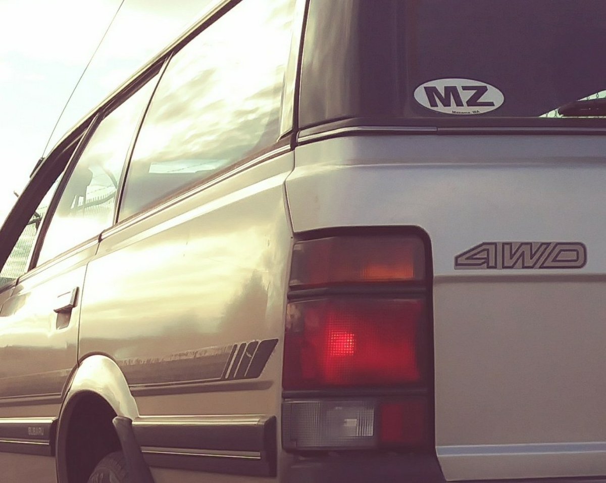

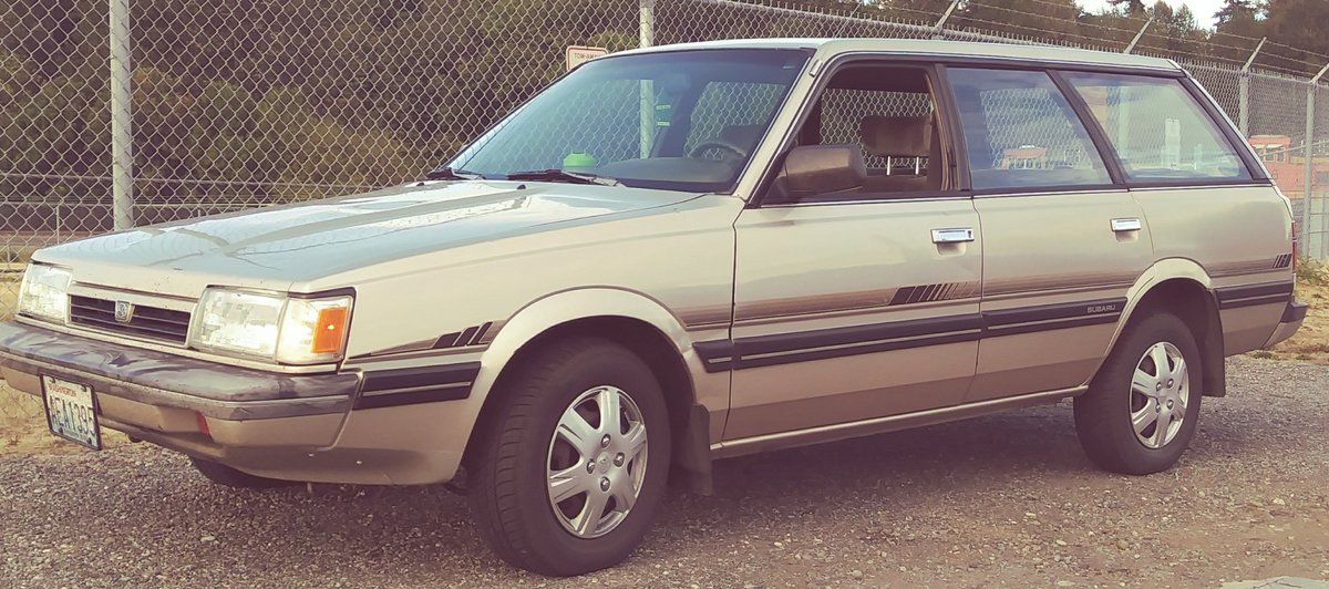

Stolen from Renton, WA on Thursday Nov. 8, 2018 at 4:18 am 1988 Subaru GL station wagon 4wd d/r 5-speed Beige/tan in color w/ a round white sticker on the rear window that says "MZ" and passenger side hubcaps missing. Also has side decals front to rear and chrome handles/trim, brown interior. Reward: Forgiveness
