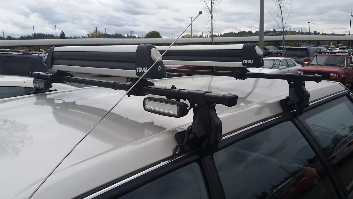

These lights are a flood/fog style display. Not so much a beam. But they do well on roads without street lights, mountain roads, and such. Each light individually can pivot up or down, left or right by hand, for better illumination of the road. Which necessarily can't be done with a solid unit. In my opinion they are more lower profile and can provide more positioning angles and locations. I hope this helps with your decision. I apologize for a late response. -

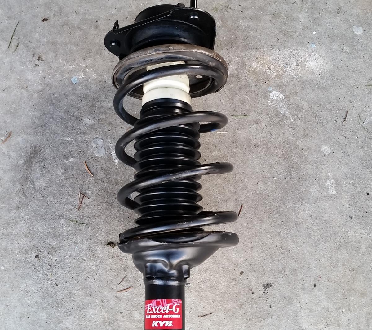

KYB-233022 = FR KYB-233023 = FL -

What Dave said. I think if your car has even ride height (no sagging or leaning) then the springs are ok. And if they aren't damaged in any other way too. I reused my original springs. -

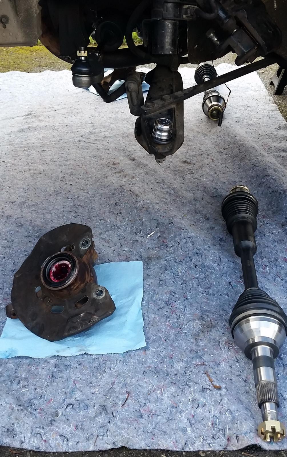

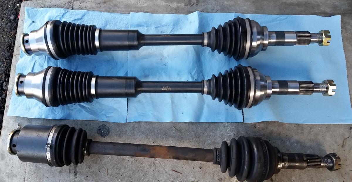

How do I edit my topic line? I bought them from RockAuto SURTRACK/TRAKMOTIVE SB9003HD (SB-9003HD) The axles are bigger as you can see on the shaft. And it does get close to the sub frame. No unusual rubbing noises at full turn lock though, but it is close. Prior to these axles, I had a worn out pair that made noise. That noise went away immediately after I replaced the struts and ball joints. I think because there was a lot of slop in my front end. Then 4 months later I replaced all the other parts you see i.e. steering, bearings, etc. This made me think that when we buy replacement axles, every other suspension component should be inspected and also maybe replaced. However, I have alignment appointment tomorrow and can report back with how it drives. I have only eyeballed my alignment and driven on side roads so far not exceeding 45 mph. I will get back about cruising speeds, cornering, braking, etc. STANDARD MOTOR PRODUCTS RU253 (RU-253) @ROCKAUTO -

They came included with the bellows. One per bellow. KYB-SB105 - FRONT KYB-SB108 - REAR
