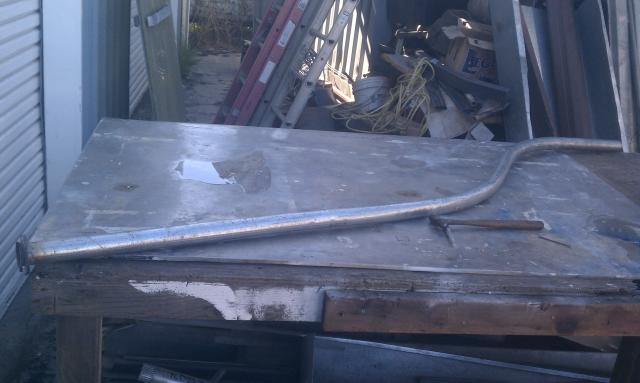

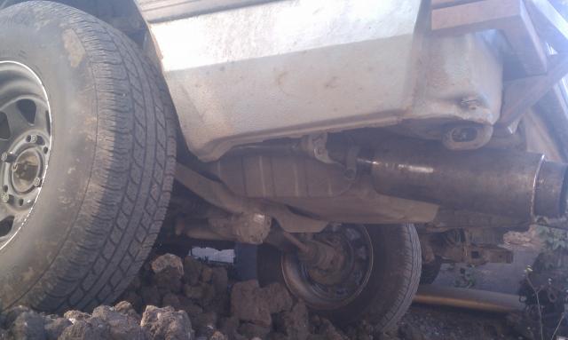

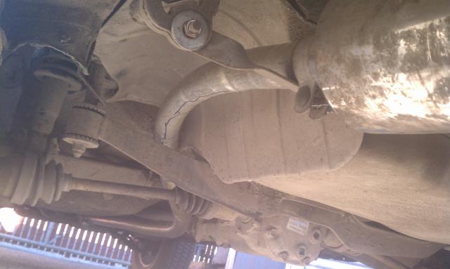

I used a harbor freight tubing bender and scrap 1 3/4 id pipe I had laying around the muffler I Robed off an old Honda the bender doesn't like thinwall but all in all the bends are cleaner than the factory bends on the stock pipe I just need to get the angle right on the tip the noises isent to bad it's quieter than my scout by far for free it's great and when I crush it I can make a new 1 and keep the stock pipe for smog

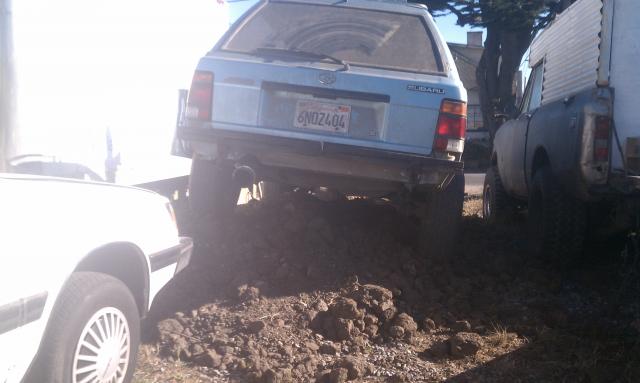

I was bored 1 day and figured I'd try and drive up a junk Honda just to see if it would do it but the Honda start rolling so I gave up
