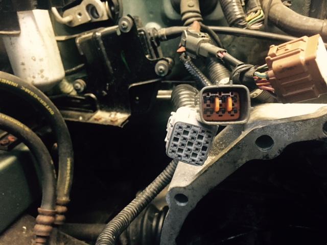

Im getting ready to swap an 2002 ej25 into a 2003 Legacy with no engine. The 03 legacy has an extra connecter that the 02 engine dosn't have. I started calling around local wrecking yards to get an 03 intake manifold for the 02 engine. The wrecking yards data say an 02 ej25 wont work in an 03 Legacy Ive seen the work around on this message board , but not I able to find it. The connecter in question on the 03 is the six prong gray coneccter between the the square white and brown conneters in the picture. I think whats going on is the 02 engine has a map sensor engine . My 03 legacy uses a maf sensor. I think the six pin gray plug is for a maf sensor. If thats true is there a work around to use the 02 map senor engine in an 03 thats looking for a maf sensor?

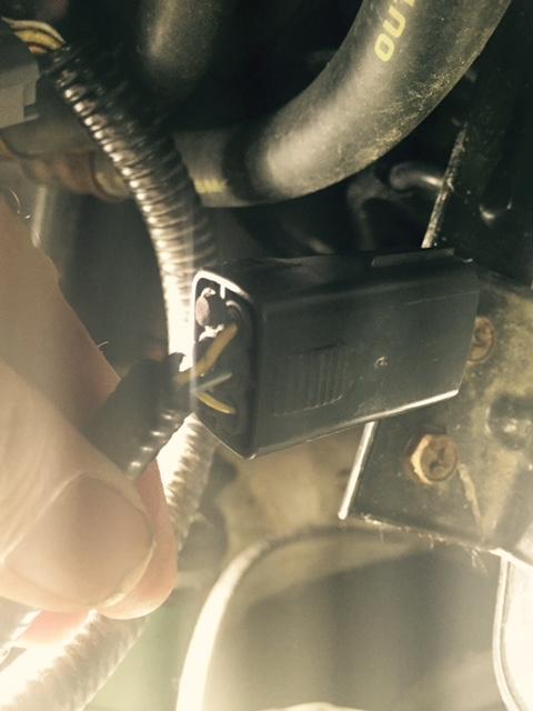

steve56 replied to steve56's topic in 1990 to Present Legacy, Impreza, Outback, Forester, Baja, WRX&WrxSTI, SVXI was thinking it was maybe a plug for the transmission. My donor engine is out of a 2002 Legacy with automatic trans. The car its going into is a 2003 Legacy with a manual transmission. The O2s are both plugged in. Ive done manual to automatic swaps with ej22s into both automatic and manual 1996 thru 1999 Outbacks with no wiring change. Ive never swappedd an 2002 ej25 out of automatic car into a 2003 Legacy that had an ej25 with manual transmission. Its a six slot connecter with two yellow, one blue/white stirpped, one orang, and two unused

Have 2003 Subaru Legacy ej25 5sp . No engine. Installing a 2002 ej25 automatic engine in it. I know where the to big two big square white and brown connecters go , but can't find a corresponing connecter on the 02 engine for the smaller gray 6 prong connecter in the between the big white and big brown connecters in the picture
