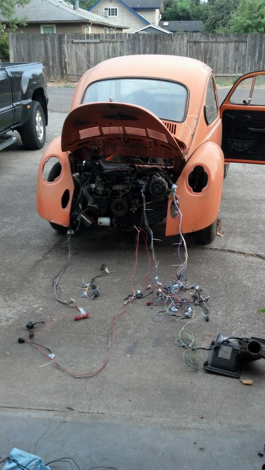

  6. I have a 1.8L EA series MPFI turbo model engine. It's out of an 87 gl-10 sedan four door. I am re-plumbing the thing after its been apart for years and need some help. Next to the fuel pressure regulator there are three steel lines. One is high pressure fuel from the pump. The second is coming off the regulator and going back to the fuel tank as return. But the third... No idea... Any hunches on what needs to be connected to it? I traced it to both the throttle body and thermomvalve. Other than that I am stumped.. http://images.thesamba.com/vw/gallery/pix/1196390.jpg"
  7. I need help again.... Its been about two years since these looms were taken from the vehicle and my photographic memory needs some photoshop... This red connector... Its right next to the ecu, and is pretty integrated.... Any ideas on where it connected to?

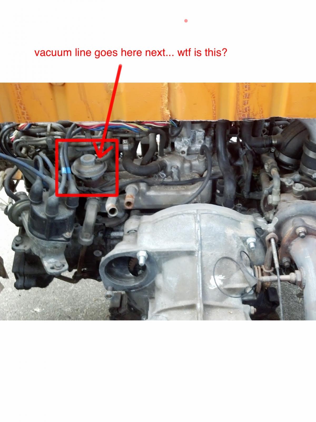

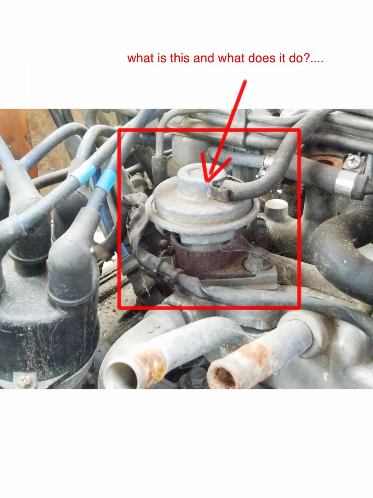

  8. Sweet!! Thanks man!!! I may be moving to portland area or Boulder CO, so keeping it emission compliant is a must. In goes the charcoal canister, egr, CAT, and so on. Thanks for second pair of eyes. My guess is that the computer tells the solenoid to open up to the egr valve when its not boosting and when the o2 sensor sniffs and says it needs some dirty air in the intake
  9. Successfully got the essential wiring for the suby engine isolated. Just need to add a new circuit from the bus bar up front to power the ECU, injectors, and ignition system.

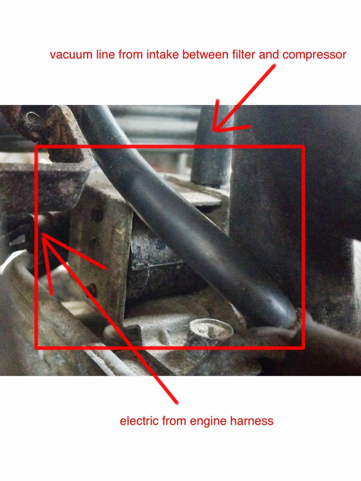

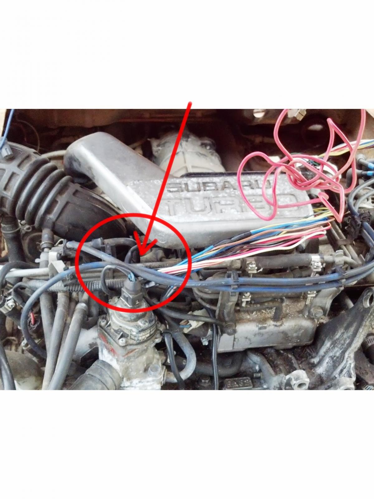

  12. Alright suby folk! I have triva for you! It's a game of "WTF is That and What Does it Do?" Following the photos from left to right. 1> two wires go to this solenoid looking deal that has vacuum lines going to it... 2> from the solenoid an air line travels to the backside of the engine where it pulls on this vacuum device.. 3> what the heck is this circuit and what does it do? Is it part of evap picking up exhaust has and dumping it back into intake for emissions? (I should add that from the vacuum device near the distributor there is a copper line going down to the exhaust port where the manifold bolts up...) Help would be awesome! Im don't have any literature to guide me along, so I'm swimming just as far as i can see.
