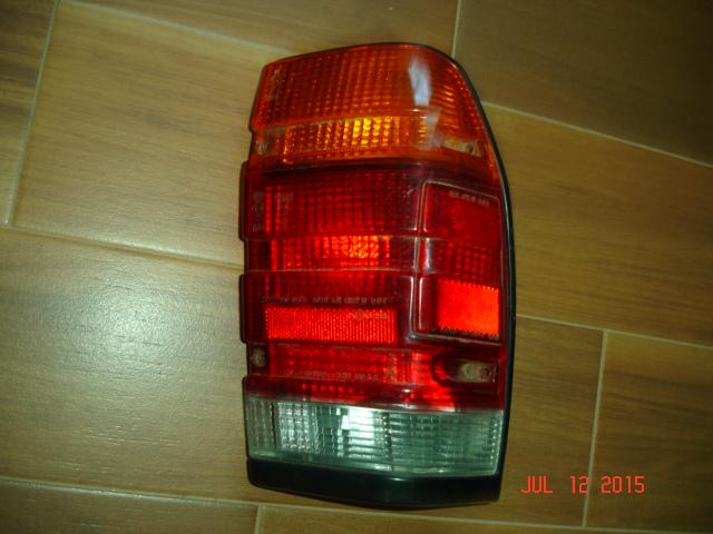

  1. no visable cracks have entire assembly. Trying to send pic How about $20 plus shippping? Paypal?
  2. I have one don't need will check it for cracks
  3. Thats an excellent price if they are less than three years old. RWL's are difficult to find.
  4. AC really saps the power, good luck finding all needed parts.

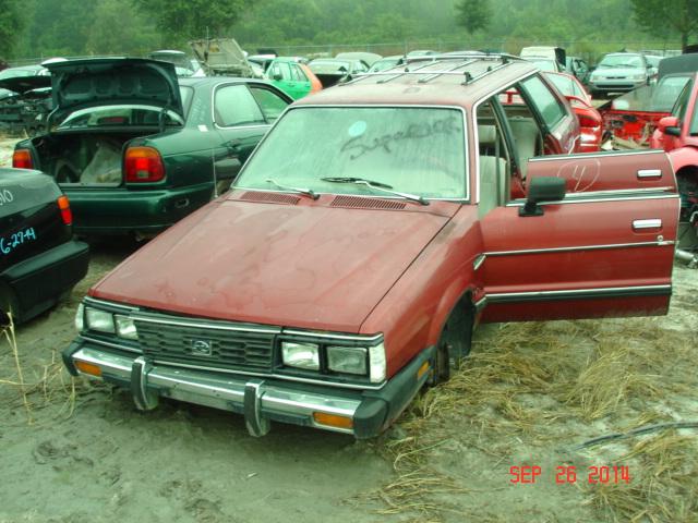

  7. Where are you, know of two Subies 85 BRAT 84 GL wagon in my area of FL.
  8. Had a similar problem with an El Camino years ago. Turned out that the liner in the fuel tank was blocking the fuel pump.
  9. Anti back fire valve fixed mine. available at ultimate subaru parts store
  10. There is a 84 GL wagon at UPULLEM in Gainesville FL. I took hood and right front fender for my BRAT. Grills and door handles were better than mine so took them too. Trim was in pretty good shape but won't fit BRAT.
  11. The 84 wagon had similar front bumper there was something different, think the bumper guards were different.
  12. 85 BRAT that I need fenders and a door for. What years and models of Subarus have parts I can use. Found 84 GL wagon that looks simular but not sure parts would fit. Told that the GL hatch backs were the same?
