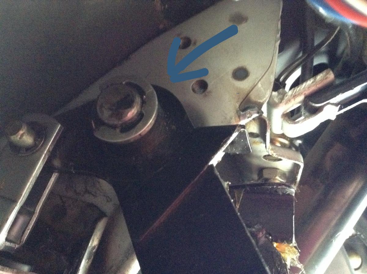

  2. Okay here's what you do... First, remove the big wash locker thingy (sorry, forgot technical term) that keeps the pedal from falling off the brass bar. the blue arrow is pointing to it in the pic.. Now you should have enough wiggle room to get that smaller clevis pin (just to the left of the lock washer in the pic) off of the pedal/cable, because you will be able to almost completely take off the clutch pedal (when you do get the clevis pin off, you WILL be able to completely take off the pedal). Does any of this help?

  7. There should be a little lock washer thingy that goes over the bolt that holds on the pedal and cable. you can get the little bugger off if you use a flat head driver or some good needle nose pliers. after that, the pedal should just slip off.
