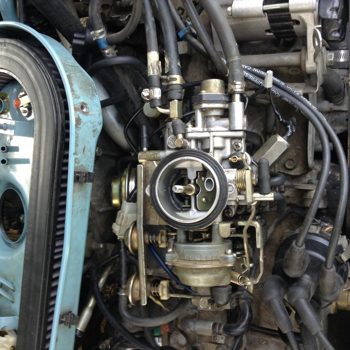

Yep I replaced the gasket and swapped diaphragms. The d**** thing still won't work. My car also seems to be running really rich. The exhaust leaves a black spot on the ground. My float is adjusted on the dot.... I did do those emissions deletes. I wonder if that has anything to do with it. Here is my carb: you can see the deletes I made. does anything look wrong to anyone?
Hitachi Secondary wont Open
Jeszek.... your a genius! I will make that conversion ASAP
