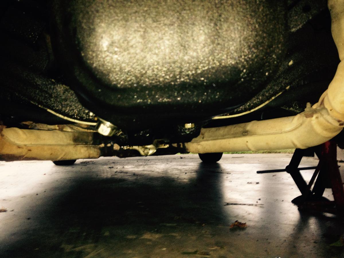

subakev replied to subakev's topic in 1990 to Present Legacy, Impreza, Outback, Forester, Baja, WRX&WrxSTI, SVXAny suggestions on getting the oil off the underside? Jack up the front and then spray is the only thing I can think of. Some simple green on there too?

subakev replied to subakev's topic in 1990 to Present Legacy, Impreza, Outback, Forester, Baja, WRX&WrxSTI, SVXWhat does everybody think about a engine oil stop leak like the one made by Lucas oil. It was reccomended to me before by a mechanic. That being said he got fired for some reason and that shop never did get my subaru running after taking it there 4 times.

subakev replied to subakev's topic in 1990 to Present Legacy, Impreza, Outback, Forester, Baja, WRX&WrxSTI, SVXMy car is running now because of those parts! Thanks!

subakev replied to subakev's topic in 1990 to Present Legacy, Impreza, Outback, Forester, Baja, WRX&WrxSTI, SVXIt's a 95 legacy ej22. I replaced the pcv valve two weeks ago along with the parts you sent me. I did notice a bit of fresh looking oil in and around the bottom of the hose going into the block from the y connector the pcv connects into. All the air hoses are new as well. I believe I am about 30,000 miles since last timing job, though that was before I had the car Valve gaskets were done about 4-5 years ago. I have quite a bit of handwritten records that are a bit hard to read. I will keep an eye on the oil level, for now it is up above the full line I will get the engine cleaned up a bit and get some more pictures in the next couple days.

subakev replied to subakev's topic in 1990 to Present Legacy, Impreza, Outback, Forester, Baja, WRX&WrxSTI, SVXThanks Gary, good to know it's nothing to crazy

subakev replied to subakev's topic in 1990 to Present Legacy, Impreza, Outback, Forester, Baja, WRX&WrxSTI, SVXAlso a slow oil drip coming from here. It's coming from the raised side (drivers), the opposite of the drain plug. I checked the oil level and it seems high. Last change got done at the AAA, they had a good deal going on...Possibly to much oil got put in? I'm going to do an oil change this week myself.

While looking around under my car when I was doing my brakes I noticed a few things and was wondering what you thought
