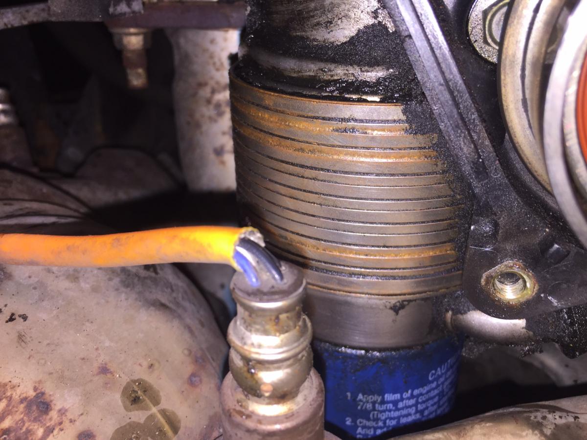

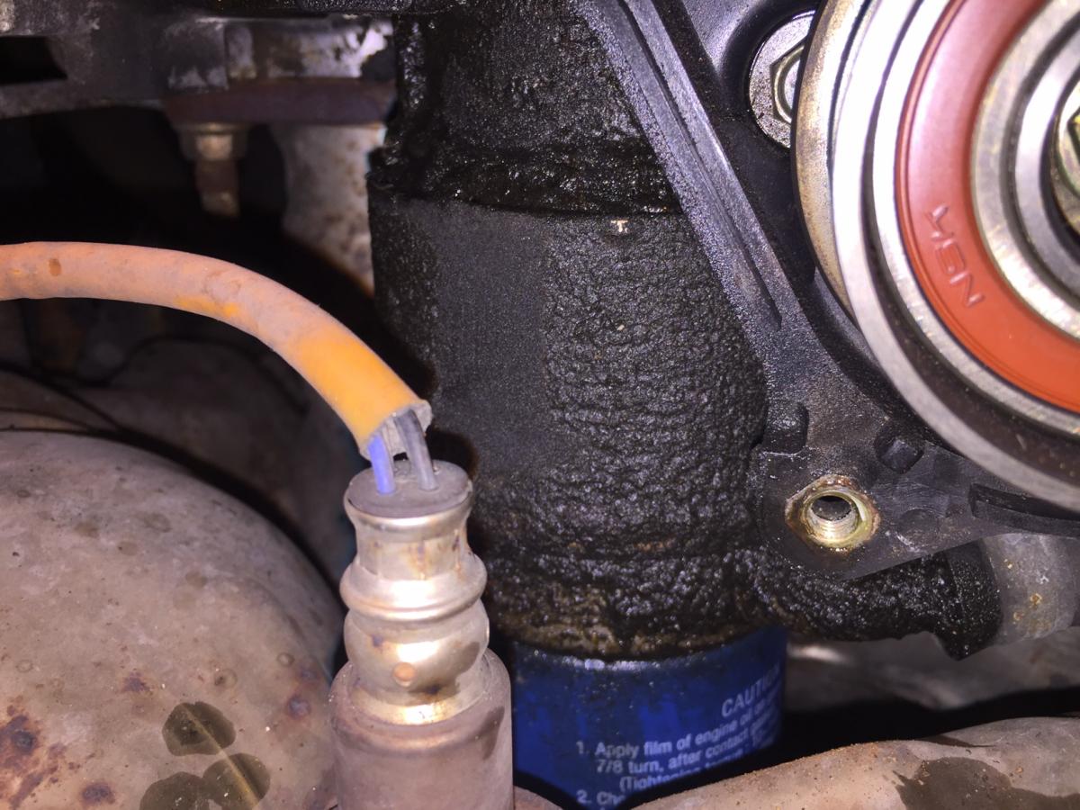

So directly above the oil filter is this weird looking thing like multiple rings stacked up (2006 forester non turbo 111k) It was covered in a thick oil dirt mixture---one pic as is and one pic cleaned What is it? some kind of oiling cooling mechanism Wondering where the oil is coming from And does anyone else besides me absolutely HATE the newer exhaust system ? The way it covers so much of the bottom of the engine makes it a real pain to see oil leaks....especially if you want to look at the full length of the head gasket area....sheesh

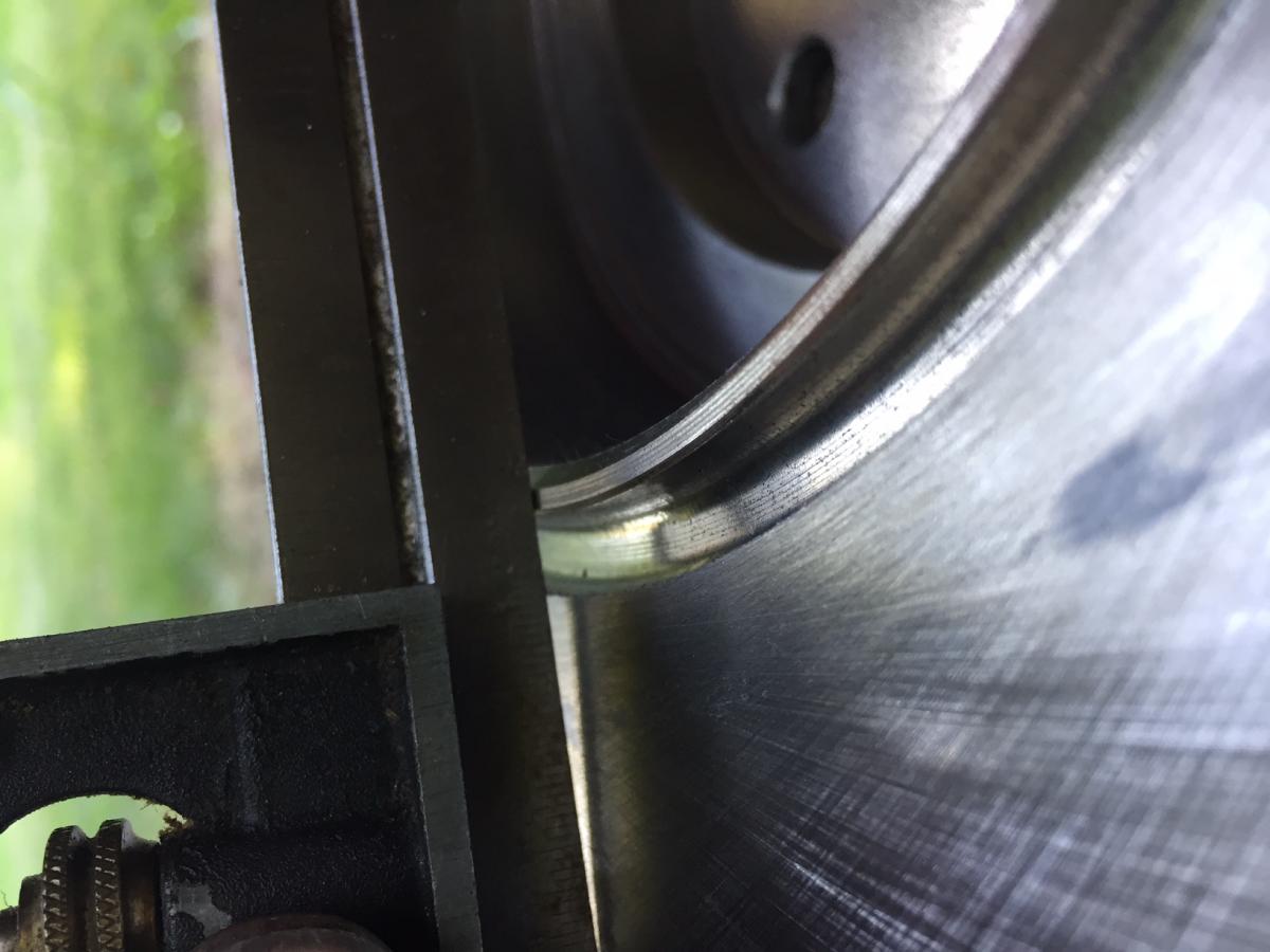

So twice now I have done rear brake jobs on my or my familys Subaru and ran into a weird issue In this case it was 2003 impresa rs Last was probably 04 wrx of my son So I mount the rotor and tire and as I start tightening the lug nuts, the tire gets harder and harder to spin...until it totally will not spin at all Take a look at the pic of the new rear rotor....that raised lip on the inner edge of the drum opening (for the shoes)...as I tighten the lugs....this rams into the face plate surrounding the brake shoes It took me awhile to figure out what was wrong the first time....this time I recognized the problem immediately Take them off and grind the raised lip down flush with the rotor disc surface Autozone rotors.....I doubt they gave me the wrong parts but.....?
