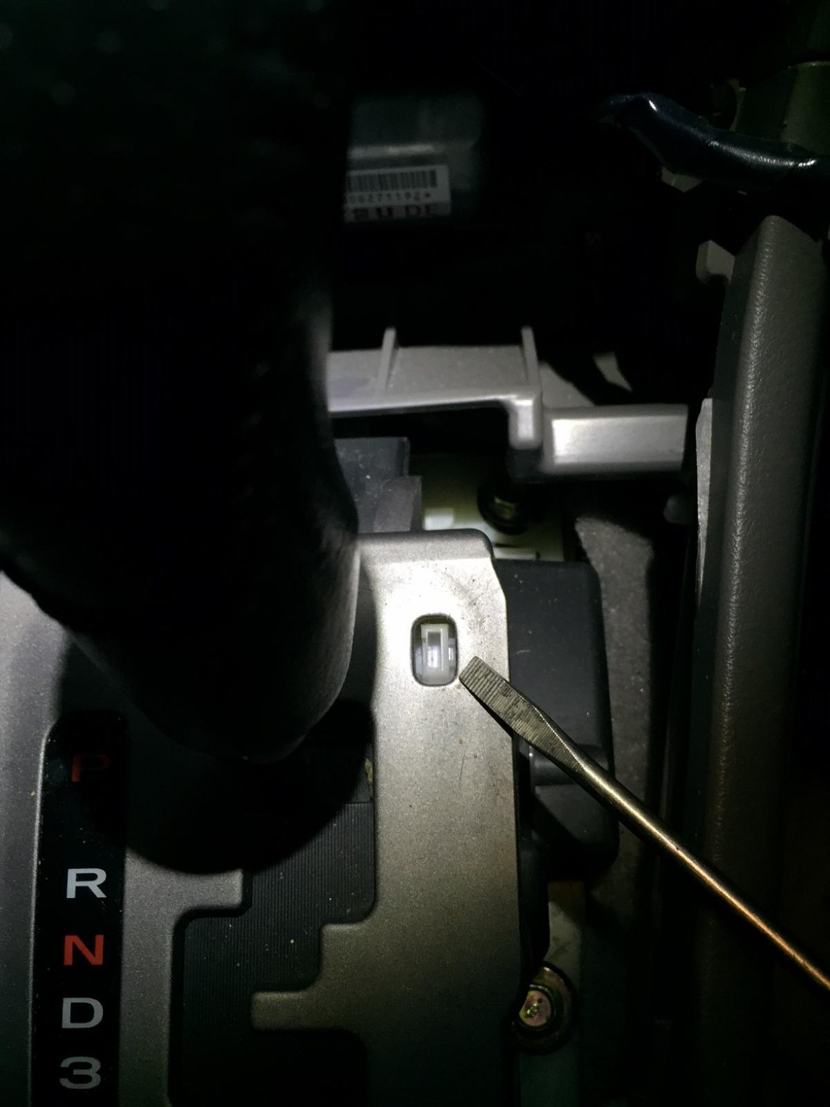

bgambino replied to bgambino's topic in 1990 to Present Legacy, Impreza, Outback, Forester, Baja, WRX&WrxSTI, SVXFairTax......you are right.....I did not hear a click under the shifter when pressing on the brake pedal This morning it was intermittently working and I can definitely hear the click when I step on brake (when it is working properly) So what is this part called Can it be cleaned? I thought I read somewhere that that's all it may need Not sure how to get at it though The huge suby junkyard 40 minutes from me will sell the whole shifter for $75..... Would rather clean it if possible

bgambino replied to bgambino's topic in 1990 to Present Legacy, Impreza, Outback, Forester, Baja, WRX&WrxSTI, SVXok...this morning I used the remote starter....when I got in the car it shifted with no issue Maybe at lunch time I will go out and see if i can here that click you spoke about (assuming it shifts flawlessly) I will see my mom tonight--she has an 07 forester...I am going to listen to hers also thanks

bgambino replied to bgambino's topic in 1990 to Present Legacy, Impreza, Outback, Forester, Baja, WRX&WrxSTI, SVXno sound when pressing the brake....even when it is working properly The only sound is when the shifter is moved left-to-right while in the park position---you can hear a solenoid clicking under the dash I went out and popped the panel off around the shifter---there was a little "cap" I pulled out,,,,,see the picture This is similar to my 95 legacy I pushed that white thing with a screwdriver and that solves the problem It over rides the lock So its some kind of shift lock Not sure how to get to it underneath there or what the part is called...

06 forester Now....a week ago I got a remote starter put in the car....but I don't see any relationship to this problem I noticed today that if I step on the brake it wont come out of park into reverse. I release brake pedal...try...nothing do it 5-6 more times nothing Then next time it will shift out of park as normal If I KEEP the brake pedal down....I can put it back in park and back to reverse no problem....I can move it 10 times Then release the brake pedal and step on it again...the shifter will not move.... I have to press and release it maybe 10 times before I can finally get it to shift out of park I do hear the electronic relay clicking every time I move the shifter (yes even when I cannot get it into reverse)----it clicks when you slide the shifter to the right Is it a faulty switch attached to the brake pedal? Is it a neutral safety switch/ under the shift console?
