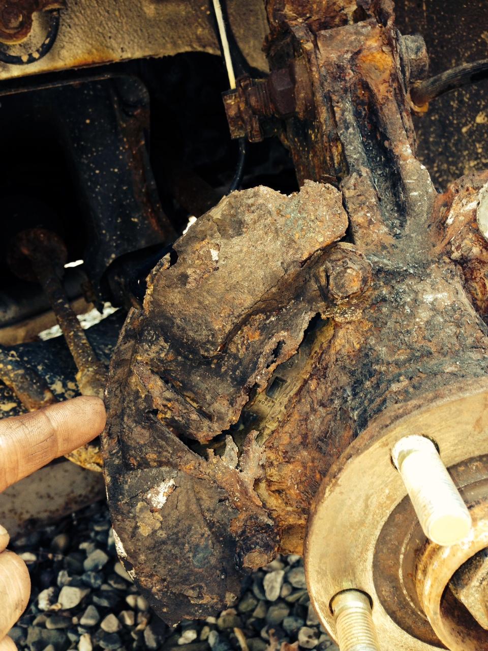

bgambino replied to bgambino's topic in 1990 to Present Legacy, Impreza, Outback, Forester, Baja, WRX&WrxSTI, SVXwhat I am pointing to is the sheet metal water shield.....for the brake protection Does anyone bother to replace these if shot? yes I suppose salt damage anyone know what years would be compatible with 03 RS axle housings? my inspection guy would not bother looking under car...been going there for years

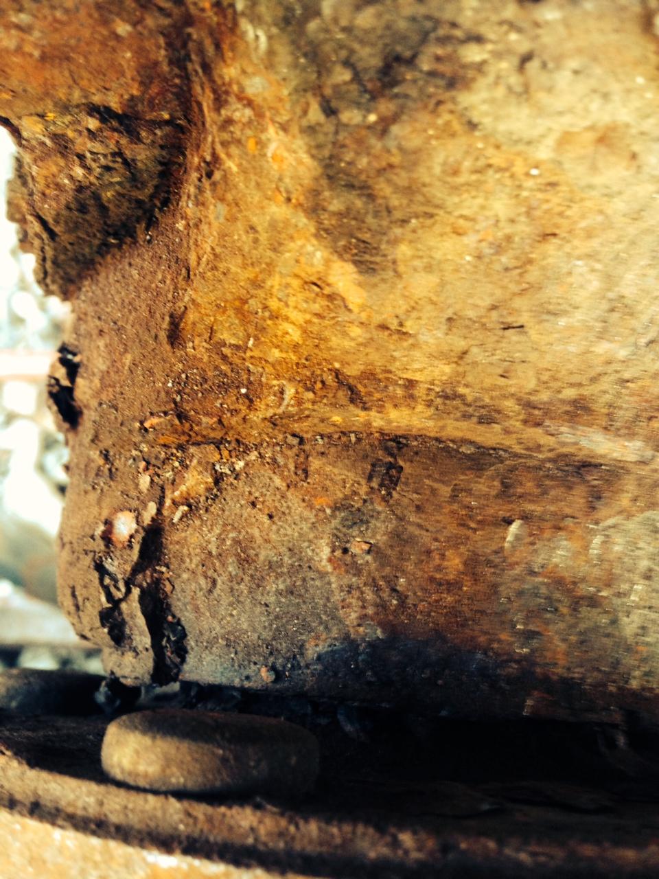

See pic....picked up a nice 2nd car for my sone...03 impreza 5spd with 44,000 miles...driven by 50+ year old woman took good care of But low mileage means a lot of sitting Body and underside is good the brake job I am in the middle of is one of the worst ever--particularly the front--rear is not bad First, the 17mm bolts holding the caliper frame were bad enough that I could not get a wrench/socket on them VISE GRIP time And since they may never have been removed...heat was required...man did that suck the axle housing behind the rotor had so much rust...I chipped of maybe 1/8" thick of material....I'm not kidding I will degrease/prime/paint and maybe shoot some rust proofing on the area (maybe not the rust proofing) I was almost wondering to get new housings....but that would probably be steep$$---then bearings--I don't want to do all that I already have to do all calipers which I did not expect Anyway....there are sheet metal shields behind the rotors (my finger is pointing to shat is left) Is it worth replacing or not really matter? Not sure what they cost new...subbie dealer online? thanks
