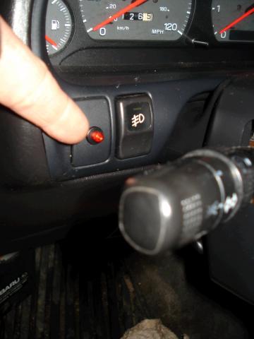

2000 Forester Front cornering lamp in fender got hit What years will fit? thanks- what is this red light?
bgambino replied to bgambino's topic in 1990 to Present Legacy, Impreza, Outback, Forester, Baja, WRX&WrxSTI, SVXthanks guys I don;t have a fob and am just going to sell it- what is this red light?
98 outback wagon what is this light...it was flashing ...it also appears to be a button...i just picked the car up to flip thanks- temp gauge not working correctly

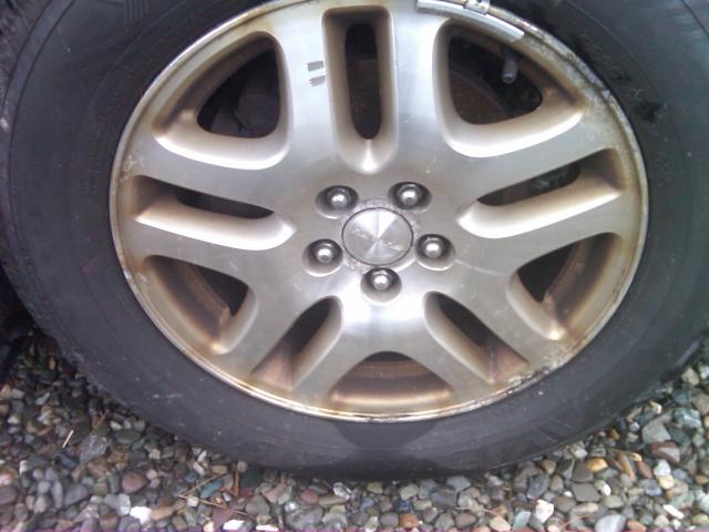

And please...no jokes like..."elbow grease" LOL any good chemical cleaners that get the brown film off...bought the rims like this thanks- tire rim compatibility?
bgambino replied to bgambino's topic in 1990 to Present Legacy, Impreza, Outback, Forester, Baja, WRX&WrxSTI, SVXJohn Great tire calculator...thanks! looks like tire clearance should be ok...I am assuming the subaru rims from 96 compared to 02 will bolt up but will try it maybe today and see - I learned something very interesting...
