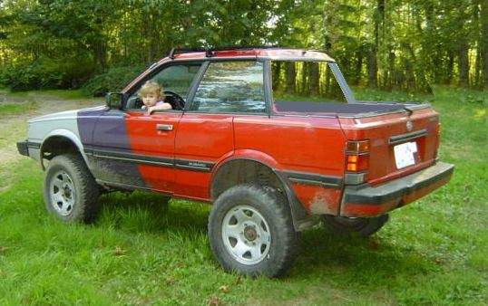

  18. OK now I want to Awesome offroad machine based on the EA82 , here are some of the details I would like #1.... run 31" tires , #2 ....keep stock diffs 3.9 ratio , #2.5. have a lower then stock (all stock, even small 13" tires) 1st gear #3 ....have lots of ground clearance , #4 ....remove all the weight I can ( do not add a ton with extra ........transfercase, diff and framework)( remove all doors, rear hatch, ........rear seats,trim off front) #5 ....and still drive at normal speeds on the road, heres my question . how to go about this without Mortgaging my house,and making it to difficult to do, it would be Cool to keep all the stock drive( engine, transaxle, diff ,axles), if there was someway to get a extra low gear out of that transaxle, maybe cut a hole in the side where the HI-Lo gears are and add another set that works through them, maybe drop the transaxle and not the engine and run a chain and sprocket between the 2 , or even gears,and if so what kind of a reduction ratio are we talking about whats your ideas? Scott
