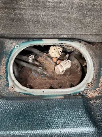

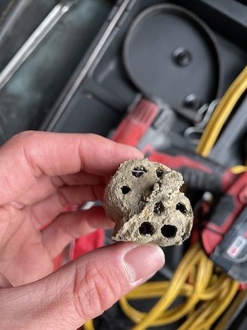

YnotDIY replied to YnotDIY's topic in 1990 to Present Legacy, Impreza, Outback, Forester, Baja, WRX&WrxSTI, SVX@moosens @lmdew @idosubaru thanks for the replies. I got the car back to my house. Then I opened up the panels under the carpeting in the trunk to access the fuel pump and sending unit. think it's either of these? RIGHT SIDE FUEL PUMP (lol no one has been in here) LEFT SIDE FUEL SENDING UNIT (my fuel gauge also never reads correctly....wonder why...lol) lol at the mud dauber nest thats in here and acorns. Seems pretty obvious what the issue is.... I'll be ordering a new pump and sending unit after I pull these two out and document the process. I'll post updates when I have them. Basically car died going down the road after repeatedly cutting out and stumbling intermittently around 50mph. It has been cutting out in the last few months, but nothing as bad as right before it died. I tried to turn it over and it would run for a bit on the extra fuel that was in the line, then eventually it would crank, but not turn over at all. More soon. Cheers! TJ
