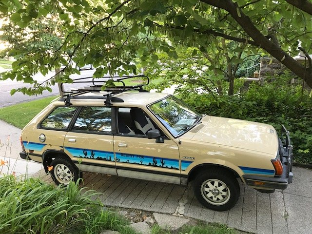

Here is The Desert Fox - I got this from @Mechanical_misfit ended up selling it and then getting it given back to me....the kid that bought it couldn't maintain it and gave it to me for free. basically a $1,300 rental haha. JimBo has a whole thread on here about the build out and upkeep. He can't seem to access his account anymore. -
