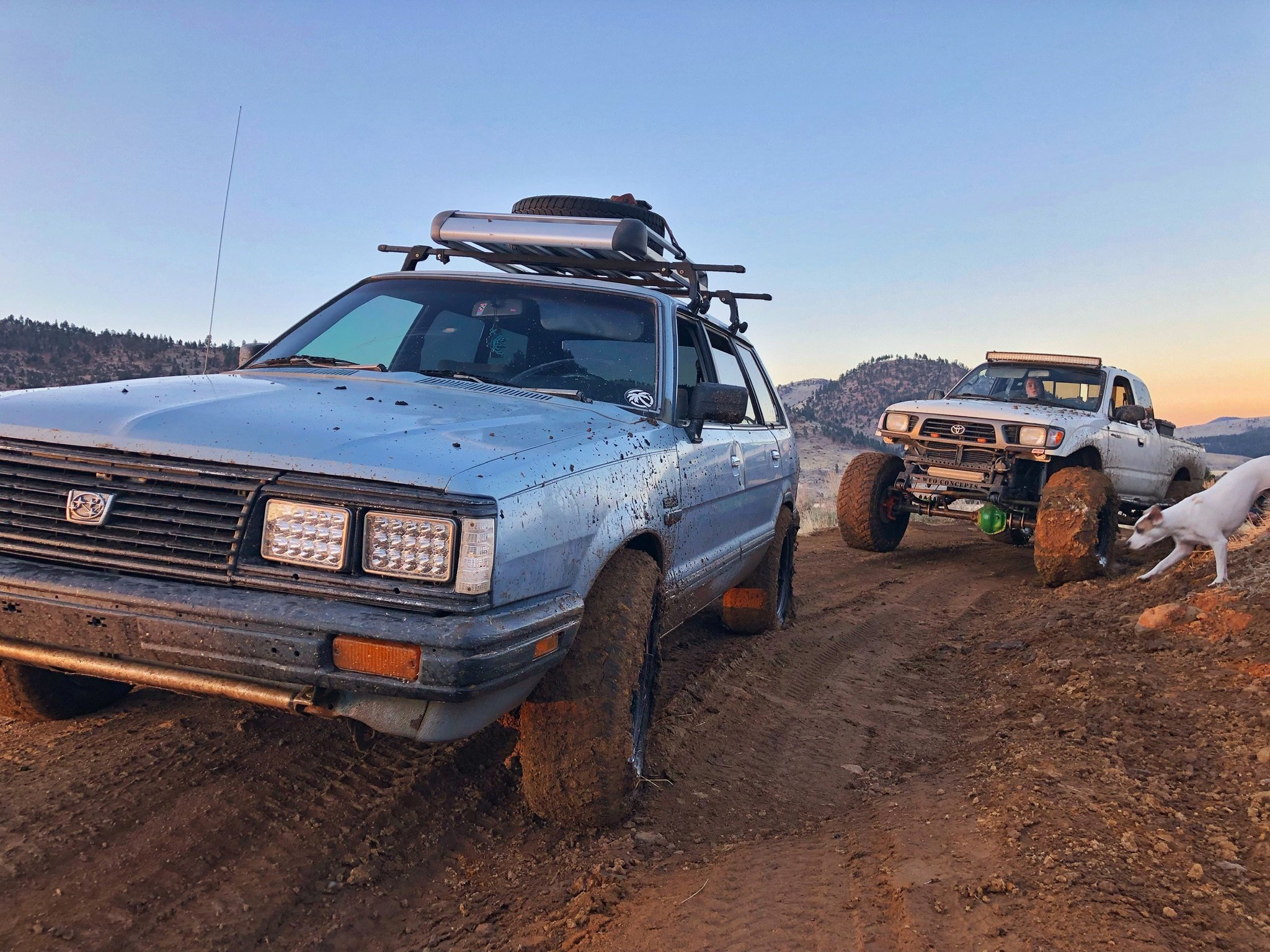

  16. Here’s a picture from the adventure weekend that I broke my exhaust and officially tired my suspension out. It was an amazing weekend we will be going back to these hot springs.
