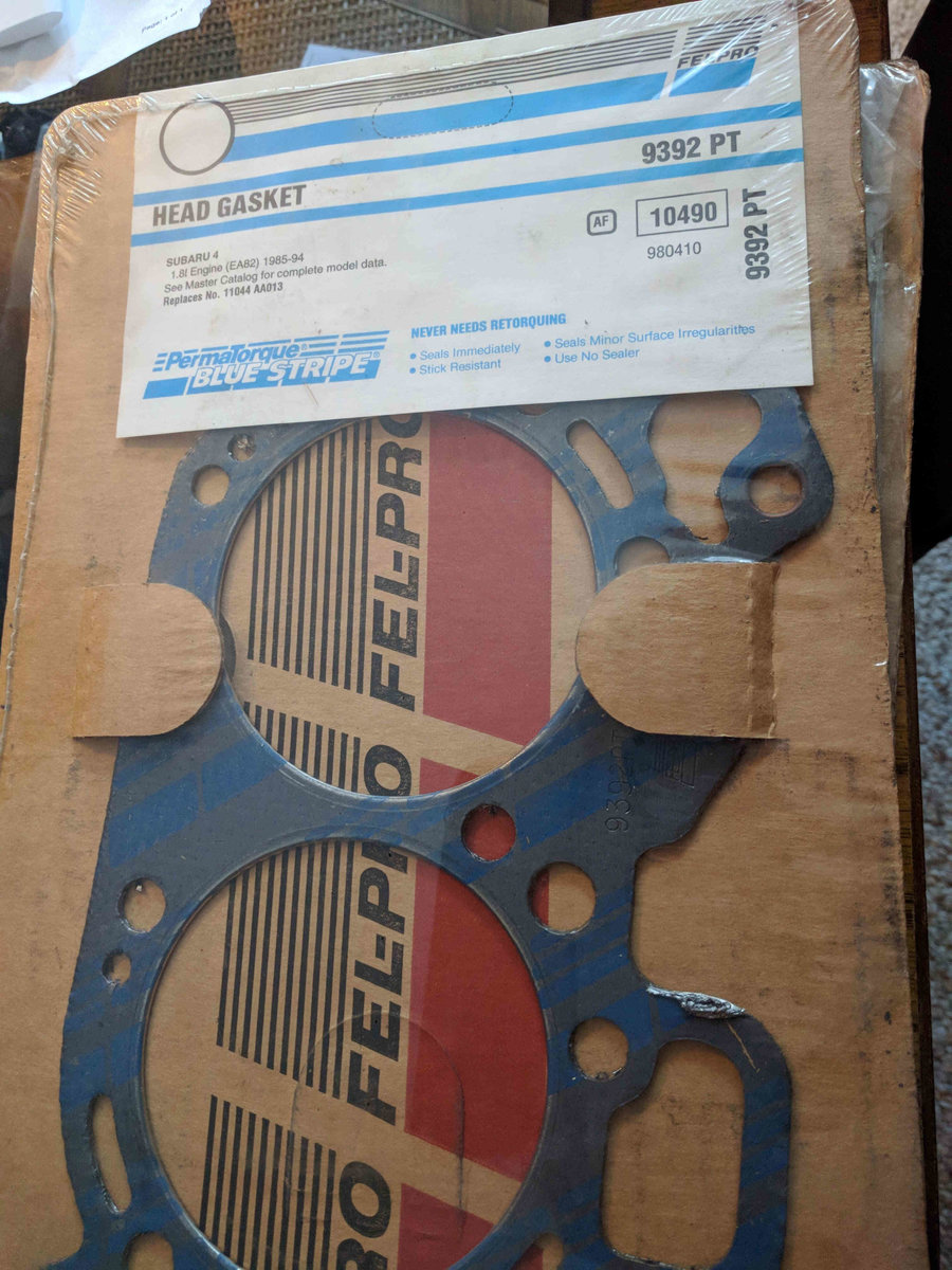

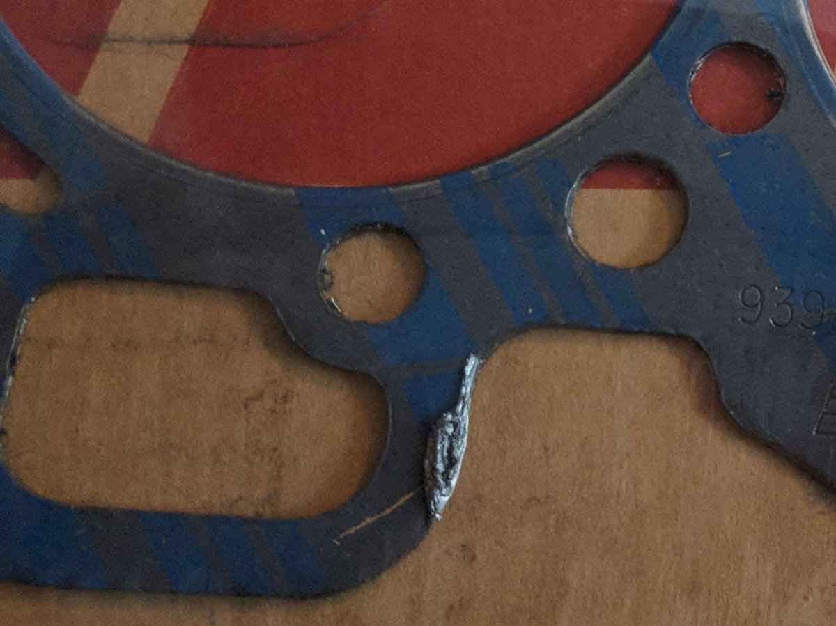

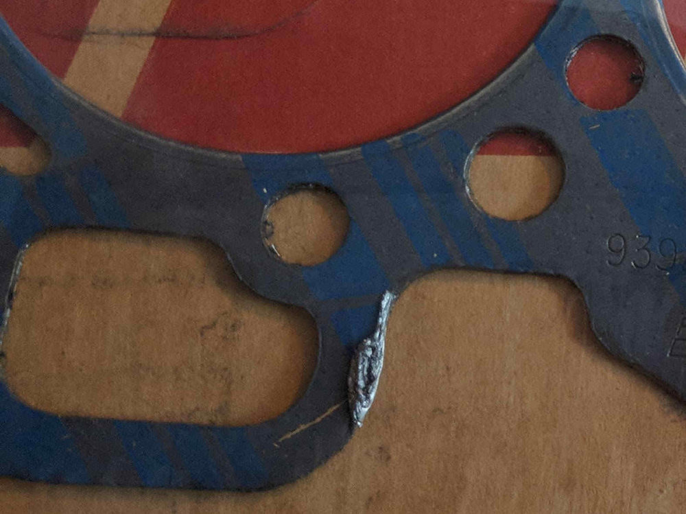

  8. Just got my order from Rock auto and am excited to try GD's post apocalyptic machine shop techniques to mill my heads this time around since I had a gasket blow after only 24k miles since I did this last time without milling the heads. However one of the gaskets they sent me is pretty mashed in one of the corners, would you guys use it? I should probably just be patient and wait for a replacement because I'd really hate to do all this work and then have to take it all apart again.

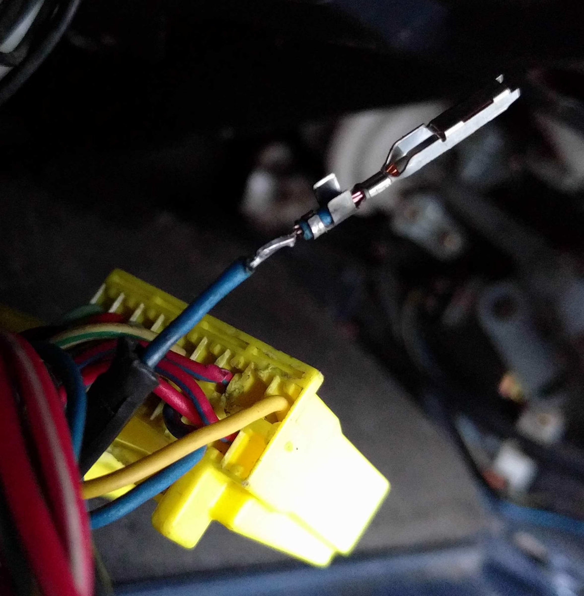

  13. Hi all, I've been under my dash pulling my electrical bits apart trying to diagnose something and today while pulling out my ECU to get at my fuel pump relay I noticed a wire coming from one of my ECU plugs that's more than a little janky. The FSM lists the wire as being "Line end cord output" which means a whole lot of nothing to me, so I'm hoping one of you lovely folks might have a better idea what that means so I can decide whether or not I should be fretting over getting it more properly connected. There's the wire in question, old solder barely holding on by one copper strand And here's the FSM labeling that wire as #11 on connector F108, "Line end Cord Output" Does that mean anything to any of you?
