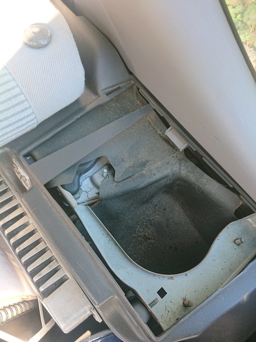

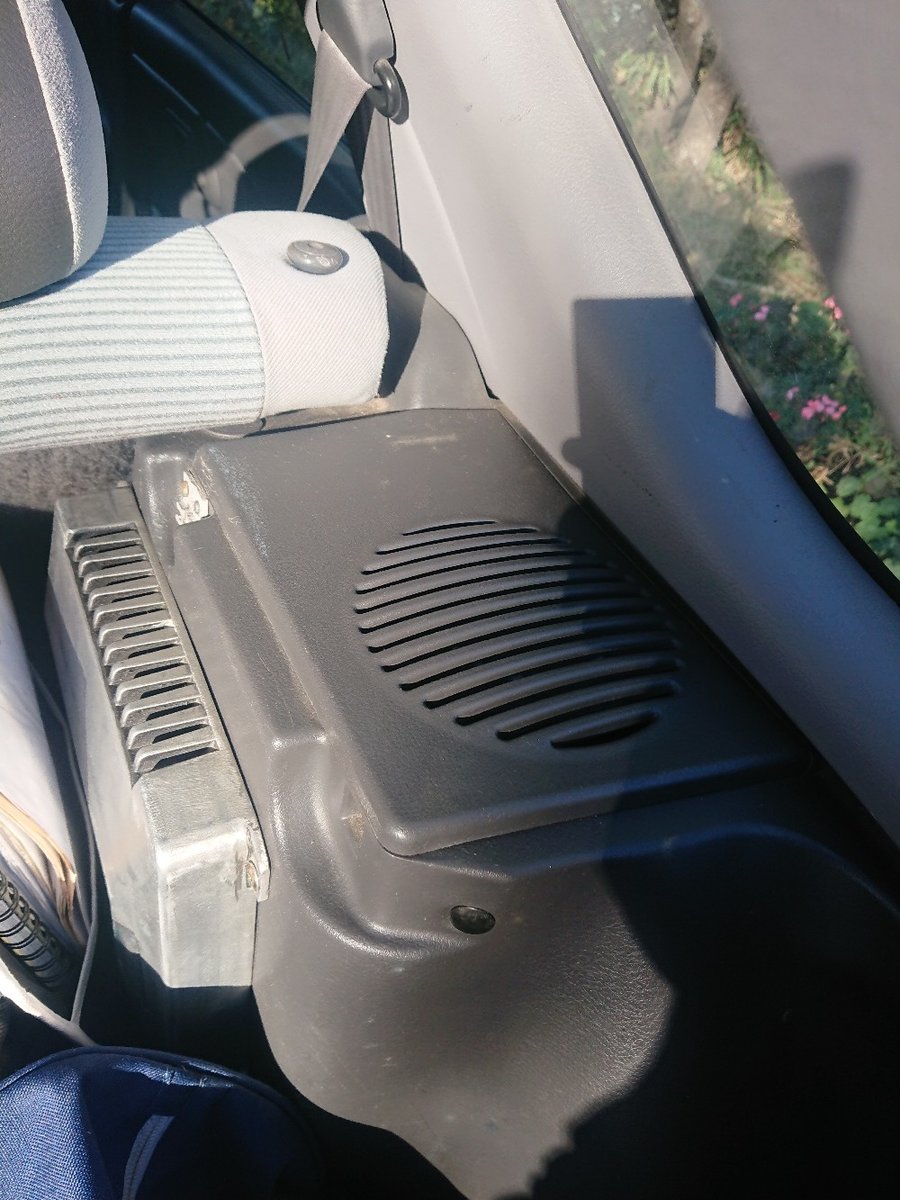

G'day, I have a 1994 Impreza wagon, base model I think (AUDM 1.8L ”sportswagon"), it has 6" speakers in the front as you would expect, but I'm at a loss to how the rears are fitted. The grilles are up on the strut towers, come off easy enough and there's the wiring for the rears and a cavity that would obviously fit a 6ish inch speaker but no mounting hardware. There are two bolt studs toward the back of the car and one toward the front lower in amongst that rubber insulation that don't match up with any speaker config I know of, looks like they mount a fascia plate of some kind. See attached pictures. Google proved useless even when searching for the original Legacy wagon rear setup that I've been told is the same. What do I have to do/find/make to get speakers in these things?? Cheers, Ash
