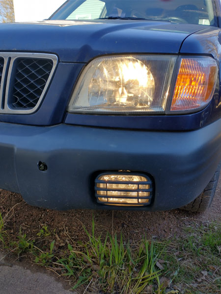

heartless replied to pz99's topic in 1990 to Present Legacy, Impreza, Outback, Forester, Baja, WRX&WrxSTI, SVXreplaced a damaged fog light.. original one had a nasty stone chip in it that allowed water in.. inside was flaking off pretty bad because of it. "local" junkyard (hr away) had one listed on car-part.com, so-so picture looked ok... was not off the car when I called, so the guy had no idea what it looked like.. got there and it was even worse than what I had. should never have even been listed (I envy all you guys with good pick & pull yards - no such thing here) back to car-part... called a place in PA that had 2 listed (with better pictures) After chatting with a guy there, and fresh pics sent, i got the light, with shipping, for $32.50 (just for reference, a NOS one is nearly $300, and the local yard wanted $25 for the pos one) and before anyone asks.. the "hole" has a stick about the diameter of a thumb stuck in it - have no idea how or why it got there - it was there when i got the car, lol. the bumper is otherwise in very good shape for a 19yr old car
