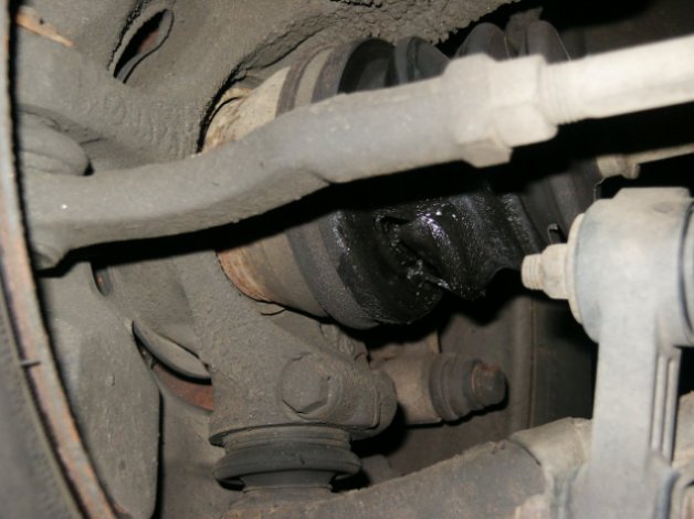

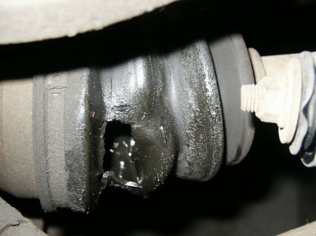

  3. I thought the knuckle part was the part on the Cv joint were the boot was.. To make sure I get this right.. 1. you losen the lug nuts on the wheel 2. take the wheel off then take the rotor off?? 3.pull the axel out of the hub then I guess you wack the inner axel a few times and it pops off? Sounds a bit too easy :eh: it's a bit too late to go outside now 1:40Am but I will inspect it more when it's day out.. And the tool you used.. What was it called?
  4. /me shudders... Ok I have a 1995 Impreza L that needs a new Cv joint.. How the heck to you take it out of the transmission? And better yet How do you disconnect it from the rotor? If it's not too big of a job I can do it myself im 18 btw and also the car has 129K miles on it.
  5. Now I know where the sound is from.. I heard the sound about 3 months ago.. It does not click each time you turn so it must be a new tear.. But I saw the crack.. my question is The Cv joints Are they easy to remove from the transmission/transaxel? I want to avoid the cost of a labor charge. The joints arent thats much money but having to pay $50 for service then $60 for labor is no fun. So I was wonder if anyone here has changed their and could give a little guide on how to remove it from the transmission and from the wheel area.. And my Car a 1995 Impreza L with 129K miles on it I guess I should get 2 new Cv joints?
