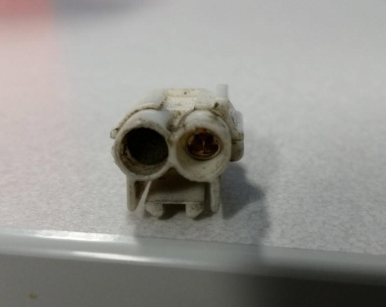

Hey all, I'm working on getting my 1987 XT turbo back in proper working condition. The car has the flapper style MAF but a spider manifold was retrofitted by a previous owner, so there are all kinds of wiring oddities I am still trying to sort out as I get it closer to running properly. It was pointed out to me that the knock sensor is currently disconnected; I looked for a pigtail to plug into it but couldn't find one. I did, however, find two broken wires coming out of the harness that crosses over the block...I checked my spare EA82T manifold as well as my ER27 and it looked like the knock sensor plug was a single-wire setup. So, does anyone know what those two wires might be for, and if they are not the knock sensor plug I am looking for, where would I find it on the harness? I haven't been able to find anything. Pics below for clarification. and the plug that appears correct on my spare manifold...
