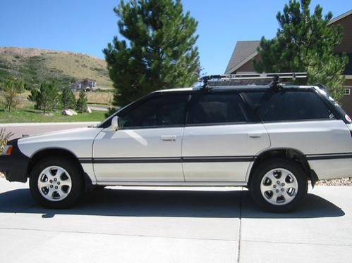

September 22, 200916 yr Here's my lifted lego wagon. It's a 1995 2.2 4eat, lifted on 04 XT takeoffs, Homemade teflon strut spacers in the rear, and 215/70/15 dunlop graspics on forrester steelies.
September 23, 200916 yr Nice I lifted my 91 with 98 outback struts, now I am higher than any stock roo! Edited September 25, 200916 yr by rweddy
September 24, 200916 yr congrats.. it sure looks good.... i like the "woofer" in the rear hahhahhaha btw where in the east coast are u?
September 24, 200916 yr Author congrats.. it sure looks good.... i like the "woofer" in the rear hahhahhaha btw where in the east coast are u? Thanks, I am really happy with the look/ stance.........and the dog loves it! I live in Halifax, Nova Scotia, Canada.

September 24, 200916 yr Thanks, I am really happy with the look/ stance.........and the dog loves it!I live in Halifax, Nova Scotia, Canada. Hey, it does look good. Lucky dog! BTW, put your location in your ID info--helps people "place" you when you post in the future.
