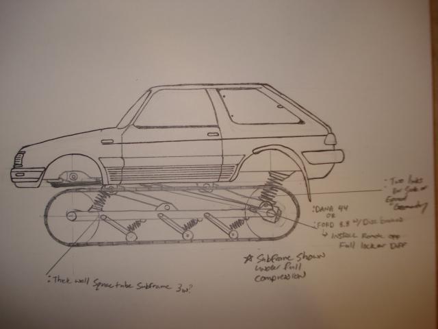

While sitting around dreaming about cars passed, i stumbled upon this idea. Based on a 2nd gen hatch, and using parts that i have already on hand, minus the car of course. Possible?

Yeah i looked at that, they are quite awsome. And Pricey!, this option is something that i think i can pull off if i get the right car to start with, i think i might have the reset of the Bits hanging around, and what i dont i have i can make at the machine shop.

how do you turn...?:-\
Skid steer - but not with a Subaru drivetrain obviously. You need a bobcat tranny or something.
As for mattracks - they are great for sand and snow, etc. They are not as good in mud and deep stuff - and the grit eats them to peices. They are useless for rock crawling.

Both those soobs, the hatch and Blocks STi had MATTRACKS on them... Your design is something completly different :)

I actually contacted them about using the ATV trax on a Sube and they said it would just be to much for them to handle.
I've seen video's of an EA81 hatch with them. Seemed to be doing just fine. Don't know if they would last, but it was working.
A stripped down hatch is around 1800 lbs or less. They are saying these things can't handle 400 to 600 lbs each? They made in China?

I agree, there are tons of fun things to do with a subie, this just seems like a worthy challenge, as for the turning, i would use a 8.8 ford rearend, equipped with Disc Brakes "12in rotors" install an ARB electric, or Manual locker to keep the tracks in Sync when going strait. Than to turn i would unlock the Diff and use a "Turning Brake" setup similar to a sand rail. Anyone who has ever run a Cat would know it more like using decelerator pedals. Setup would involve tieing the diff lock into the turning brakes so that the opperation was seamless. The tracks would simply be the ones of a BobCat, even utilizing the wheels and hard rubber tires. Since the ones i have a bolt together treads, you can prety much make them as long as you need.

I don't see why the track for the small pickups and SUV's would not work (Mattracks) the ATV ones would be too weak IMO. If a guy were to spend the money, why not spend it once and get tracks that are for a bigger vehicle and not a smaller one. They would just last much longer. ;)

I've had a similar inspiration to turn a Brat into a snow cat by putting a pair of snowmobile tracks under the bed. There seems to be plenty of room under there, especially if the fuel tank is relocated to the bed. It seems like you could just remove the rear drive shaft or shorten it to a few inches to drive the tracks through the stock rear end, then fab up some skis for the front.
