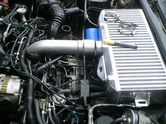

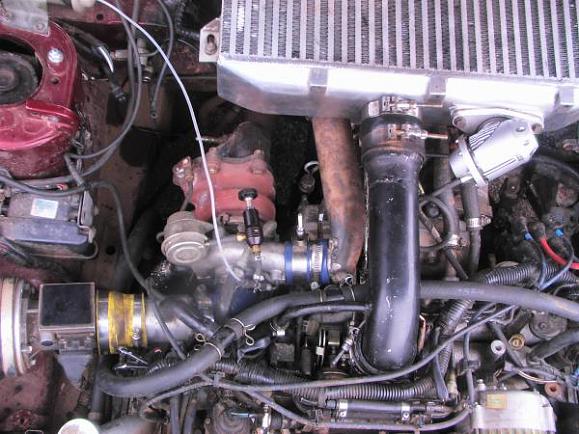

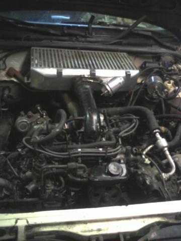

[ATTACH]8198[/ATTACH]
that sweet how did you mount the tmic? good write up on here?
-Nomad
-Nomad

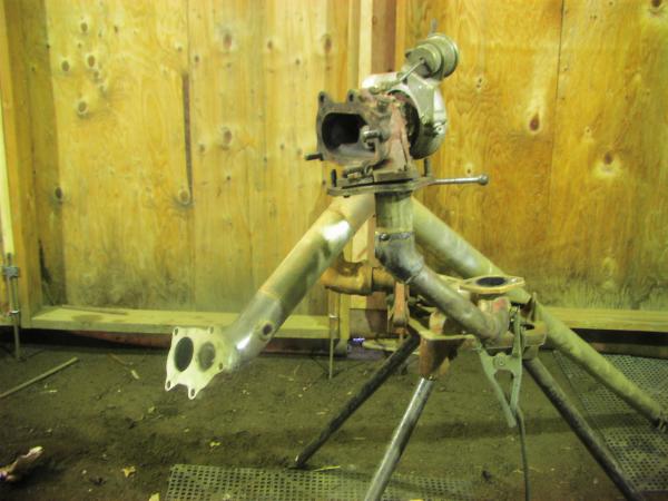

welder time mandrel bent pipe and more time but here are some pix of the build
