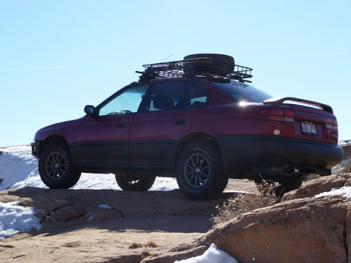

95 legacy with:
**EDIT** 99 OB 5MT and rear diff swap, awesomeness of 4.11s!!!! **EDIT**
KYB GR2 struts spec'd for 99 OB,
99 FOR rear springs
94 SVX front springs with 99 FOR front upper spring perches,
99 OB rear control arm brackets,
99 OB rear sway bar,
customized , mudrat baja bumper,
proline 14" rims (offset is less than Suby's 55)
27x 8.5 14" General Grabber AT2 tires.
custom 2-tone paint scheme
