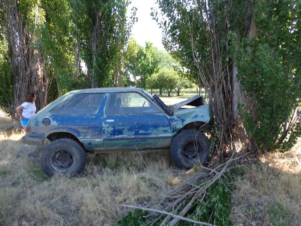

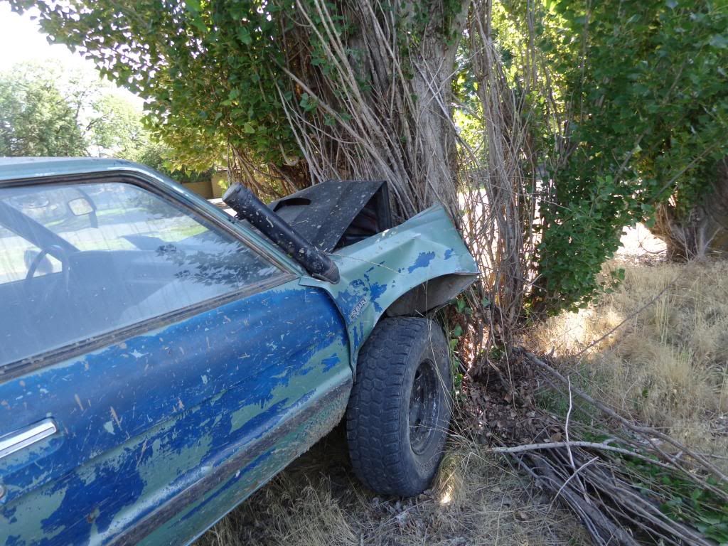

I'm not entirely sure how it happened but the impact even went through the 2x3x.1875 steel that was tieing all the blocks together and crushed the front-most rear lift block(leading edge of the rear suspension lift block).

That gap above the window is big enough to put my hand through all the way to my wrist.
As much as I am for saving our loved ones, that one will be hard as you would pretty much have to lop it in half if you want it bad enough. I am also very fond of hatches due to their twin relation of the Brat. If I may..... WTF happened!? lol

I was towing my car home on a trailer coming from the big mid summer offroad meet in evans creek.I stopped at the turn off for Wa261 and tightened everything.Then drove home,Wa261 is a curving bumpy road with hills thrown in for good measure.My trailer isn't exactly rigid,in fact its very flexible.I'm guessing that over the course of the 10 miles of wa261 before it fell off the trailer the straps holding the car down came loose.I got down to the bottom of a hill and I felt a jerk and I looked in the rear view mirror just in time to see my beloved hatch leaving the truck and trailer.I kept going about an 1/8 of a mile then turned around to find it at the bottom of a shallow ditch with it crashed into a tree about as wide as the car.It hit that tree at ~50 mph.The ground leading up to it was a little rough and they might have slowed down a stock car but with the bigger tires it just rolled over all the bumps without really slowing down.
