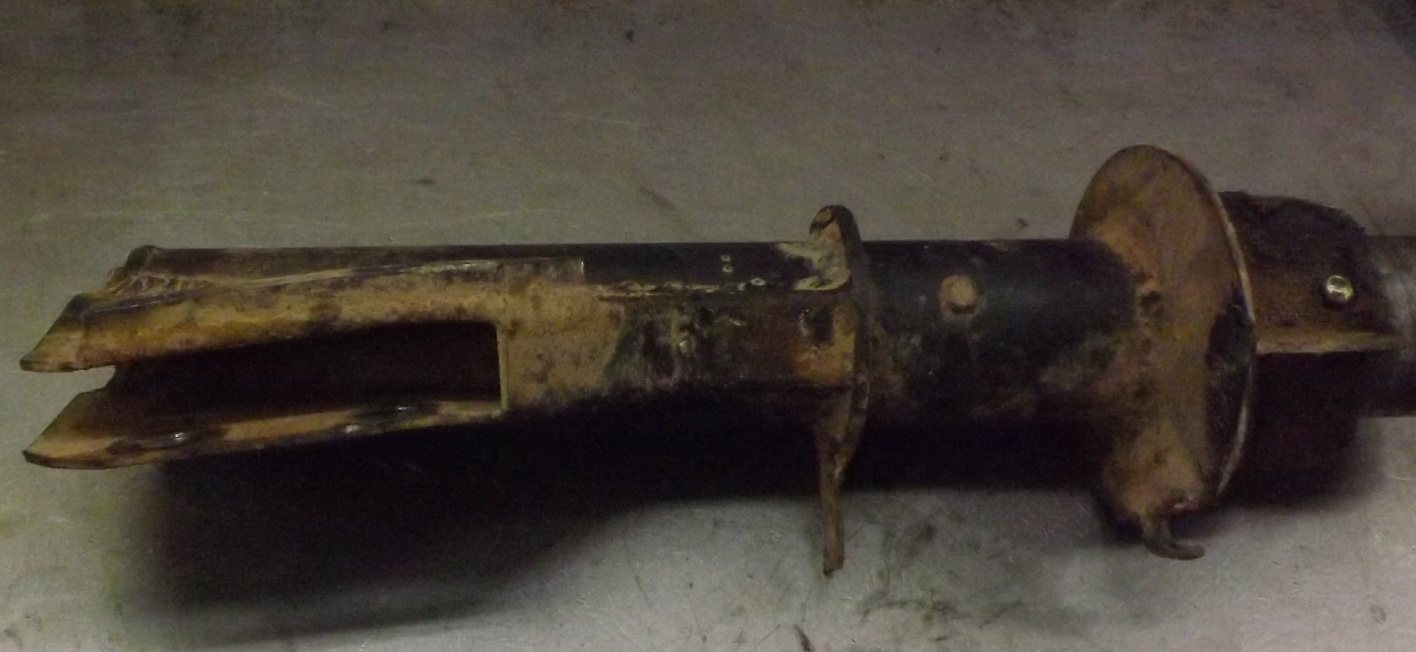

This is the strut with the bad hose that was bottoming out.  The other rear strut is slightly bent but not as bad.

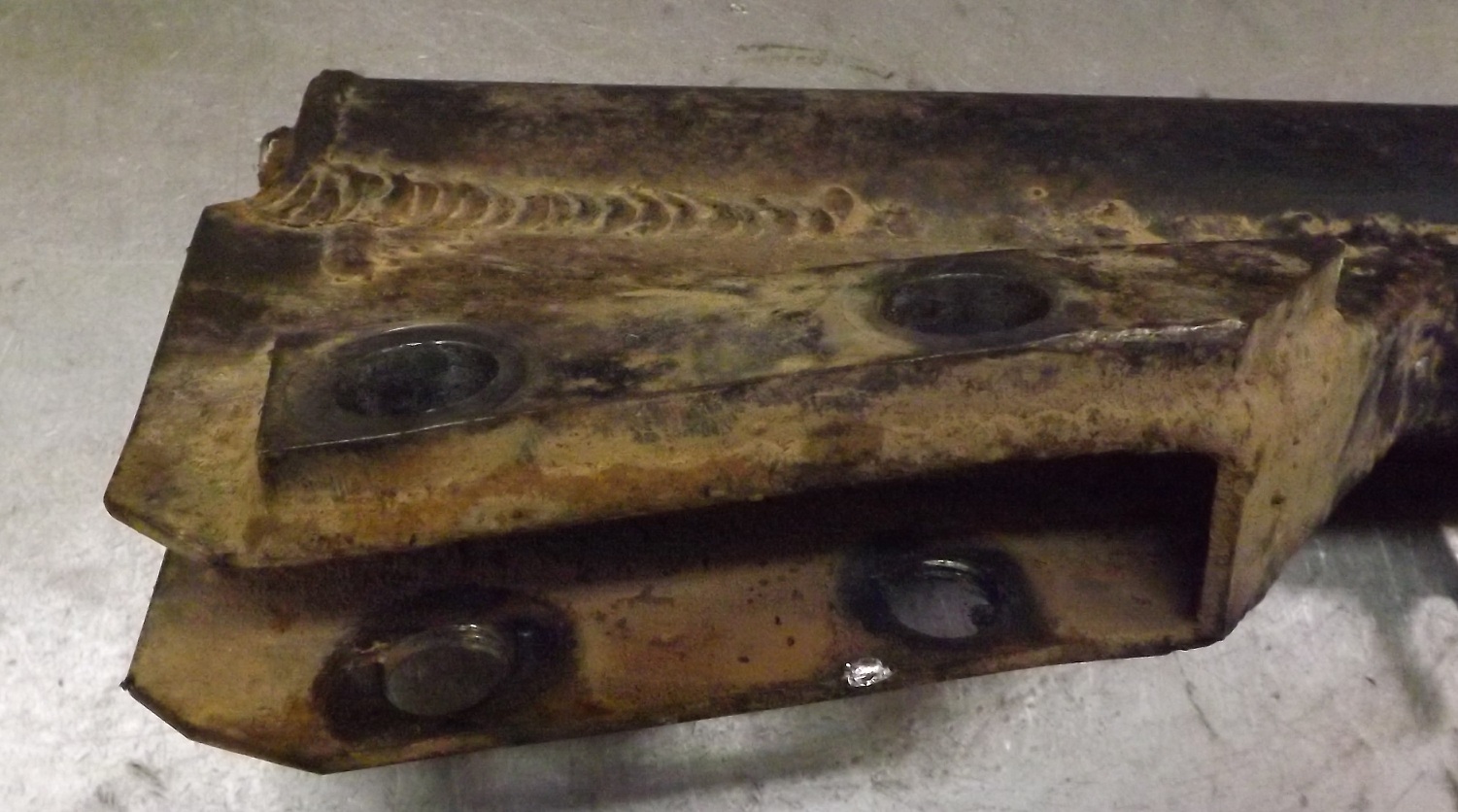

In this picture you can see the weld was starting to crack too:
I am going to shorten up the mounting tabs like I did on the front struts.  There is room between the strut and the sidewall now that the spring is above the tire.  It also helps that these need a little more positive camber which will give us a little tire/strut clearance.  I'll also gusset the bottom of the tabs.  Trying to find different springs so I can move the spring perch up while I've got it all cut up.  Anyone know of a company that makes inexpensive custom coil springs?

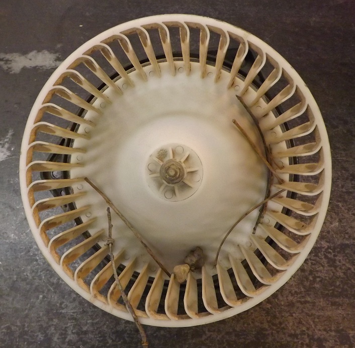

We got the HVAC fan out of the Outback since it was making noise occasionally after the race, especially when turned all the way up.  There were some sticks and rocks in it:
Couldn't get any pictures but the plastic box the fan blows into that holds the evaporator had an inch or two of dirt and debris in the bottom.  The evaporator was partially covered with about 1/4" of mud too, so we cleaned it out as best we could.  Should improve AC performance.
