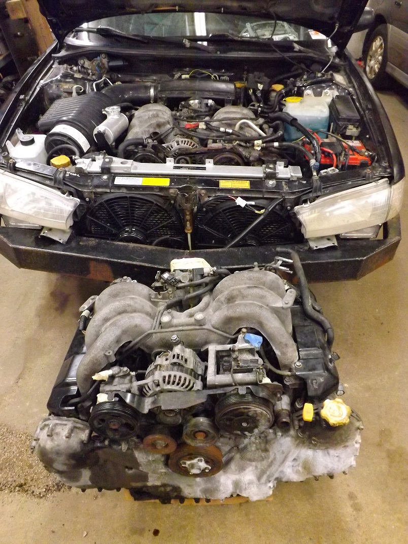

Low mileage H6 in, bad H6 out.

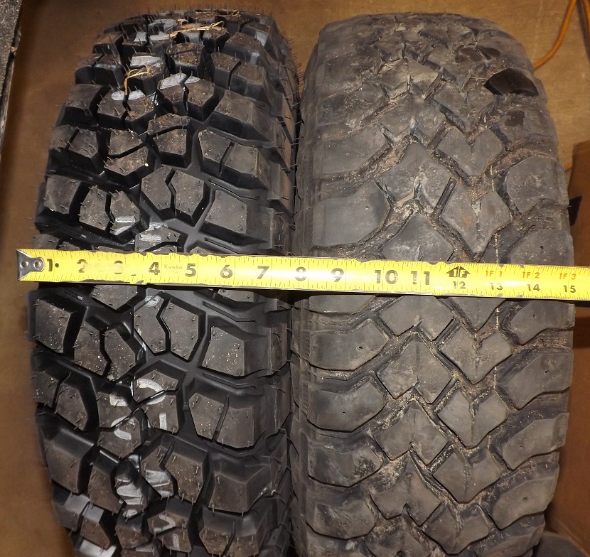

Got a set of BFG Mud Terrains to try.  Only have two Hankooks with decent tread left on them.  Going to run BFGs on one side and Hankooks on the other and see if one side gets more flats than the other.  They seem to be the same diameter and tread depth (new), but the Hankooks are about an inch wider.  Both 215 75 15.

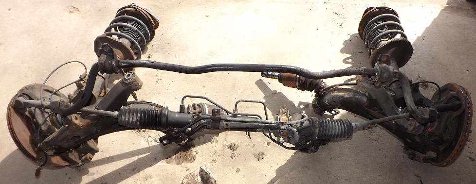

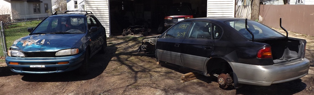

Took the front suspension, steering, and axles out of the parts car before they picked it up.  Figured this was the easiest way, I really just want the axles and aluminum control arm bushings, but some of the other stuff might come in handy.
What was left of the sedan, my Impreza, 99 Outback, and the front suspension in the background.  I did keep one shock/spring from the rear of the sedan.  Seems like 10" of travel will be pretty easy, probably can get a few more inches of droop than that too.  And it will be much cheaper and easier than building struts.

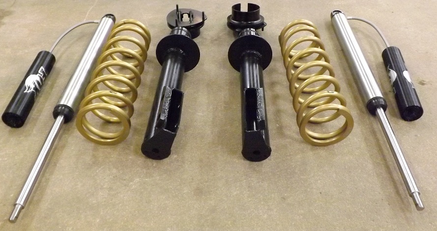

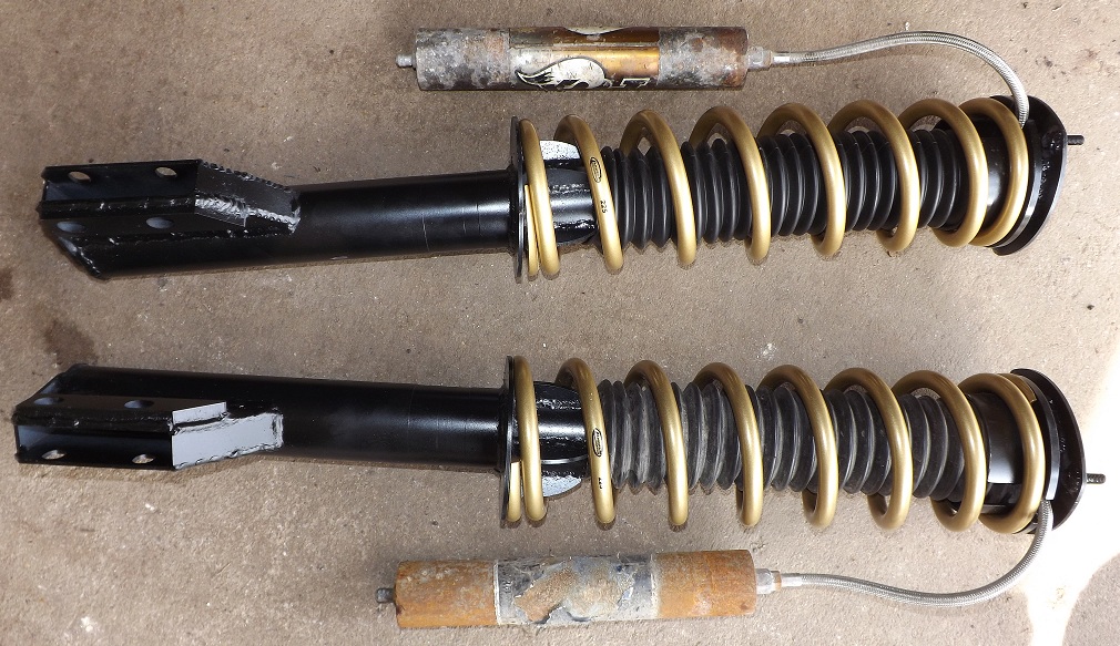

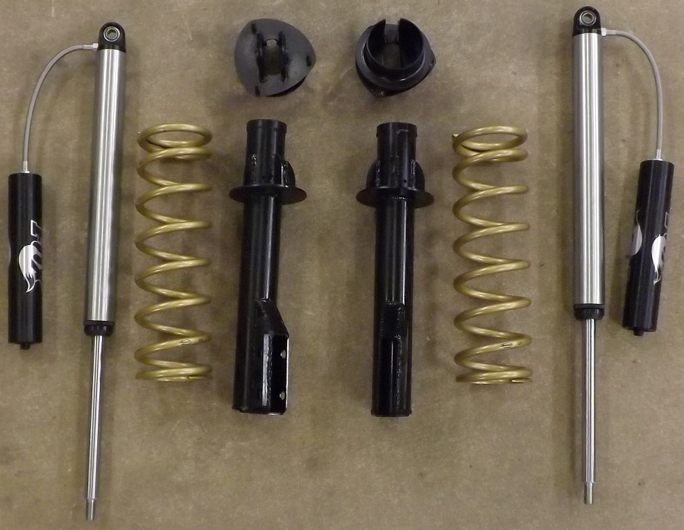

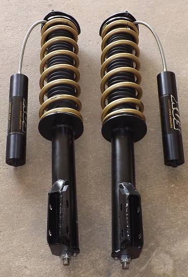

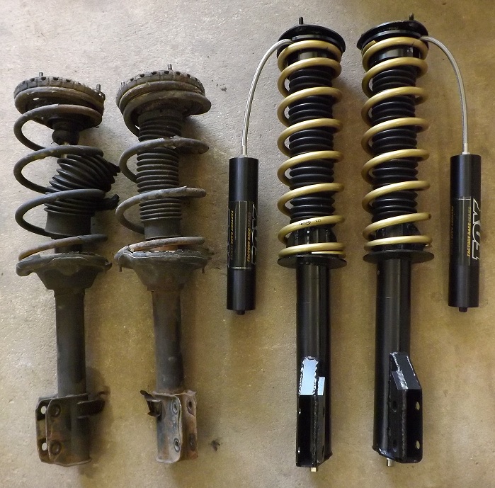

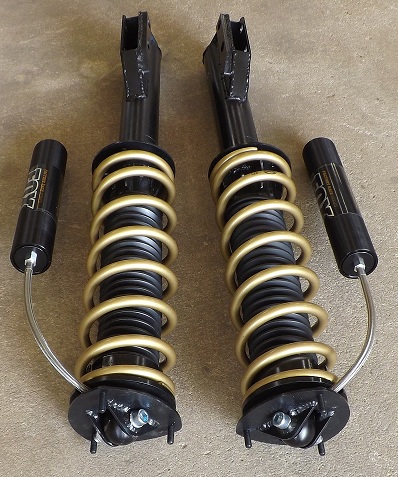

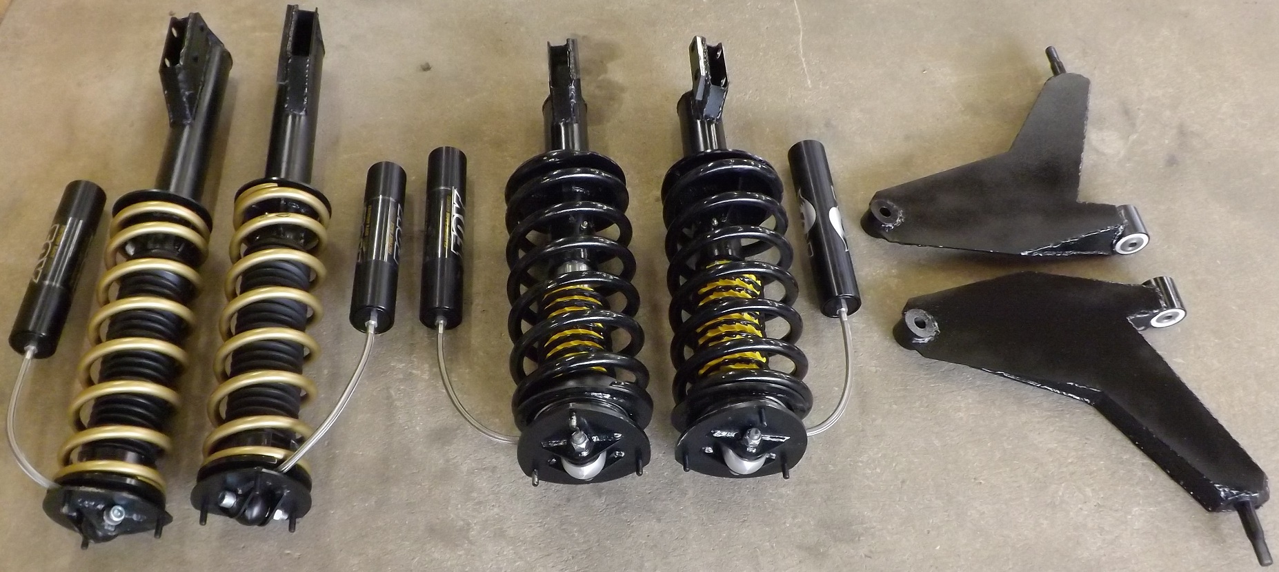

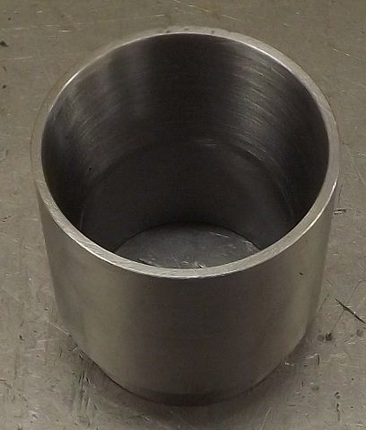

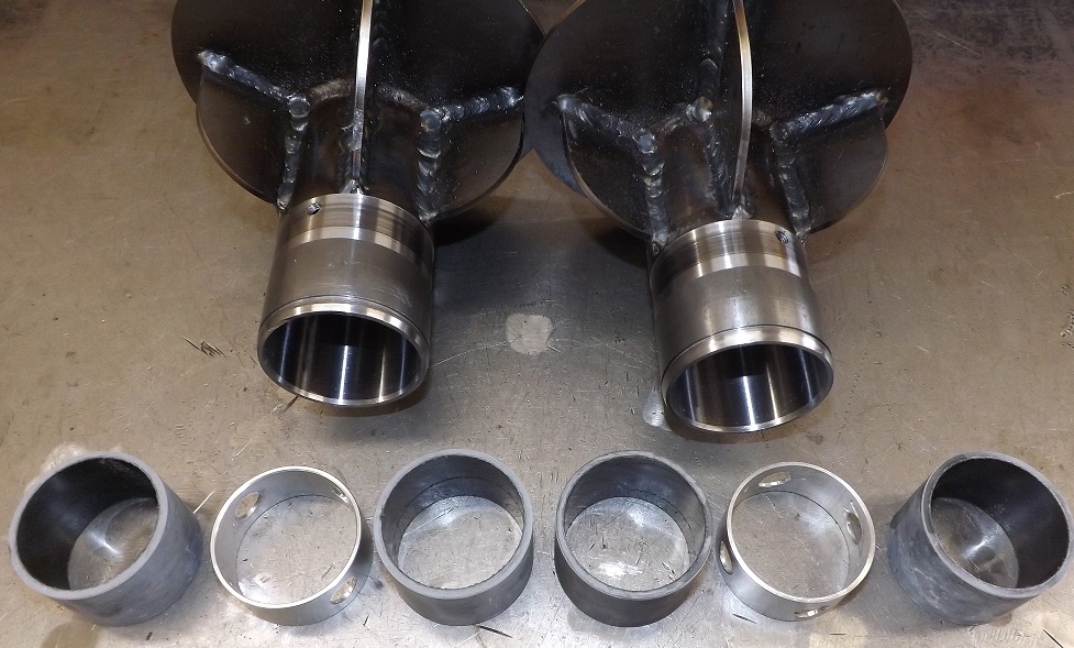

One of the biggest improvements I wanted to make to the struts was to ID grind the housings for the bushings.  The last few times there has been a lot of hand sanding to get the shocks to slide into the bushings, the bushings would slide out of place, etc.  Now I just press the bushings in to the step with a spacer in between and the shock slides in, shaft goes out the hole in the bottom, much easier.  Assembled on the left, parts and ID ground housing on the right.

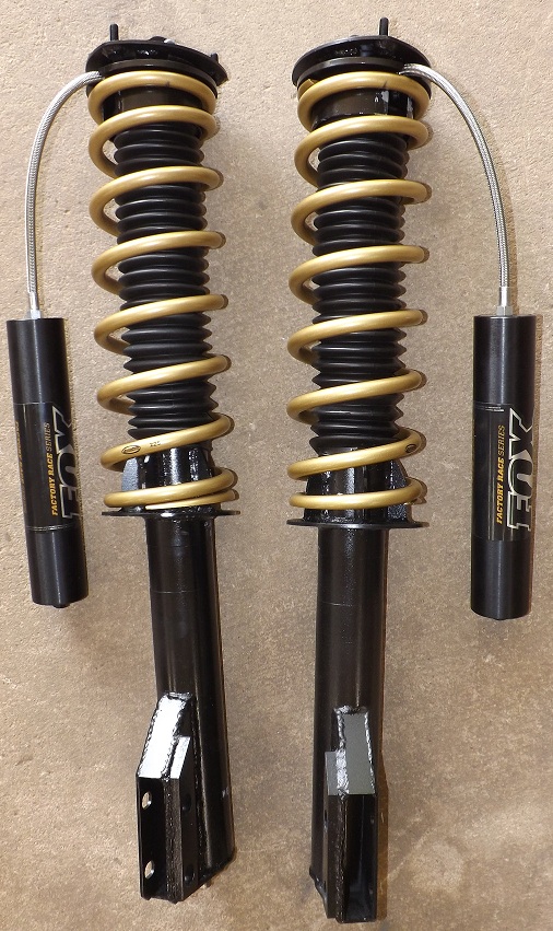

Rear struts fully assembled.  Put them in and the new springs make the car sit about 3" higher than before.  So now it sits above the middle of the travel rather than below.  Drove it around a bit, the ride seems about the same as before.  Another plus is you can buy these rear springs in 25#/in increments.

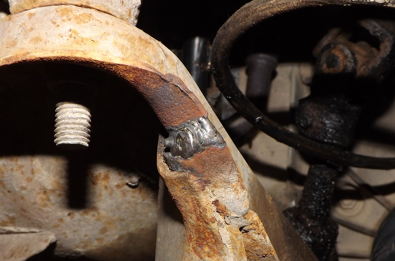

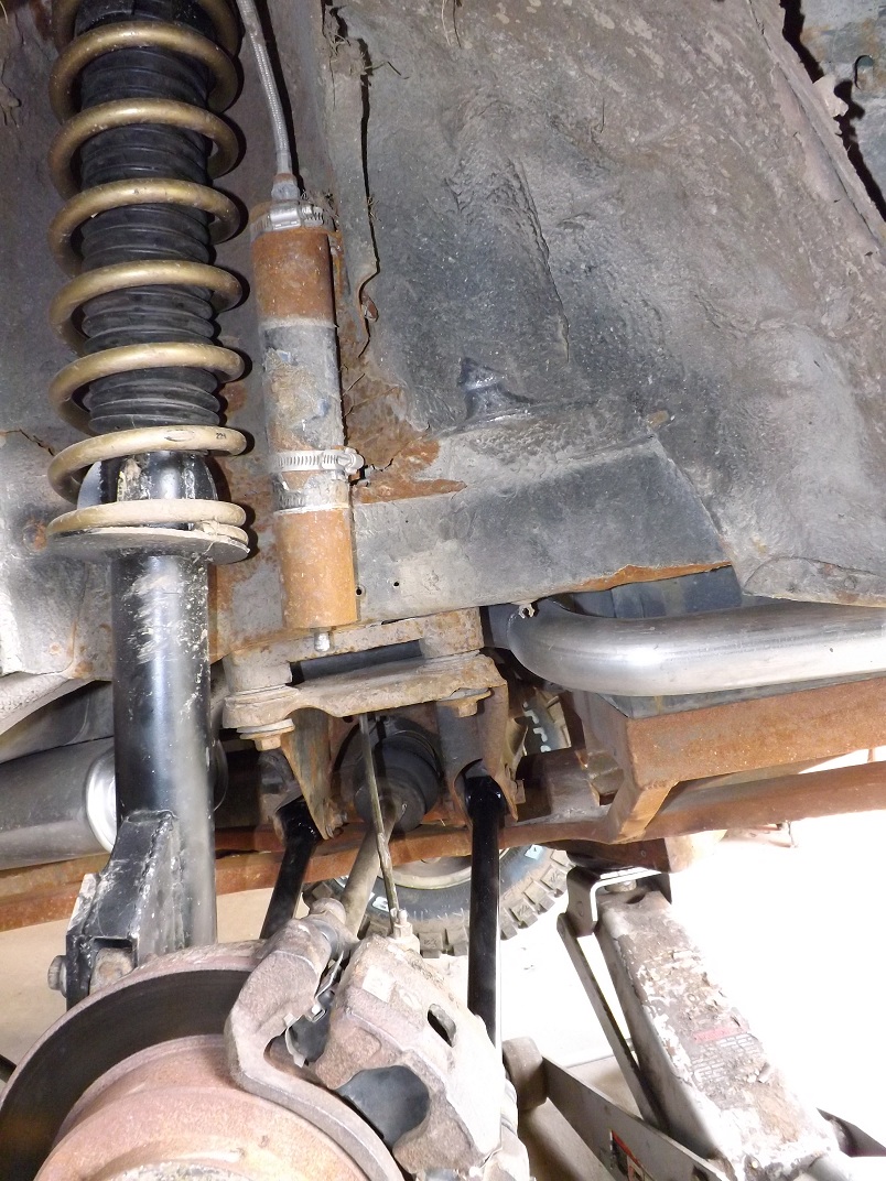

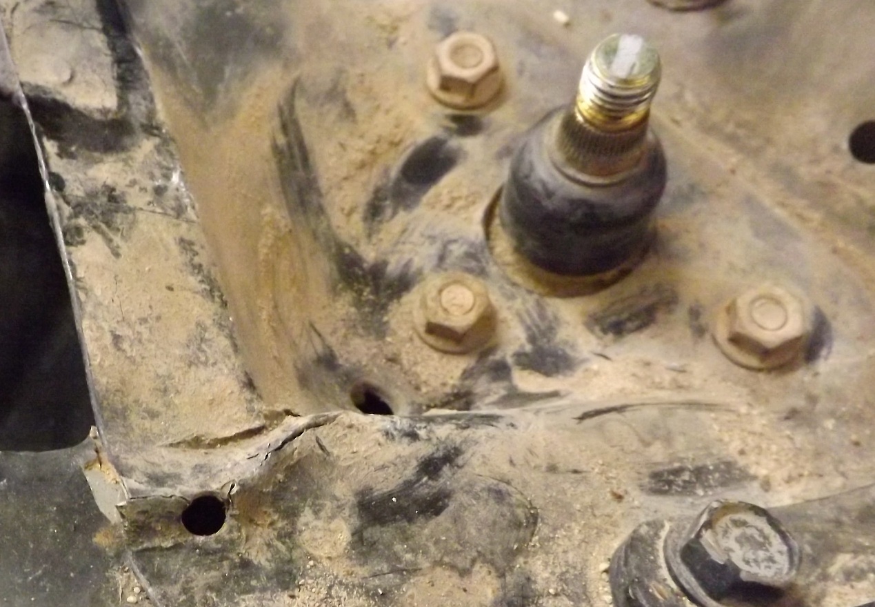

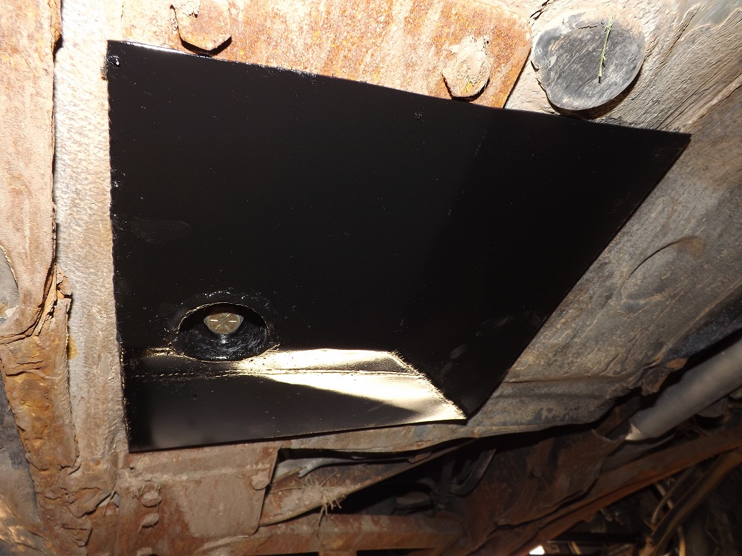

Noticed a crack in the front subframe when I was putting the new struts on.  No idea how long that's been there.

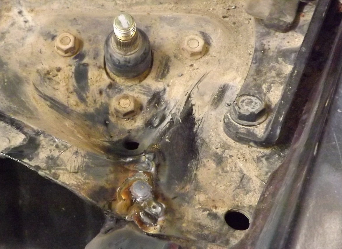

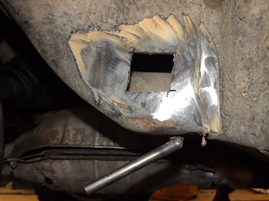

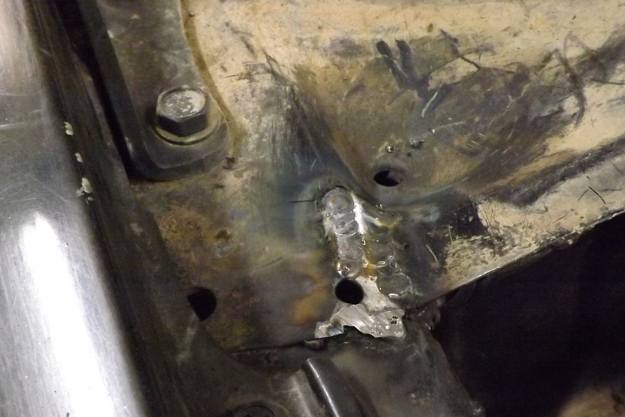

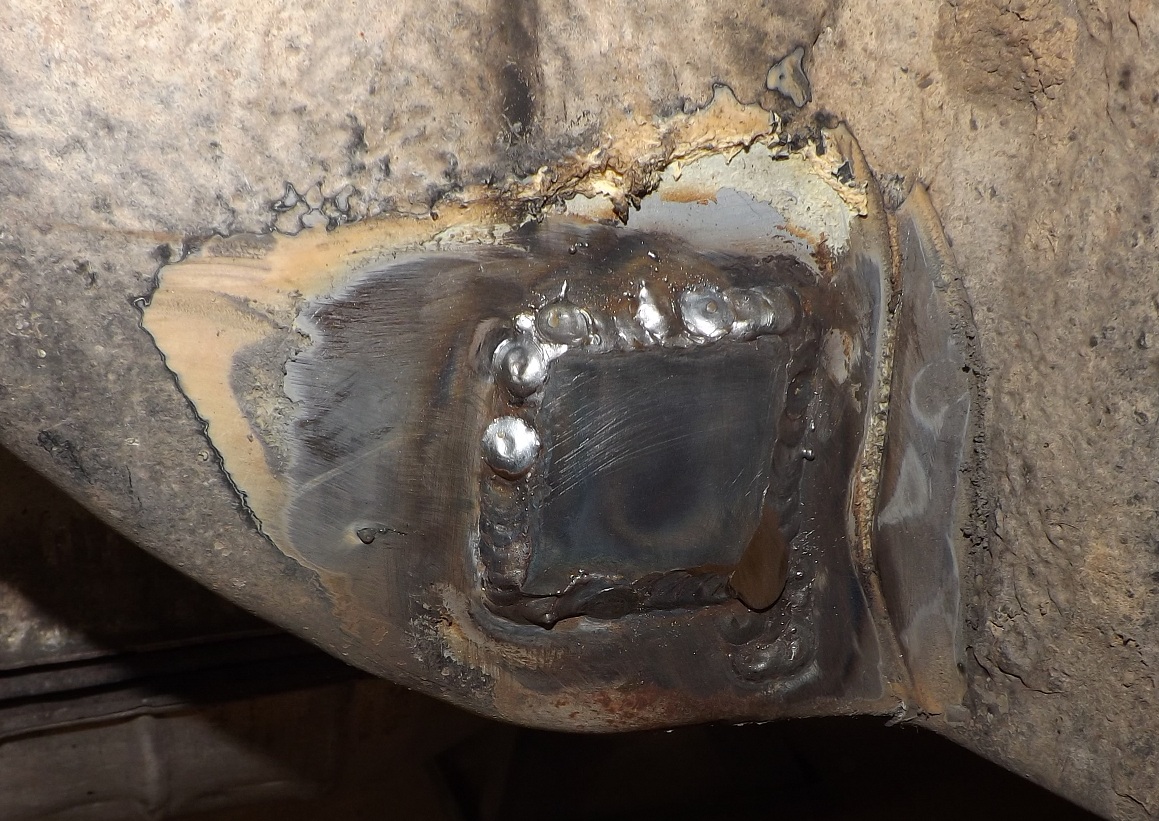

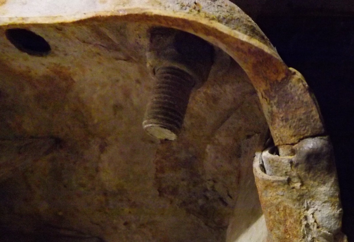

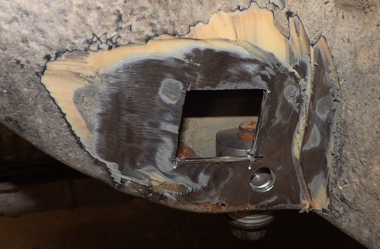

Threaded insert for the RF control arm bolt came loose in the body.  I had threaded it out far enough to be able to cut it off and get the arm out of the way.  Welded this bar on the end of the bolt but couldn't thread it out.  Cut a hole in the body to fish it out.
Sort of held down by little welds but I think mainly the rectangular shape is what was keeping it from turning.

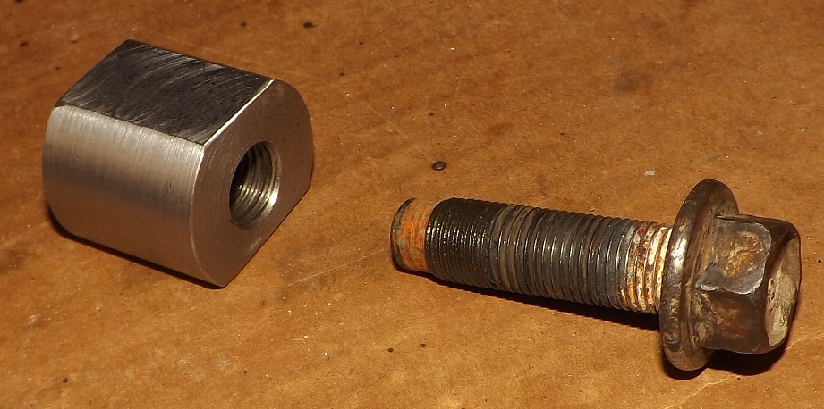

Made a new insert.  One problem I've seen is that a lot of the bolts thread past whatever threaded insert and that extra exposed part of the bolt threads is what gets really rusty and doesn't want to come back through.  So for that reason and for better welding, made my insert about the length of the bolt threads.
Here's the insert in place, drilled a 1/2" hole to plug weld it too.

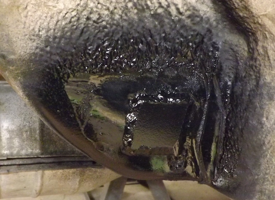

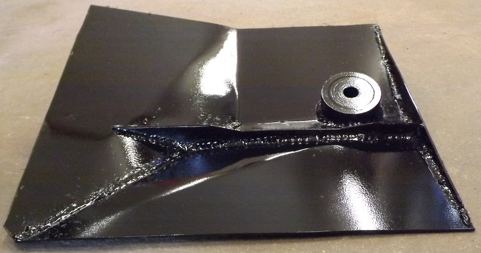

Since this part of the body was doubled up and obviously fairly structural, I welded the two sheets together as best I could and then welded this 1/8" patch over the top of that.
Paint dried to that fast, didn't have to worry about runs.

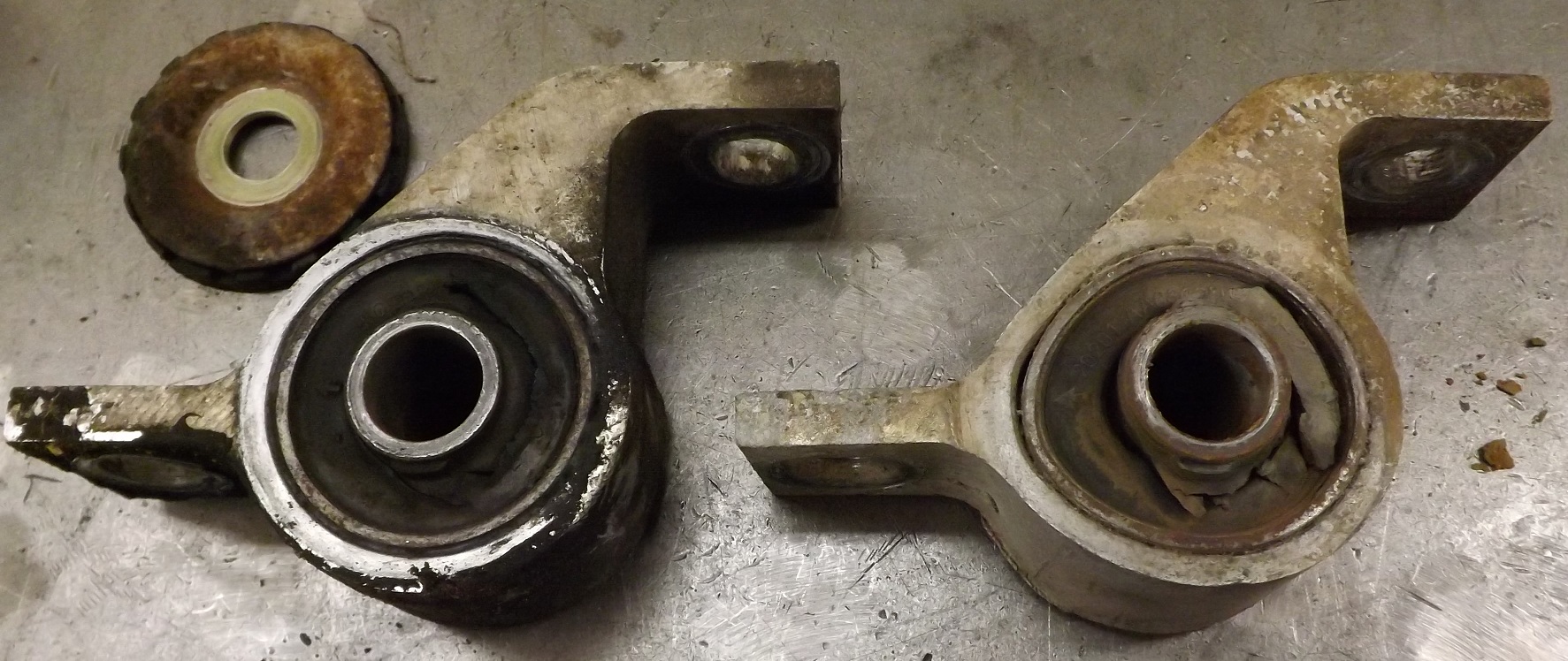

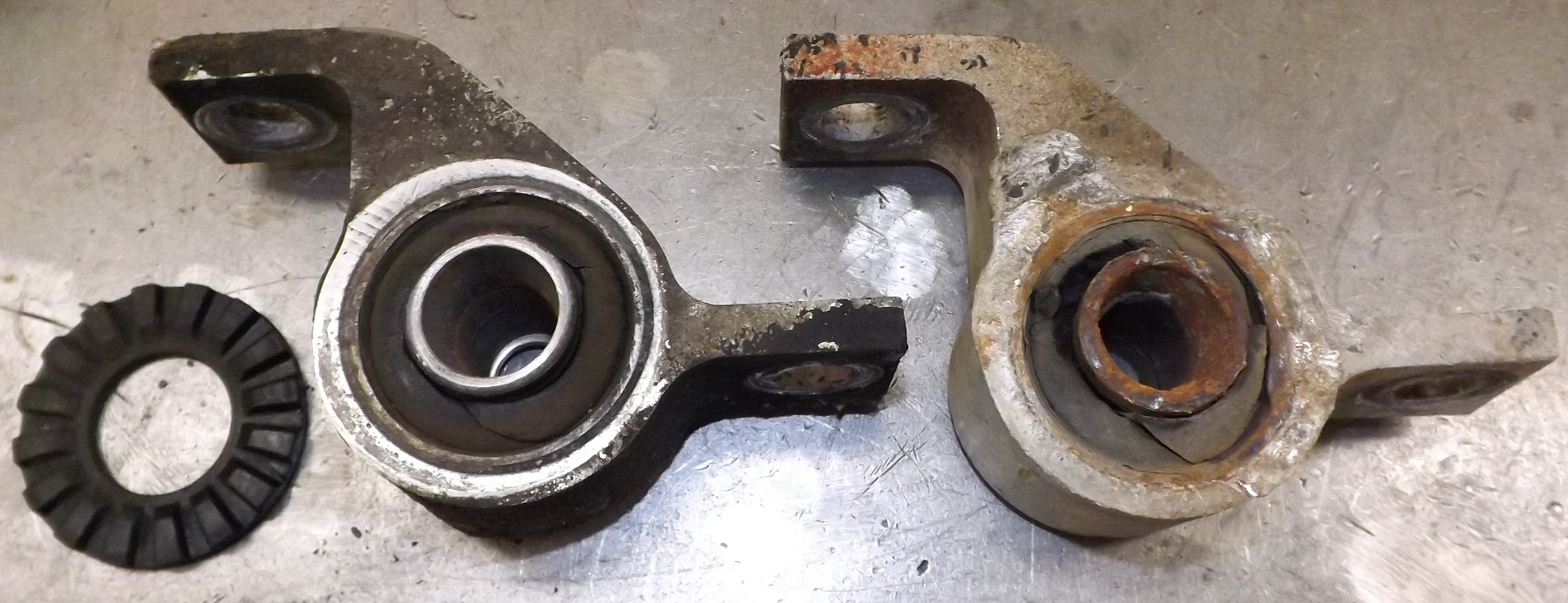

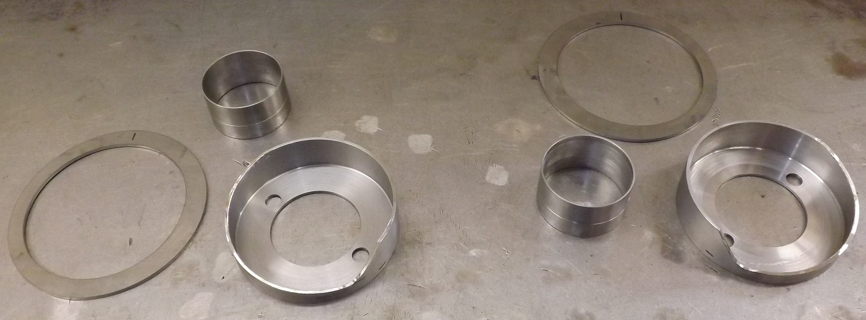

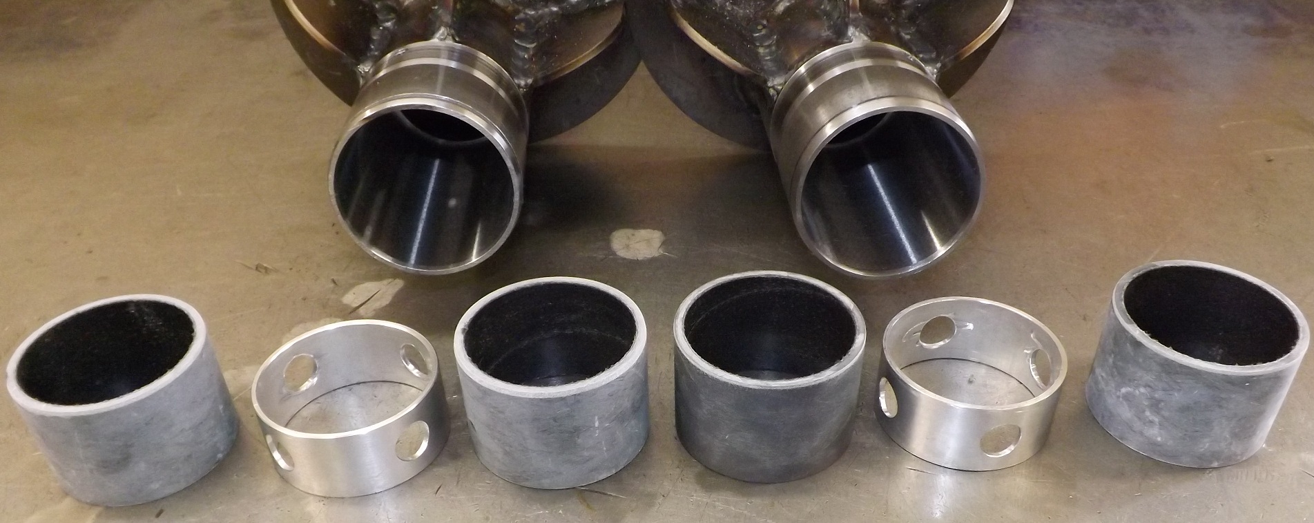

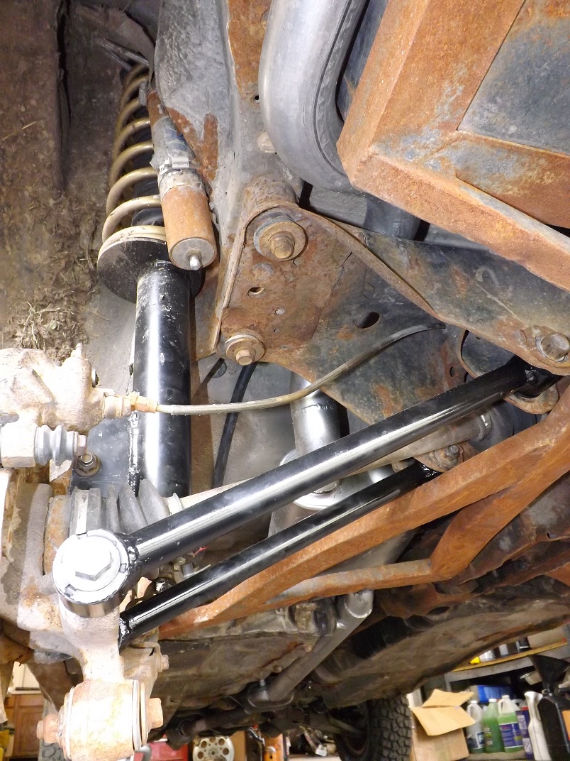

Another thing I wanted to do was replace the aluminum control arm bushings.  Old one is on the right, as you can see it's pretty beat.  It's been on the car a few years.  I need to at least get new rubber bushings from the dealer sometime to press in and see how long they last.  This aluminum bracket was bent towards the rear of the car, so I pressed the bushing in the "new" one towards the rear of the car to get it bolted in.  The front crossmember is bent back a bit I'm pretty sure.  Passenger side wasn't as bad, bracket wasn't bent at least.
One thing we did different with these front struts is to use modified eccentric bolts all around.  Basically shorten the eccentric part to about 1/2" to fit the thick plates on the strut tabs.  Then all of the holes in the spindles are 14mm after we sleeve the top holes in the front spindles.  All the bolts are the same and adjustment is more obvious.  But the main advantage is that with the stock bolts you are just relying on a 14mm thread pushing against a fairly thin mounting tab, that always seemed to get worn out.  I think the RF CV axle had been making noise so I replaced that while the suspension was apart.
Front bushings and spacers.  I drilled and tapped these for grease fittings.  Should have done the same in the rear.

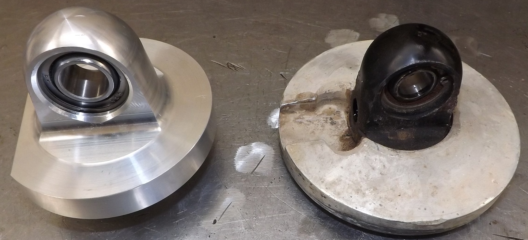

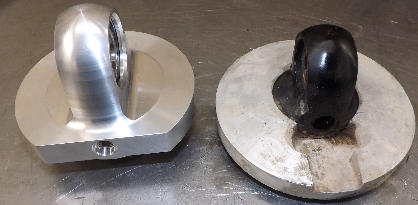

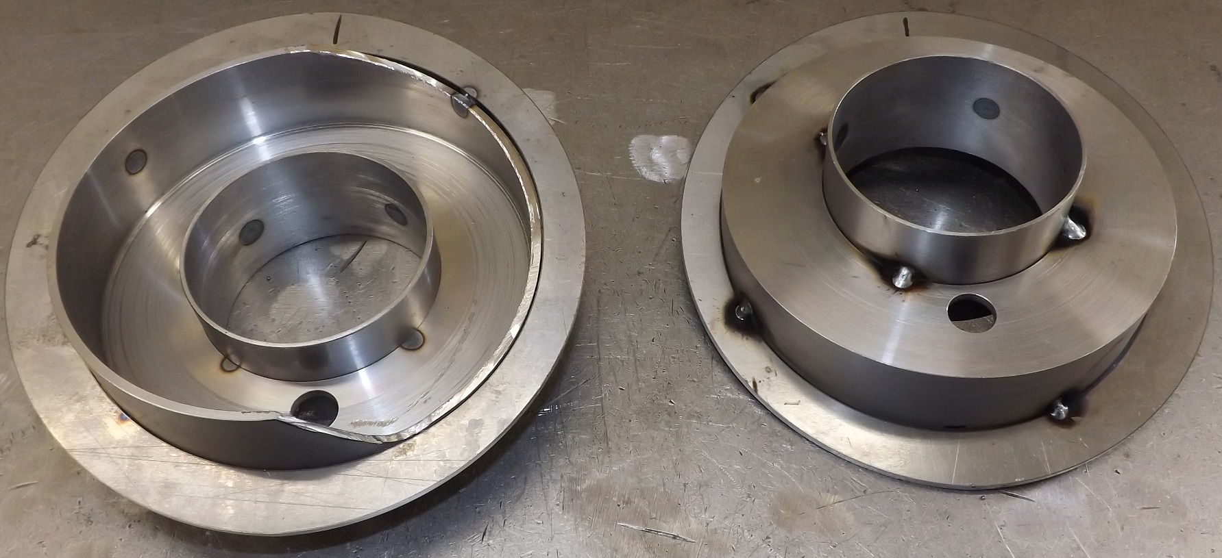

New front shock tops on the left, old on the right.  The new ones have a larger ball joint (3/4" ID vs 5/8" ID) and locate on the ID of the steering bearing rather than the OD like the old ones.  I'm still surprised the old ones held, there wasn't much of a ledge holding that bearing mount from sliding up.
Put the front struts on the car and drove around a bit last night.  Can't really tell the springs are 50% stiffer than before, rides about the same.  Sits two or three inches higher in front than before also, so both ends are a little above the middle of the travel at ride height.  Rear sits about 1" higher than in front.  With that and the lower profile skid it definitely has more ground clearance than last year.  I don't think it's really much higher than it was way back with the 1.5" strut spacers and no cage, fuel cell, and six cylinder.  I think all the added weight and sagging of the springs was getting it to be a lowrider.  Anxious to see how the added power and ride height will do offroad.
Nice custom built struts !
What rate are the springs and how much travel/stroke do you theoricaly get ? Did you fit any seals ?
Thanks.  They're very similar to what we had.  About 11" shock travel rear, 12" wheel travel.  About 10" shock travel front, 11" wheel travel.  Measured without bumpstops.  Yes, wiper seals above the bushings.  Shocks are completely sealed.
Springs are all about 225 pounds per inch now.
It will be perfect for rallying !
Have you tried to lubricate the bushings (PTFE) with fork oil ? Made a huge difference for my application.
We just use Fox shock oil in the shocks.  Grease on the bushings, they only have wiper seals on the top so oil would just run out.  Seems to work well.
Did you drill any hole in the housing ?
I did that on the Proflex inverted coilovers with a hose and a fuel filter that I later replaced with a bladder (soft container) so there wasn't too much over/under pressure in the housings.
We have a couple little breather filters on the bottom of the strut housings.  I like your bladder idea, seems fairly simple and should keep the system sealed.

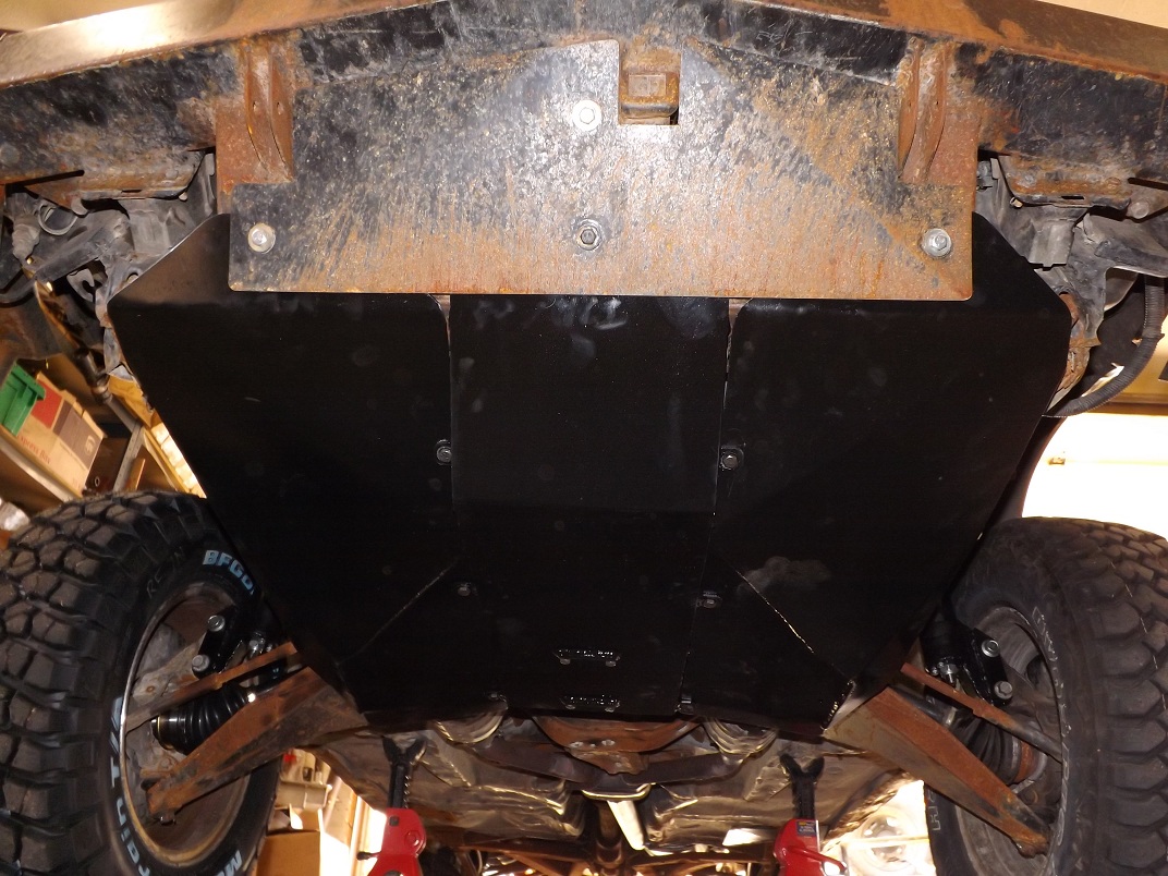

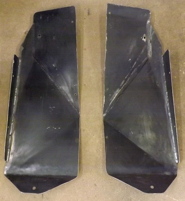

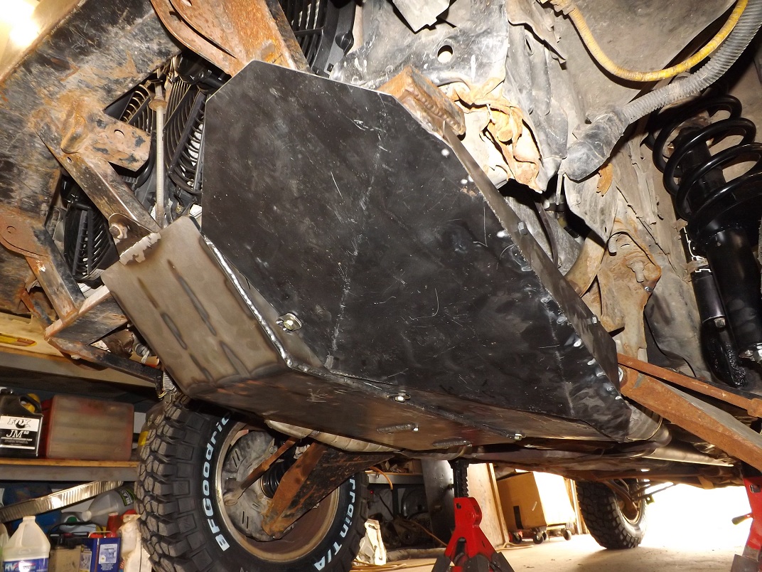

Reused the skidplate we made last year to build sides for the new skidplate.  Basically had to do some trimming and welded some vertical pieces to the sides.
Here are the new sides welded and trimmed.
Here is everything bolted on.  A bit of a hassle to put it all on but it definitely protects a lot of important things.

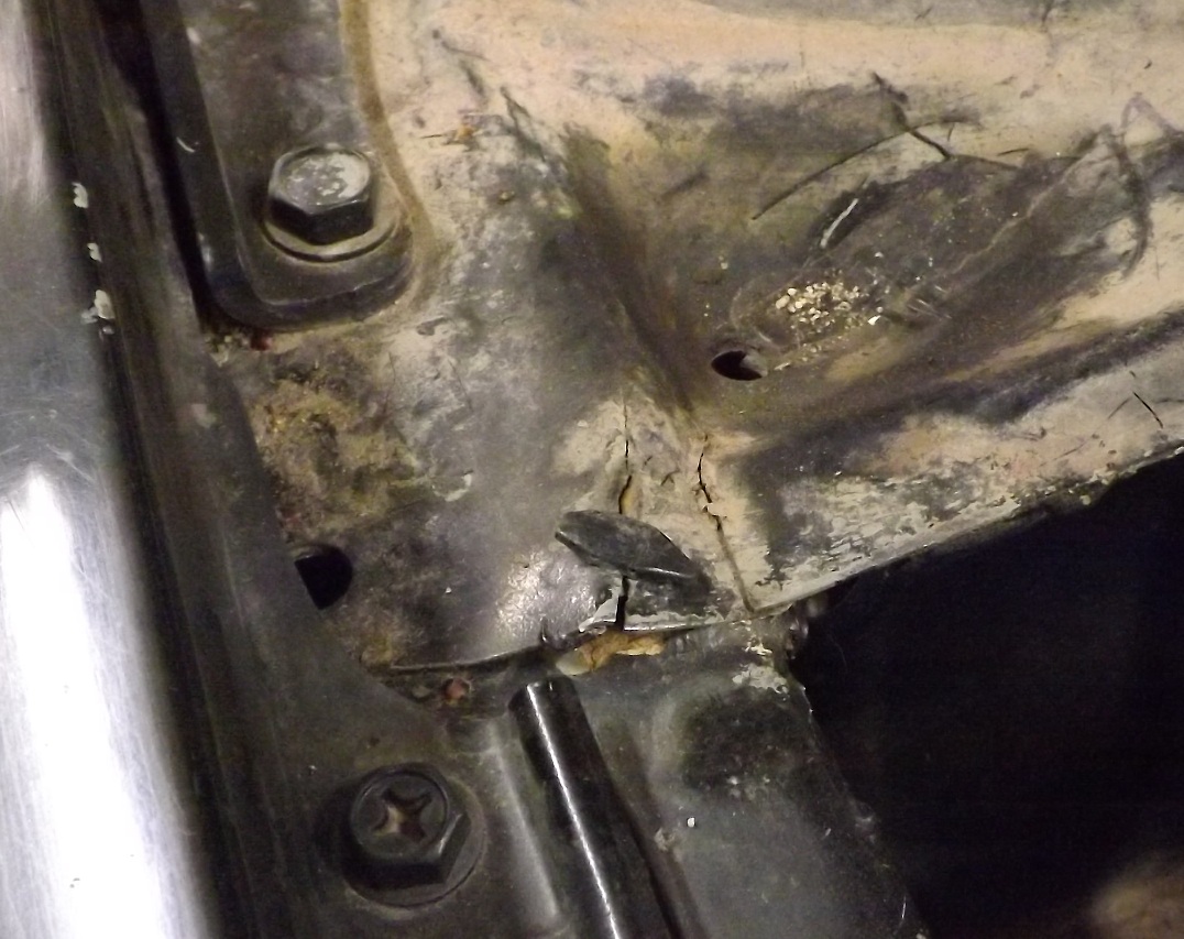

I noticed a couple more little cracks in the body where the fenders meet the windshield on both sides.
Welded them as best I could.

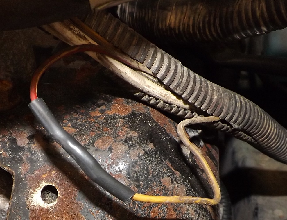

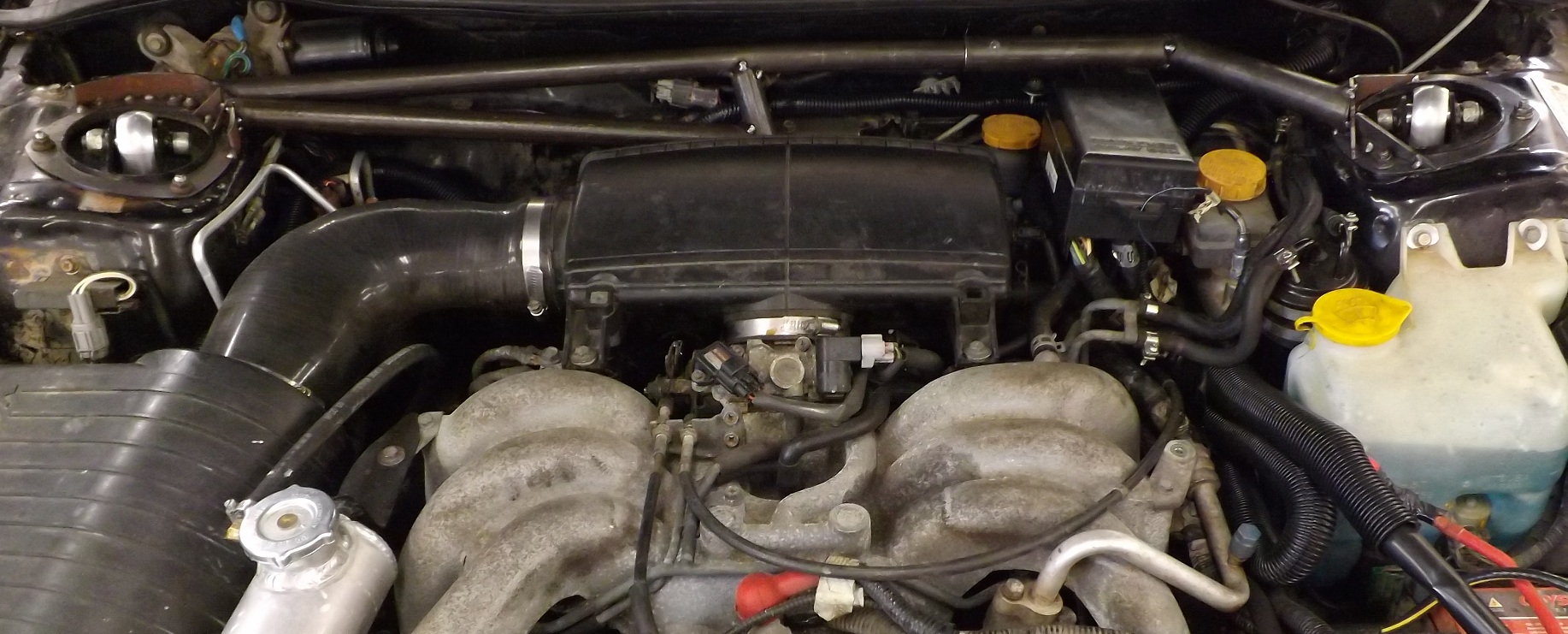

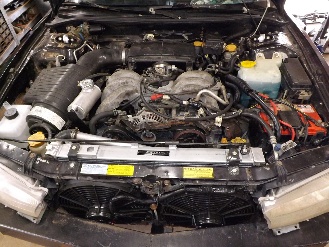

Engine compartment wiring basically all loomed and taped now.

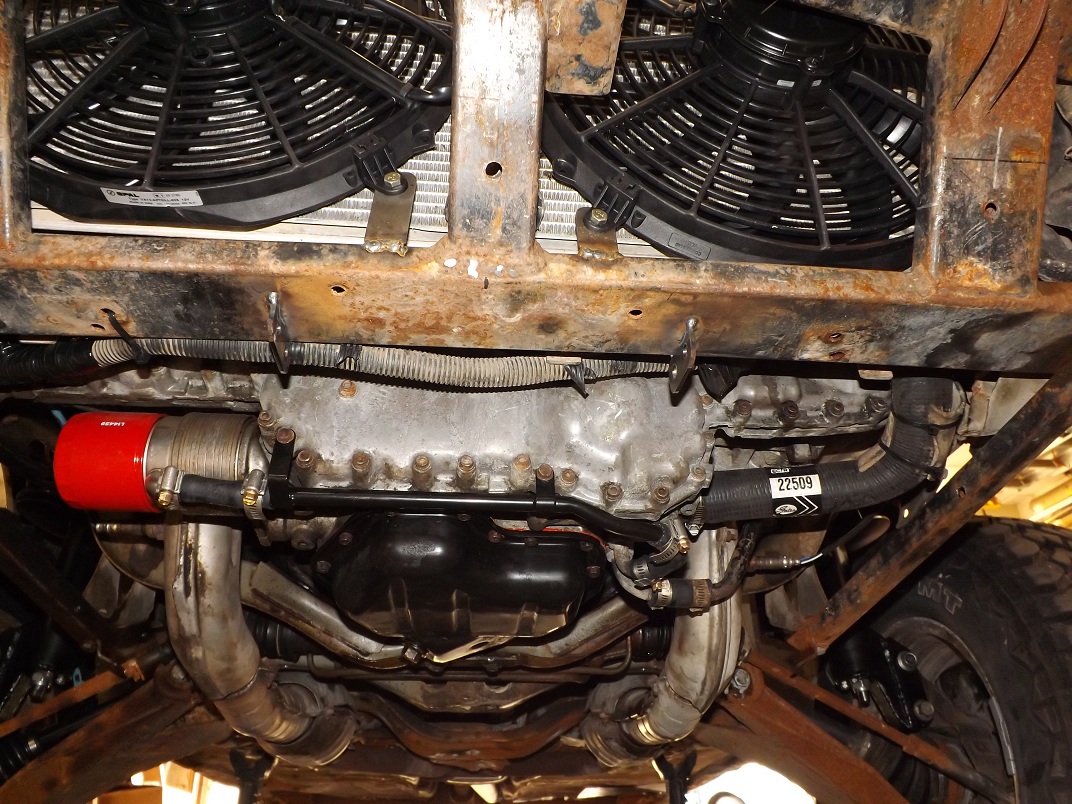

The coolant line and hoses at the bottom front of the engine looked questionable so to be safe I got new ones from the dealer and replaced them.

You stop when the body stops buckling tie that skid in to the role cage and rear framework or your gona be lookin for a new rig sooner than later

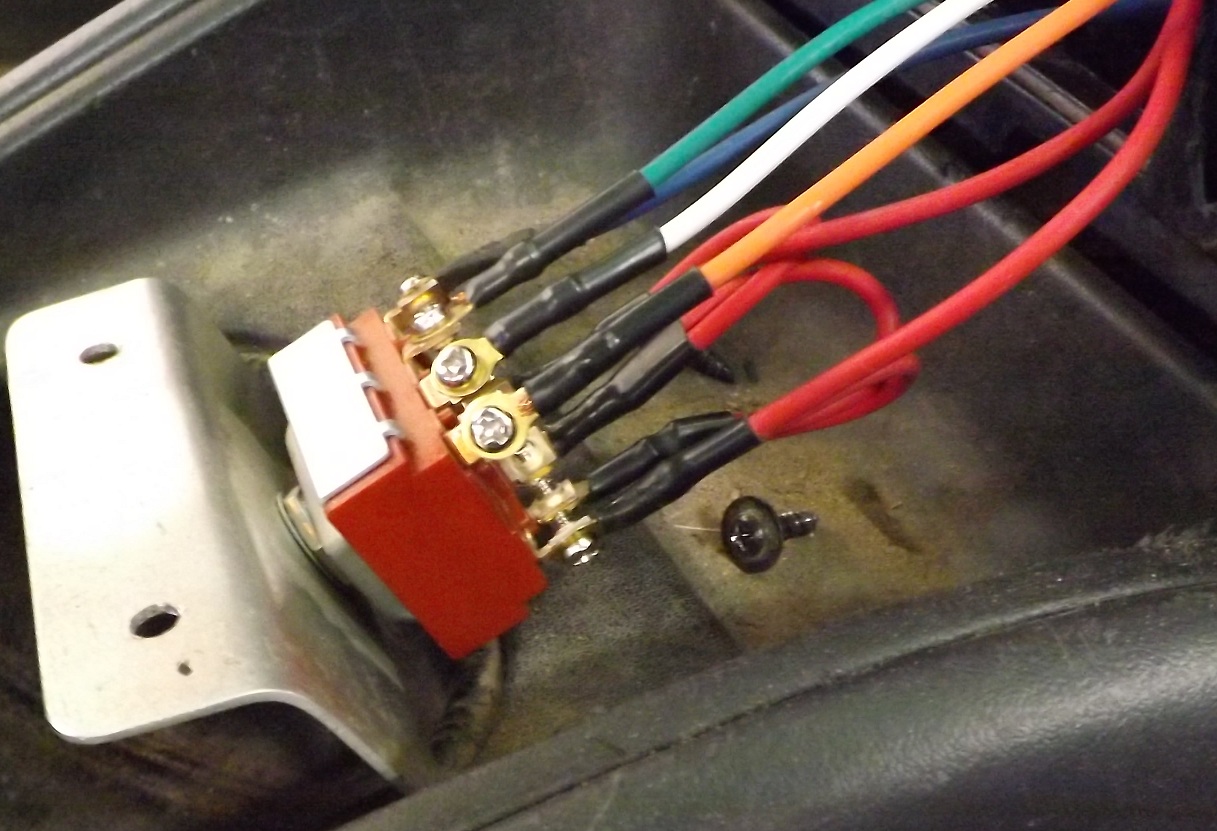

I wired up a four pole switch to ground the AC compressor relay, fan relay, main fan relay 1, and sub fan relay 1.  This seems to throw a fan code on the ECU, I assume when the ECU sees the fan relay is already grounded when it tries to turn them on it gets confused.
So now the AC works.  Cycles on and off sometimes, either my low pressure gauge isn't working quite right or the orifice is occasionally clogged, but discharging the system a bit seemed to make it run continuously.  One good thing about this setup is that we could just unplug the compressor or compressor relay and turn the switch on to run the fans if it's running hot.  The biggest downside is that it doesn't turn off at full throttle.  That wouldn't be too hard to do, not sure if I'll bother.

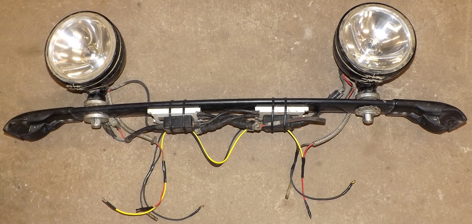

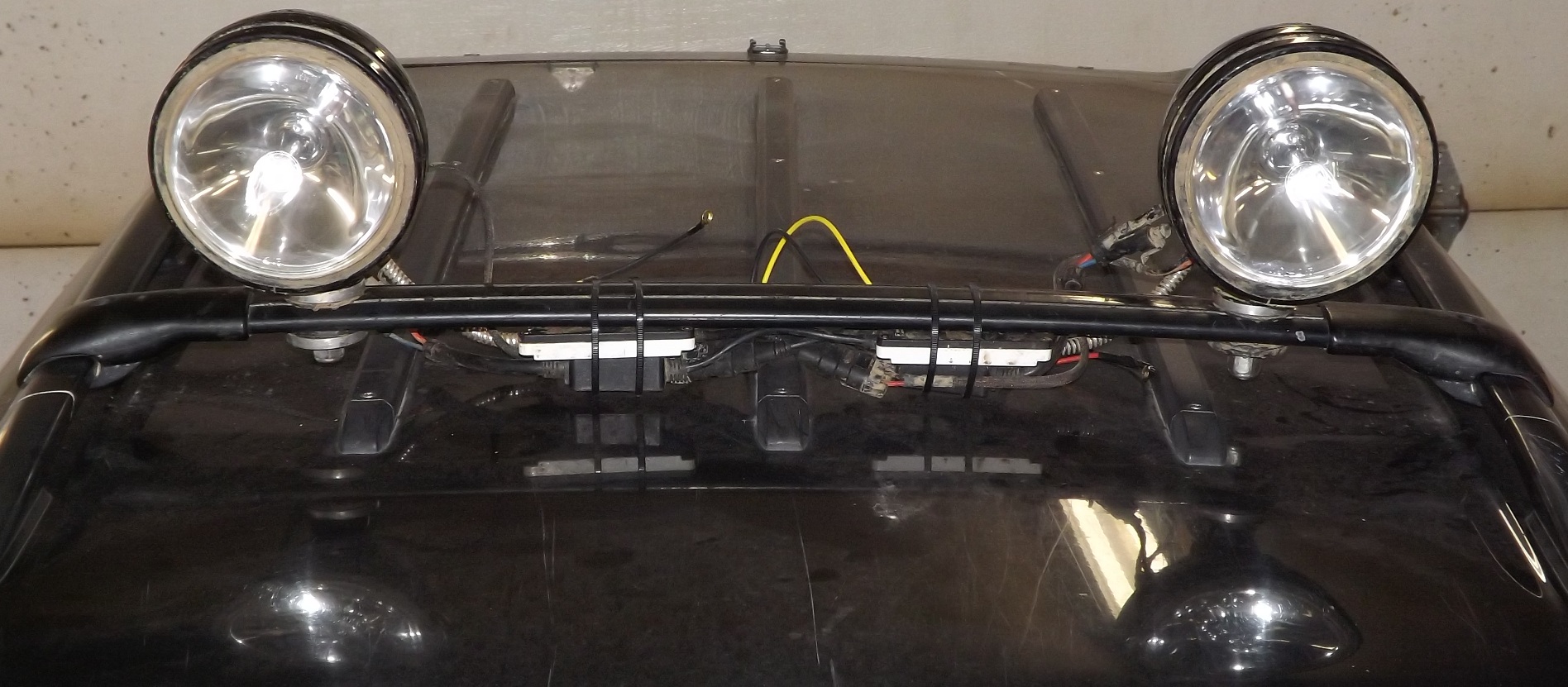

The last wiring project was the lights.  They will probably help at night, but the main reason we added these is so that people can see us coming in the dust.  It seems like the first thing you see when someone is catching you through the dust is their lights, the higher the better.  Drilled a couple holes in one of the roof rack crossbeams and zip tied the ballasts to the bottom.
Here's what it looks like installed.

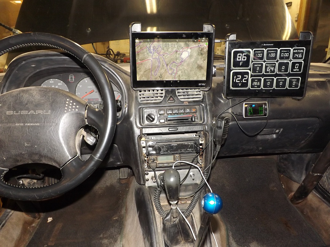

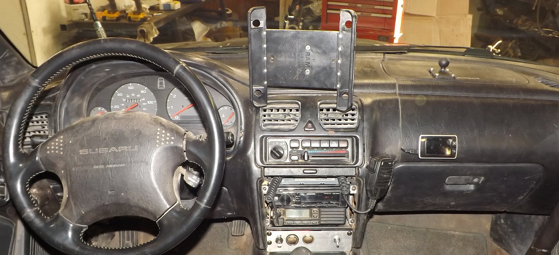

Finally got the rest of the dash in.  Had to leave out the passenger side air ducts and it was still difficult to get it in.  Normally the driver is hotter than the passenger so it should work out.  Added a tablet mount to the steel plate that covered the passenger air bag.  My friend made a little panel for the roof lights and AC switches and two cigarette lighters.
Tablets for GPS and gauges and tire pressure monitor.  That all works pretty well.  The angle in the picture is deceiving, they don't block your view at all.  Going to make some visors for them though, when it's sunny and they're dusty they're difficult to read, especially the tire pressures.  Before the V2R we want to figure out some kind of rear camera system for the one tablet.  The mirrors leave a lot to be desired.  It would be nice to also have the temp readout on that one too.

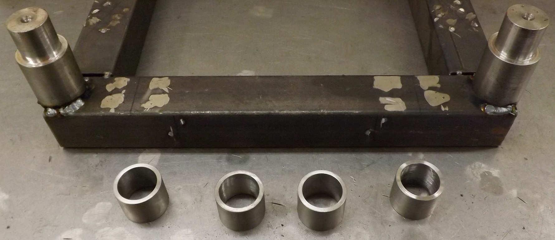

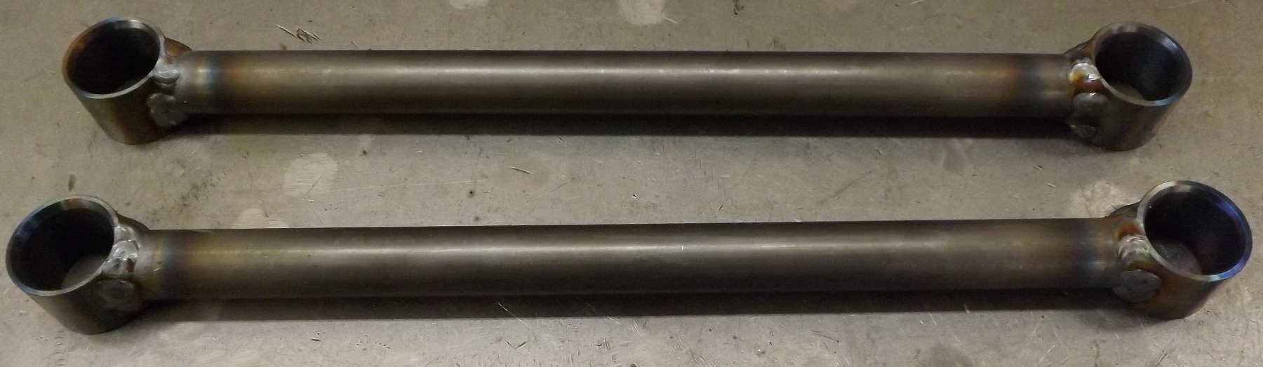

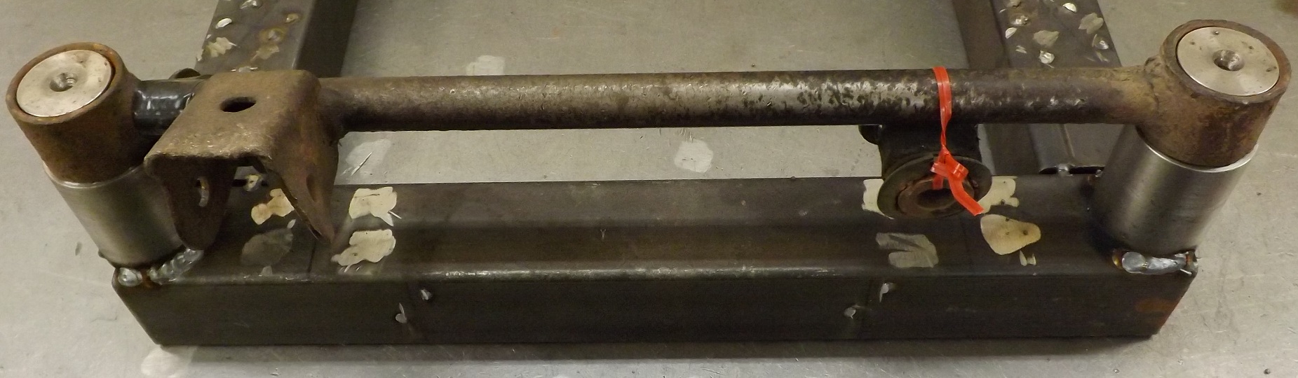

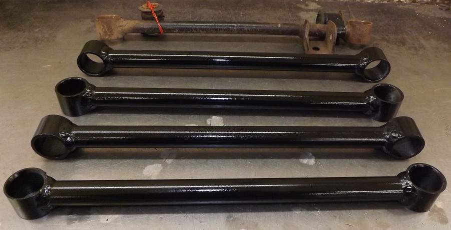

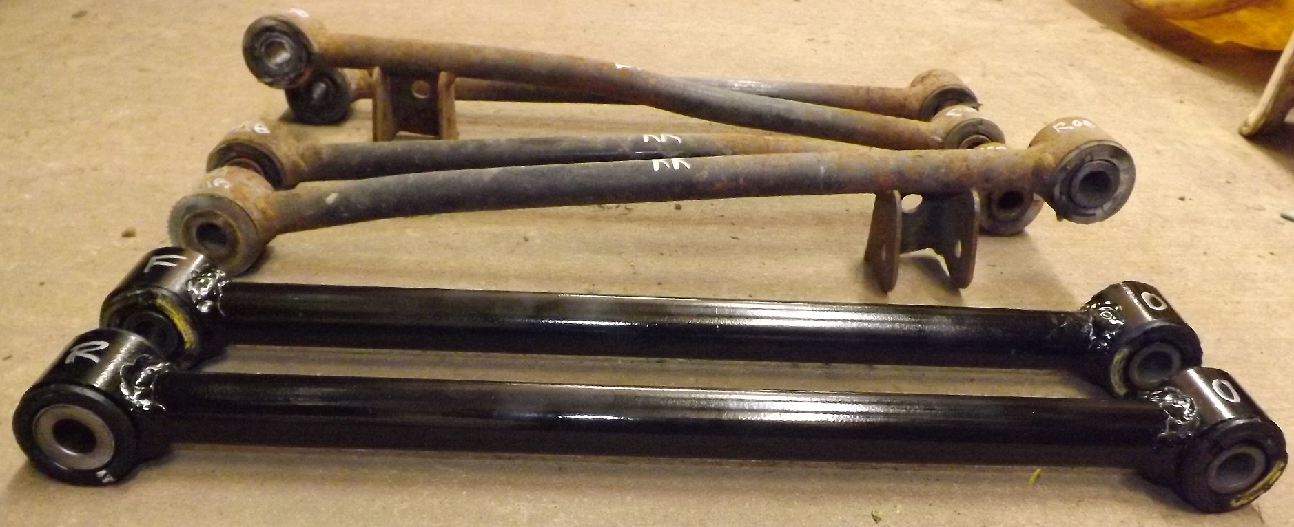

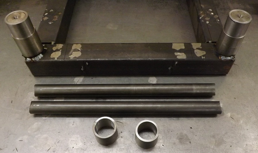

Modified the old front a arm jig to make a rear lateral link jig.
Turned the ends on the lathe out of some thick tubing, fit pieces of 1" x .120" 4130 for the links.  The stock links are 3/4", no idea how thick, we've never broken one, but they bend pretty easily.
I wound up buying Group N bushings, they're cheaper than the stock ones.  Pressing them in was difficult.  I turned up this funnel to help with that.  Soapy water or any other lubricant also helped.
Here you can see all four of the ones on the car were bent in one direction or another.  Made it impossible to get anything other than toe out.
Here's what they look like installed.

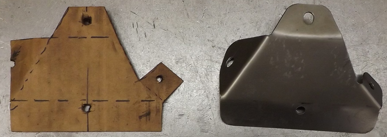

Made a lifting foot for the passenger side electric jack.  Tried to build more section height into it than the last one.  Not exactly how I hoped it would turn out.

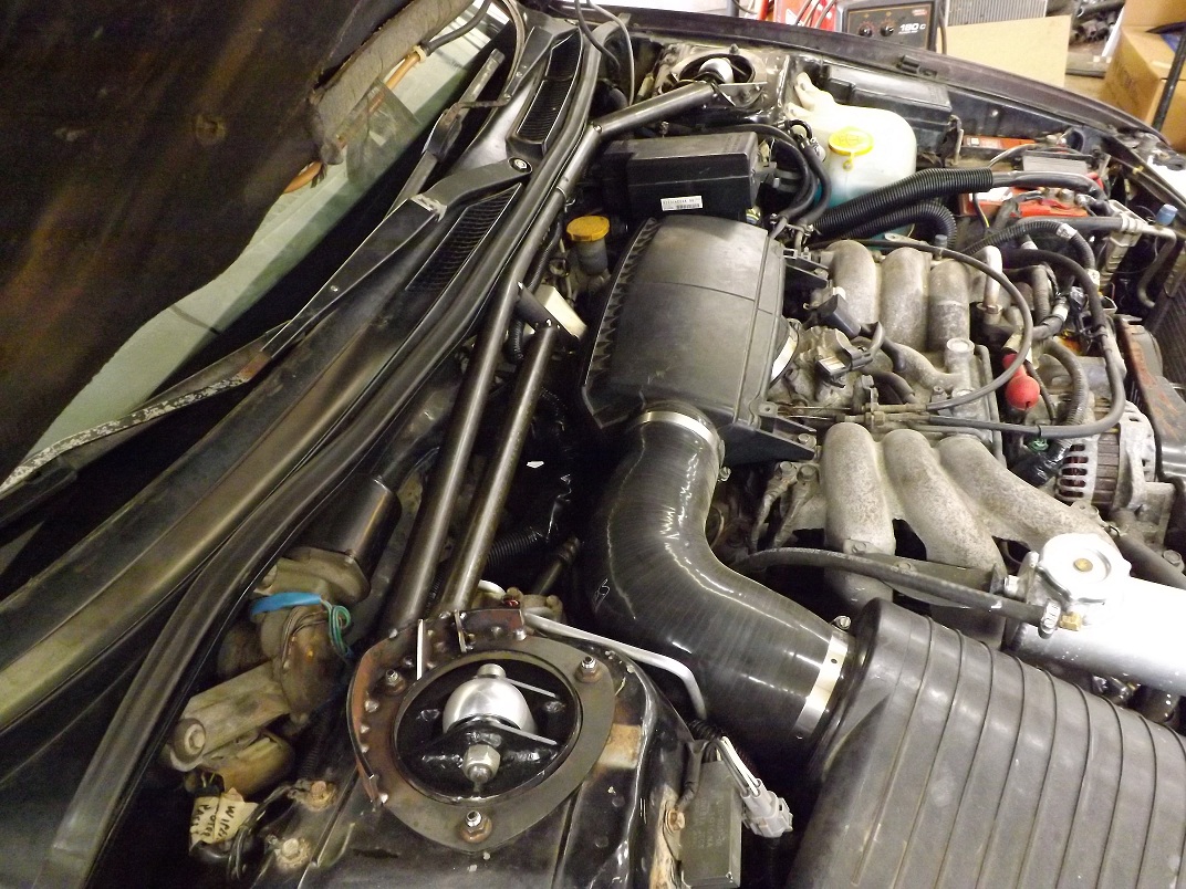

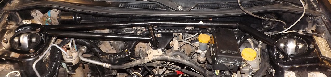

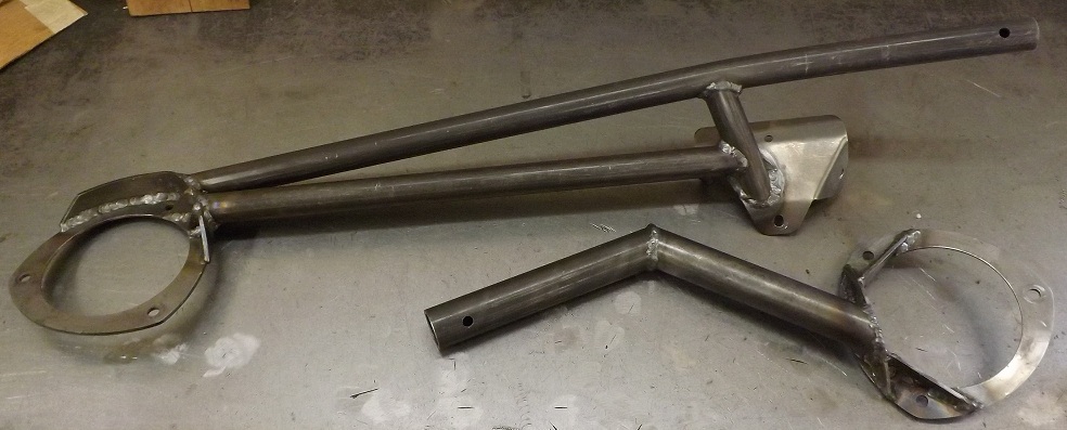

I'm nervous about the body holding up, so I finally finished a strut tower / trans mount brace I'd started on a long time ago.  Here is my CAD (cardboard aided design) model and steel bracket for bolting on top of the trans mount.  Just bolts on with four 6mm bolts, but folds around the bracket.
Here is what it looks like tacked up in the car.  Had to dodge the new fuse box and it has to be at least two piece since the strut studs are all tilted inwards.
Welded.
Painted and installed.  Not very difficult to install and isn't in the way of much.

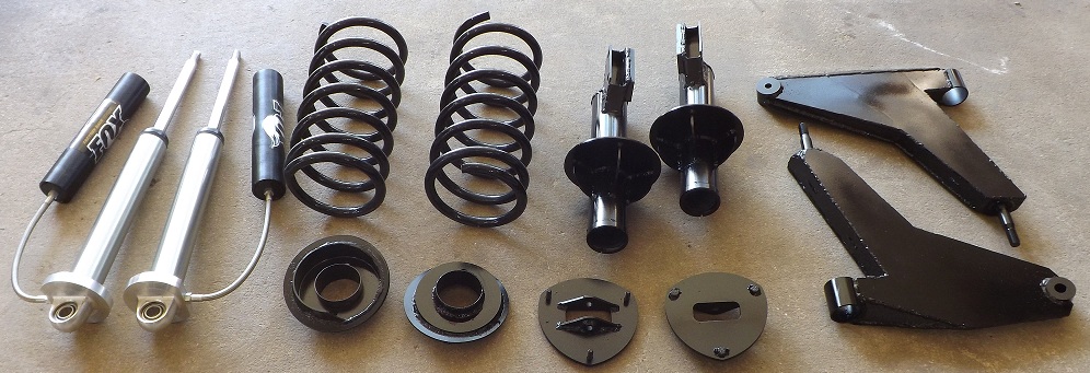

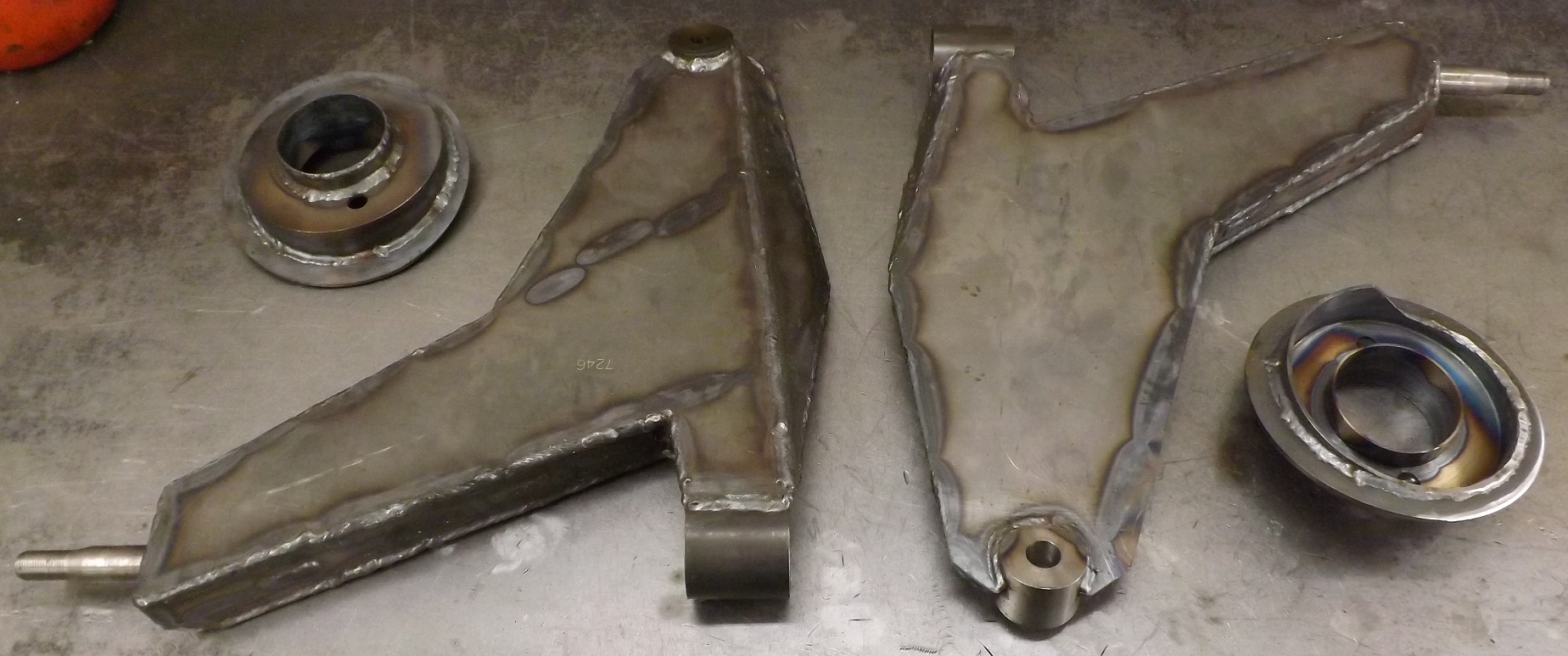

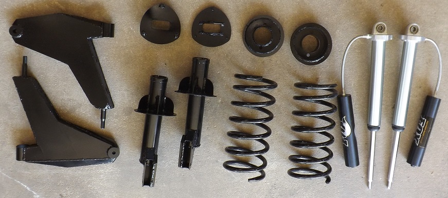

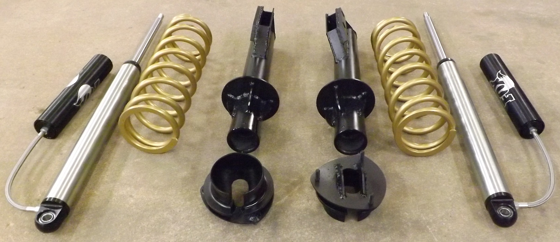

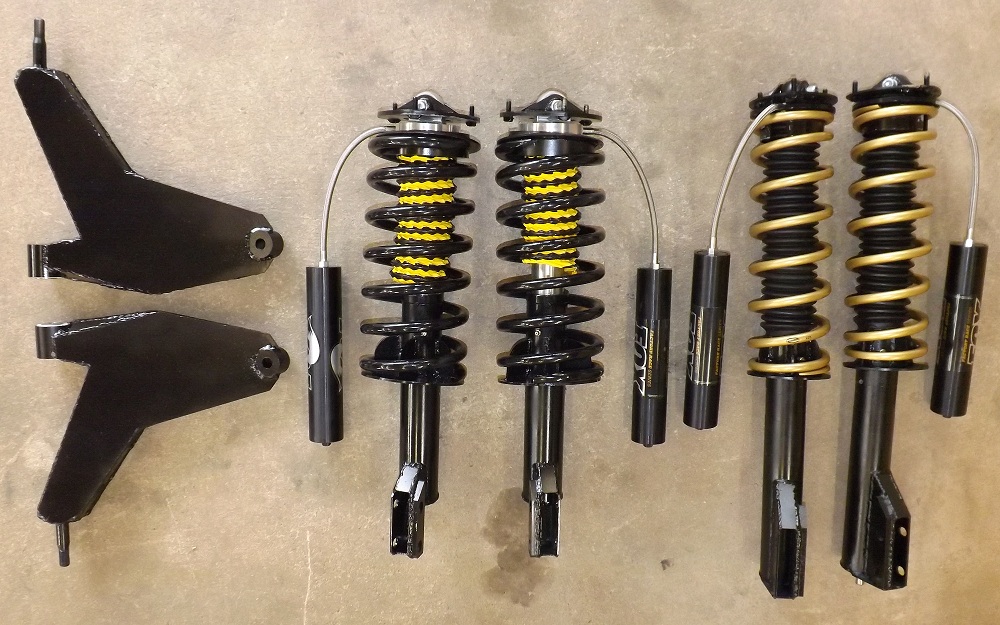

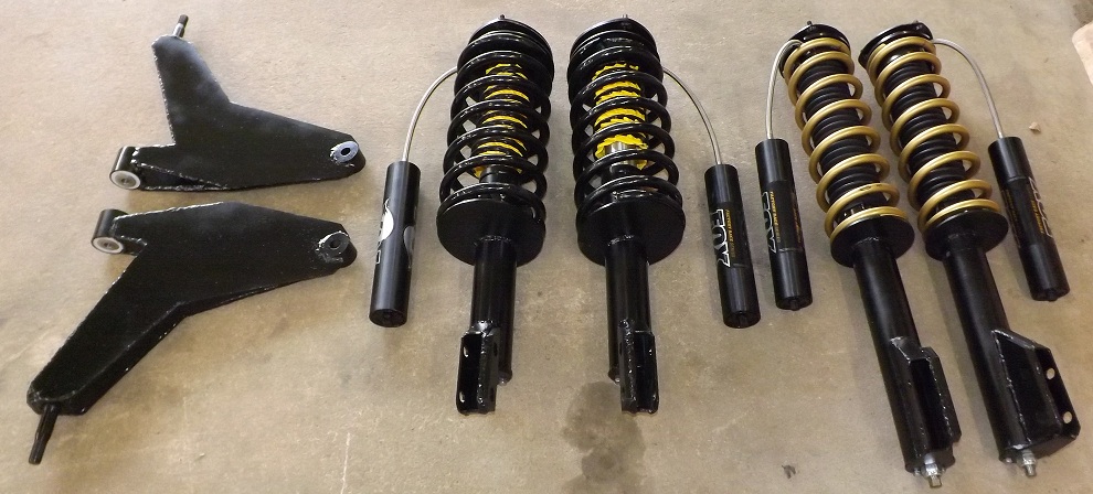

We've been working on finishing another set of struts for my friend's Forester.  Here are the rear strut parts:
Rear struts assembled:
Front spring perches:

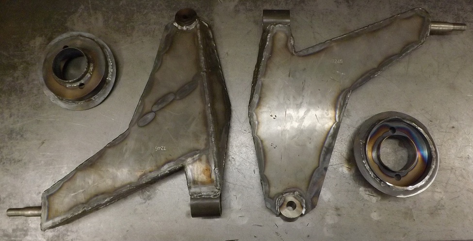

One of the last things I welded was those and the control arms.

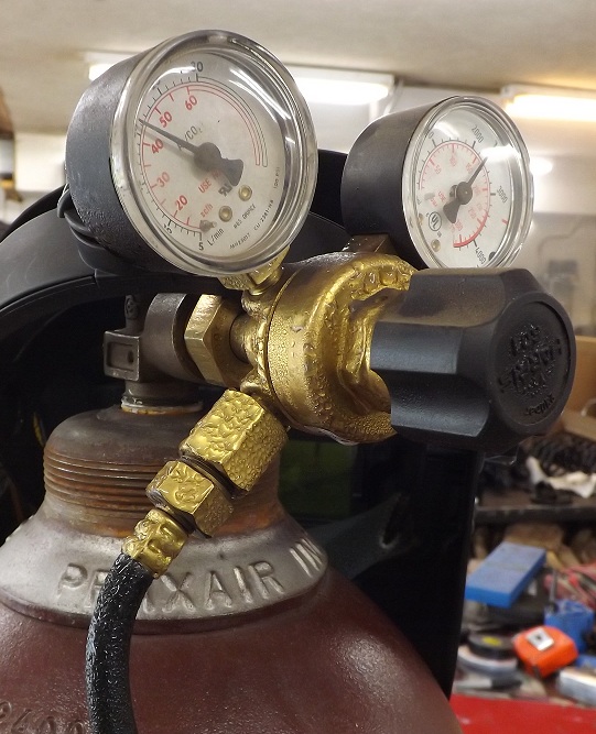

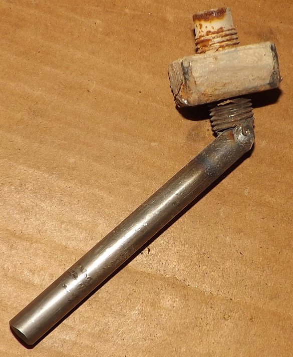

After a couple of hours of welding on the control arms, I noticed the valve for the inert gas was dripping with condensation:

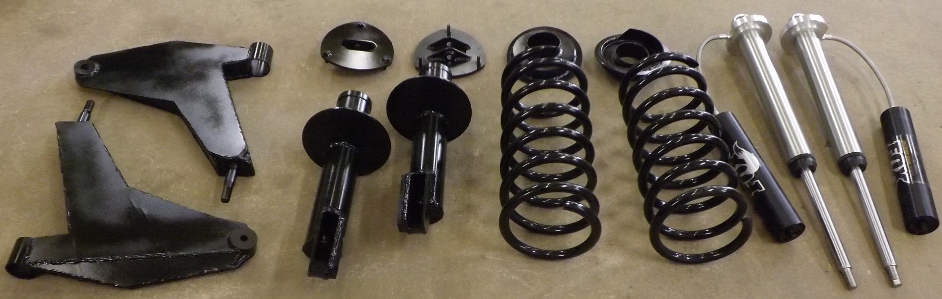

Front suspension parts:
Fully assembled:
Long travel struts vs stock Forester struts:

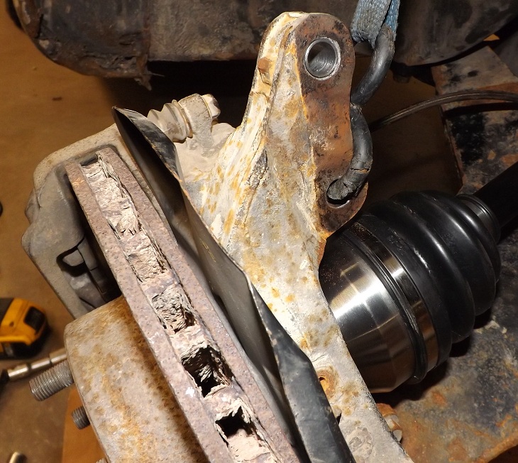

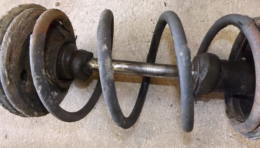

One of his strut shafts was badly gouged, you can't see it very well in this picture, but you can see the bumpstop has been pushed down over the strut body.  He's known this one is shot for a while but figured we'd be putting the long travel struts on.

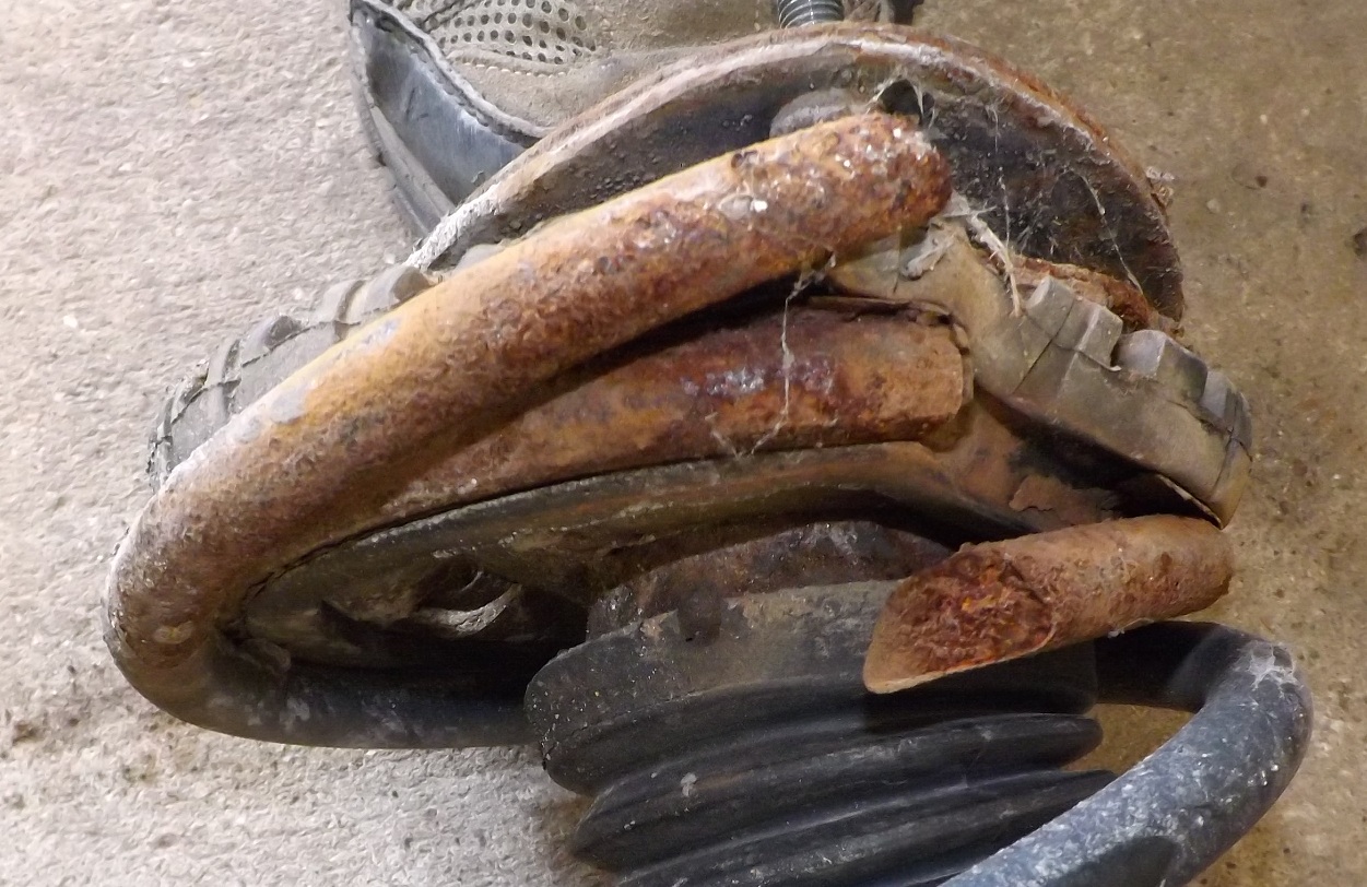

Broken coil spring on one of the rear struts.  We didn't know this until we took them off the car.
