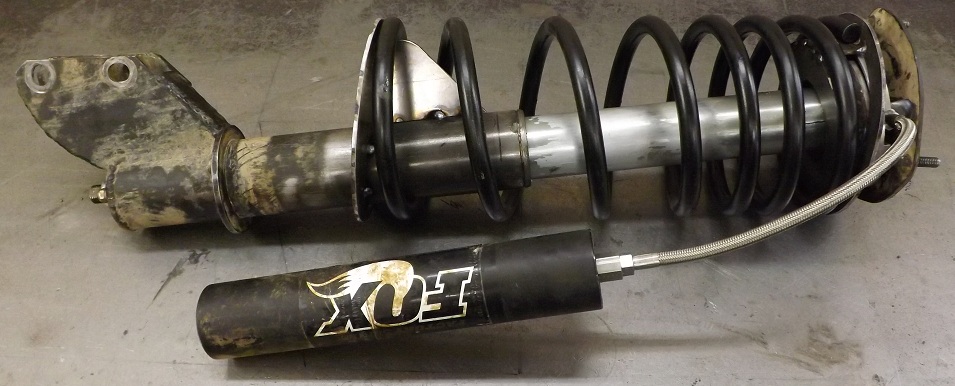

Test fit a larger spring to the left front strut.  Haven't driven the car, just set it on the strut.  Seems to be pretty low friction, but so does the original spring setup on the right front.  The rears seem like they have a lot more friction, judging by pushing up and down on the bumpers.  I'll try this on the rear next.

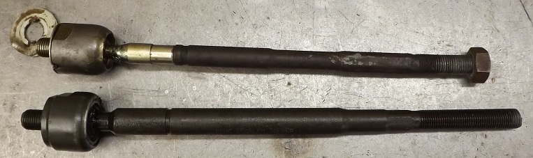

This is a larger tie rod (EV425) vs stock (EV257).  The larger ball joint comes very close to the crossmember, so I'll have to watch the boot and make sure they don't get worn or torn.  If they do, I'll probably try the EV240 next.

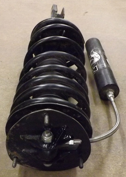

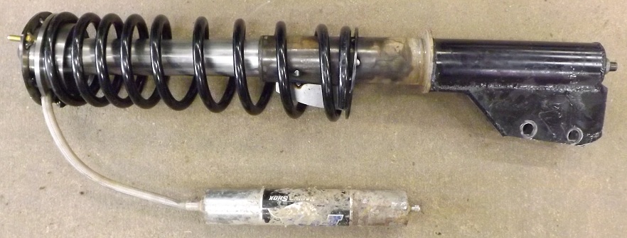

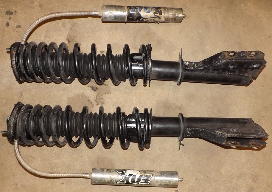

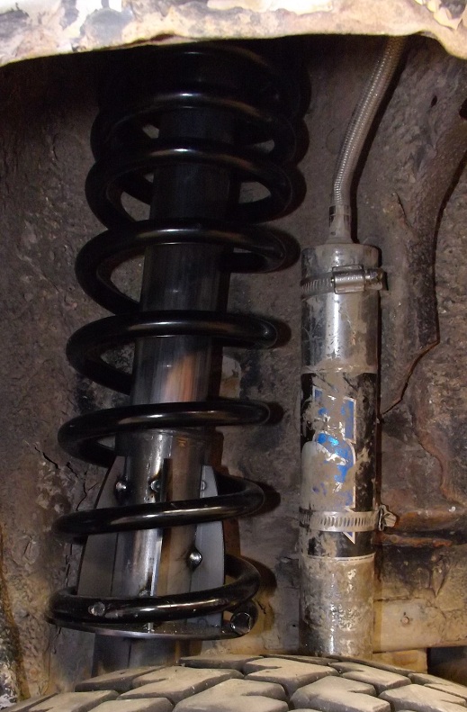

Here's how the struts with offset springs turned out.  Seems to reduce friction.  If nothing else, these springs are half the cost and I only need one per strut instead of two.

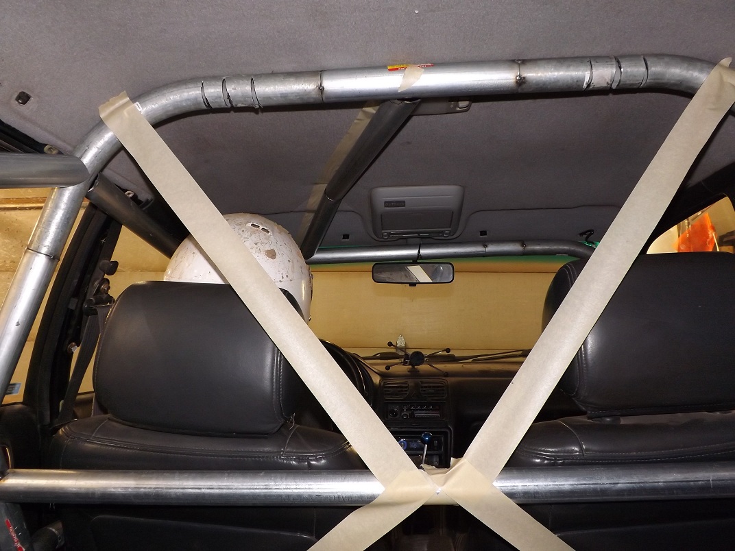

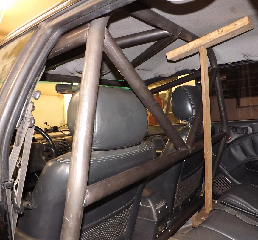

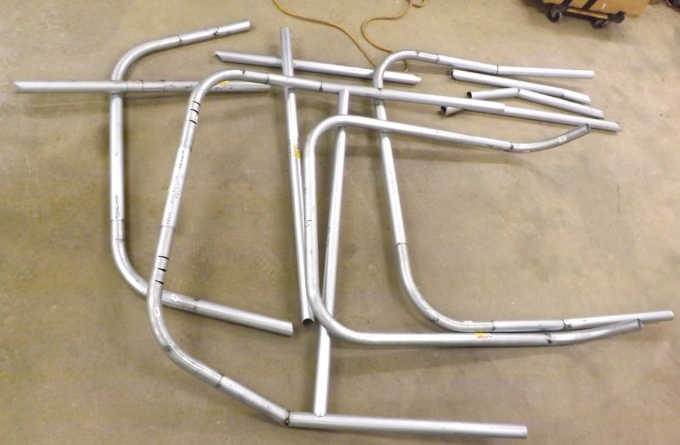

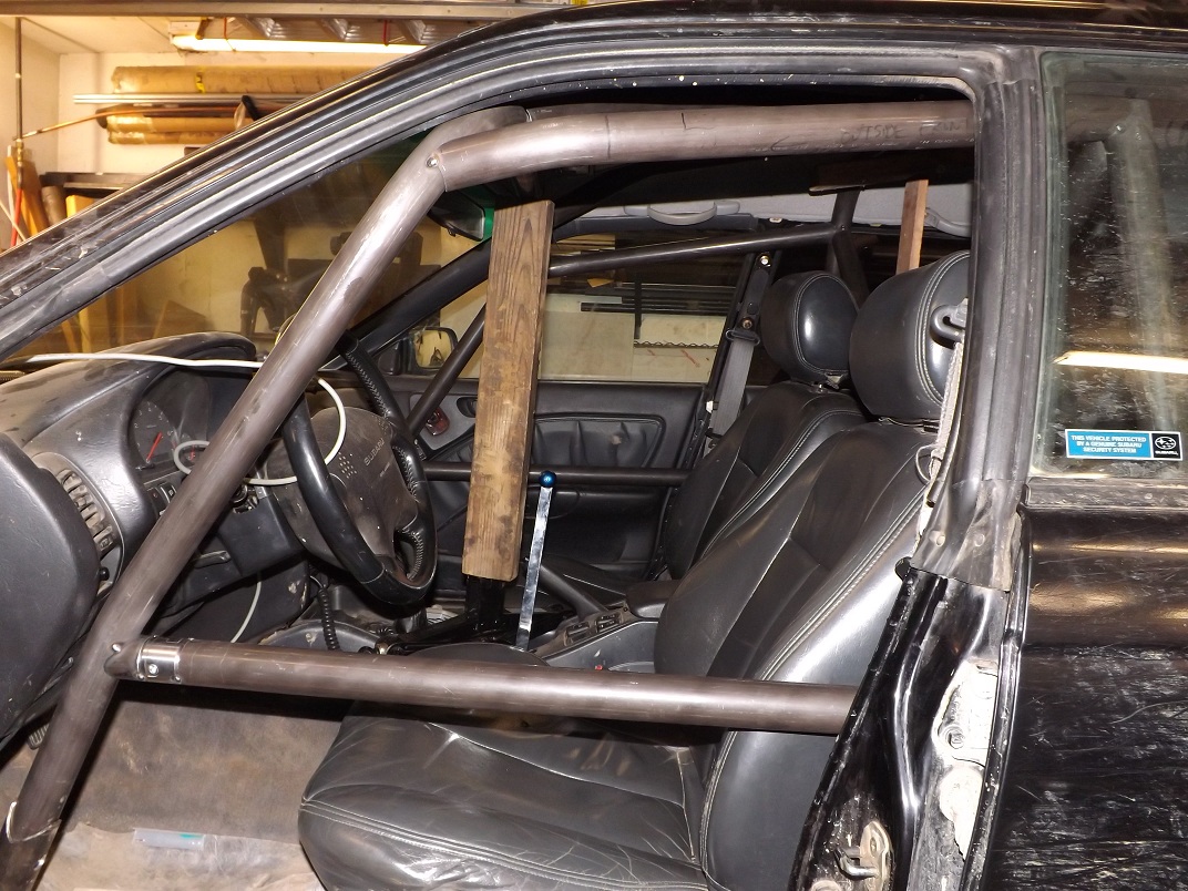

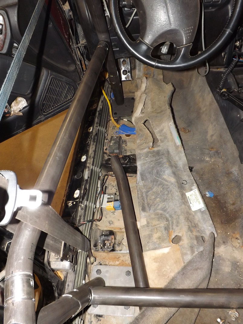

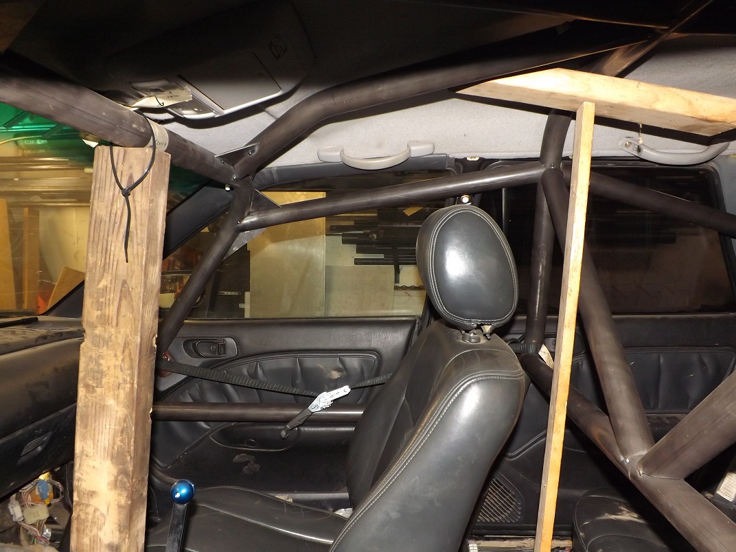

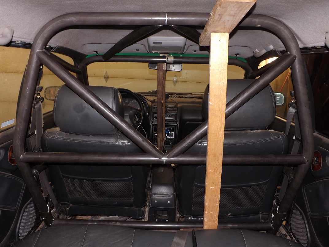

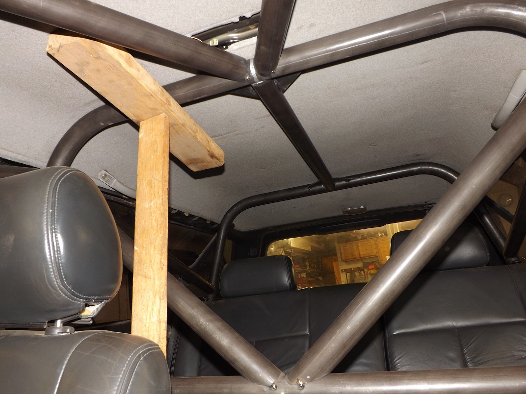

I'll start catching up to where we're at with this.  These are pictures of the mockup of our cage out of 1.5" conduit (about 1.75" OD).  This helped a lot, especially when bending the real thing.
Here are the real bends with the mockup bends:

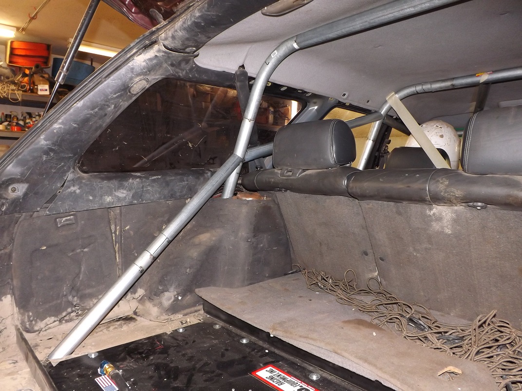

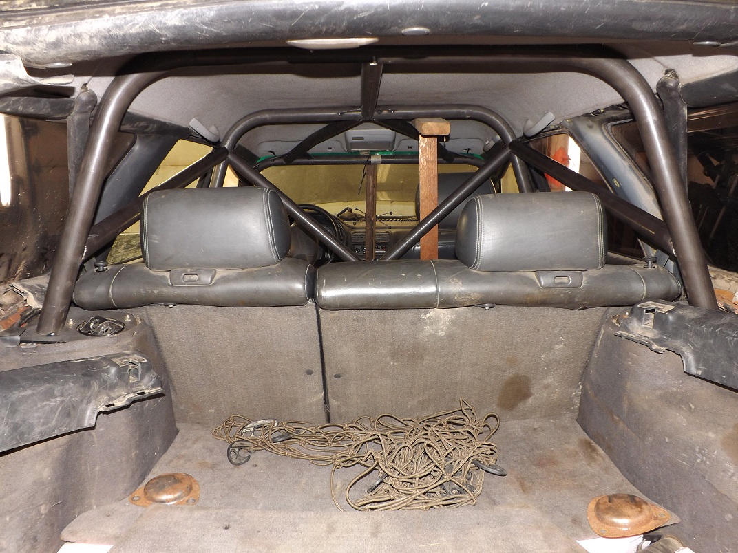

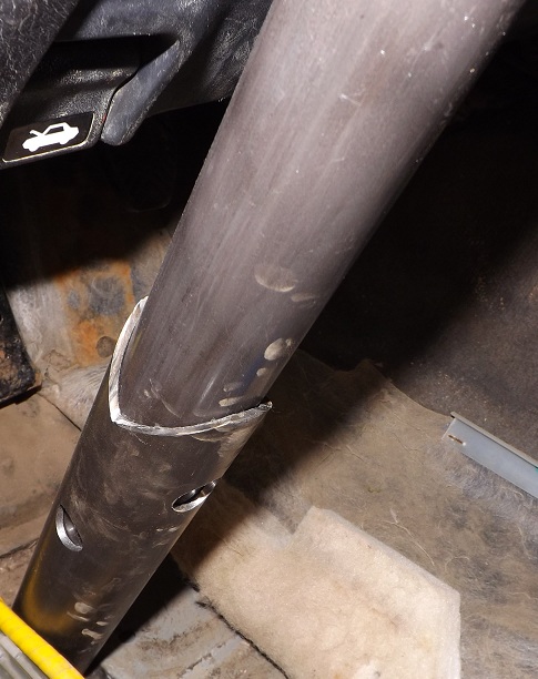

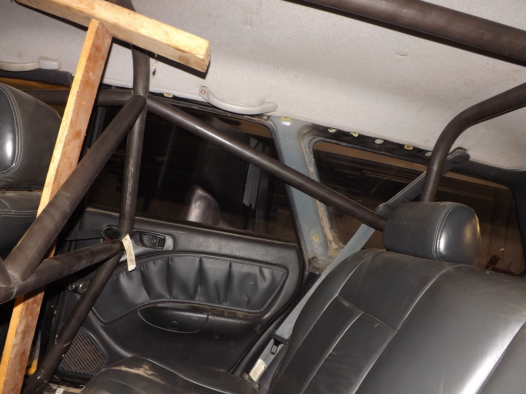

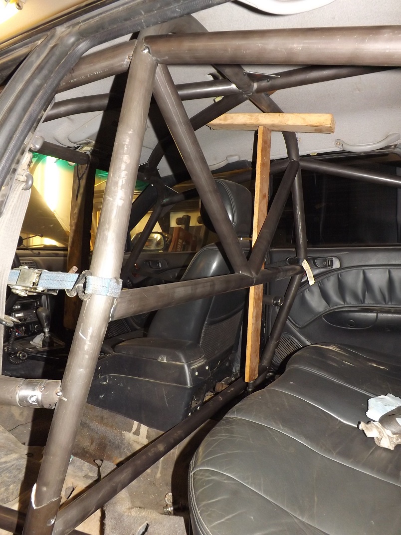

Building the actual cage.  We sleeved the bottoms of the main hoops so we could drop the whole thing down and weld the tops of the joints after most of the tubes were fit and tacked in.  Actually worked pretty well.

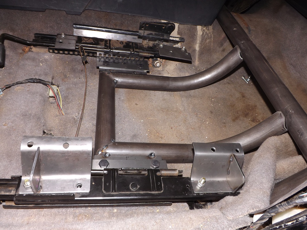

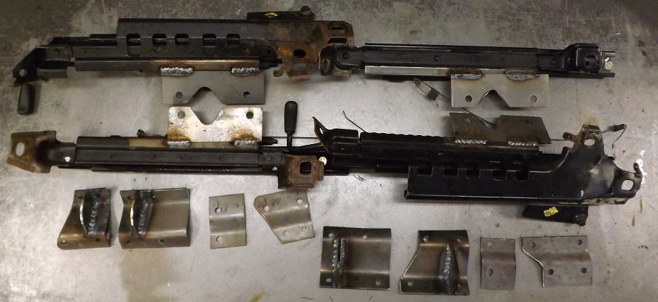

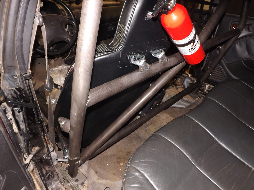

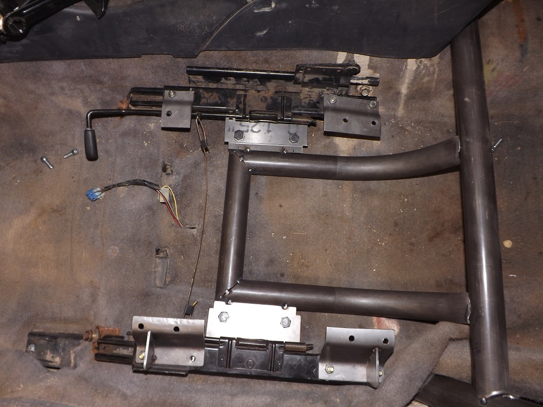

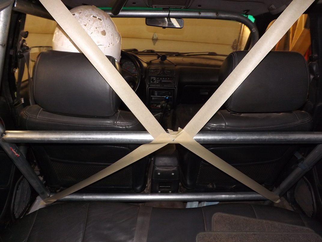

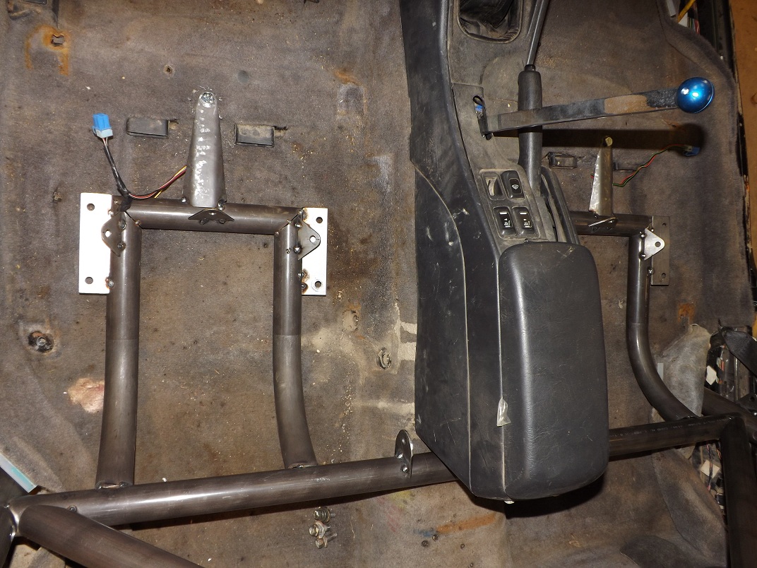

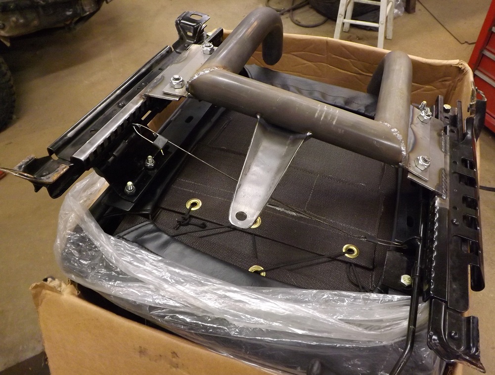

The seat and harness mounts took almost as much time as the rest of the cage.  Wound up tilting the seats towards the middle of the car to keep our helmets away from the rollcage.  Using Mastercraft Sportsman seats, they were the tallest back race seats I could find.  Used the stock seat sliders so they could bolt to the floor and weren't too hard to adapt to the seats.  Removing the seat sliders from the driver's seat was a PITA.  They were riveted, bolted, spot welded, and wire welded to the bottom of the seat.  The passenger seat was much easier, I think one of them might be from a slightly older or newer car but they look the same.  The U of tubing will provide harness mounts and bolted tabs to hold the seat sliders in place.

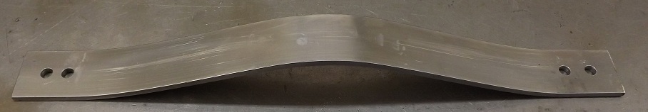

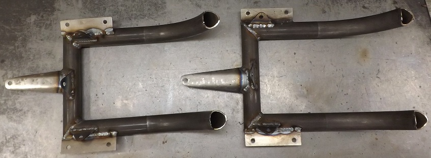

Tech guy wanted us to add a tab on the front of the U so it wasn't just hanging off the roll hoop.
Welded the U and the tabs on it out of the car.

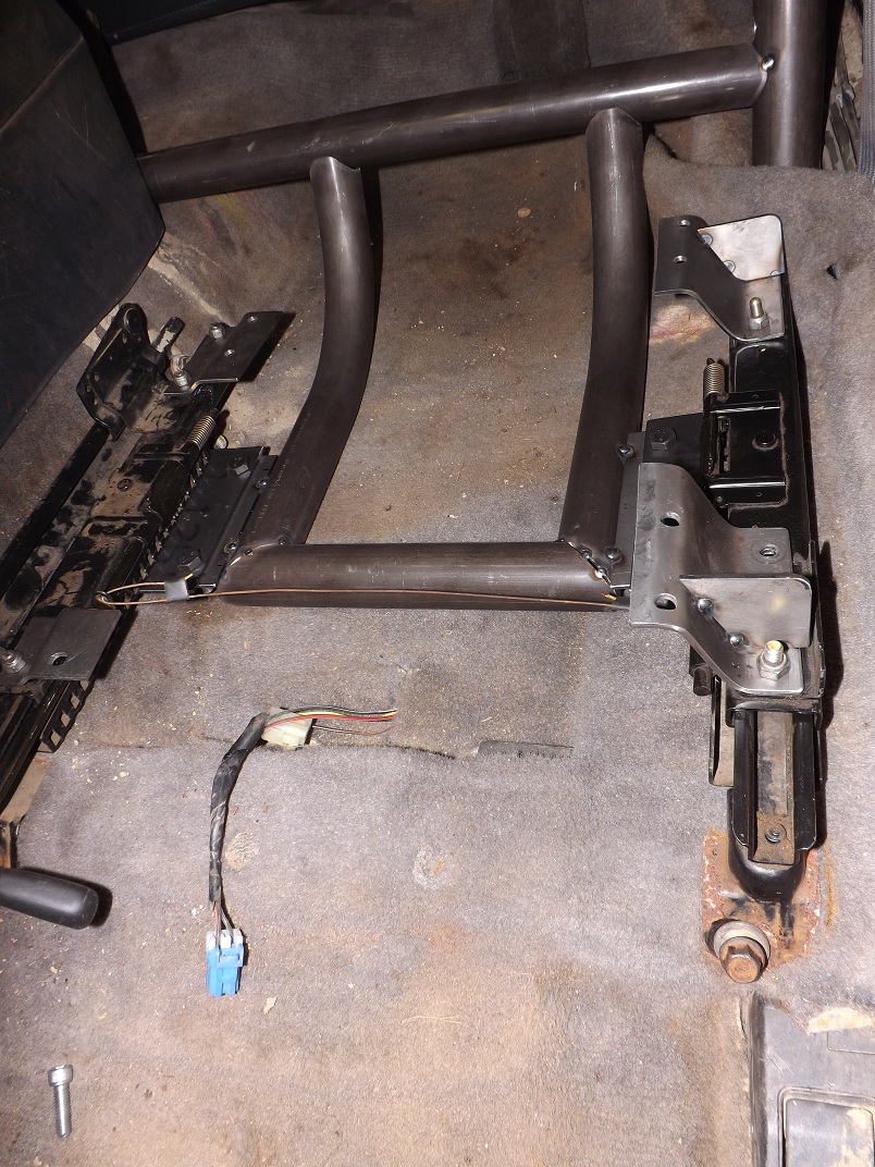

Bolted it all to the bottom of the seat before welding the U to the roll hoop.
The seats rub on the center console so the stock seat belt latches wouldn't fit easily.  Now that I have time I'm going to make those work with the race seats, buckling in a five point harness every time you hop in the car is a nuisance.  After we're done testing/racing for a while I'll put the stock seats back in.

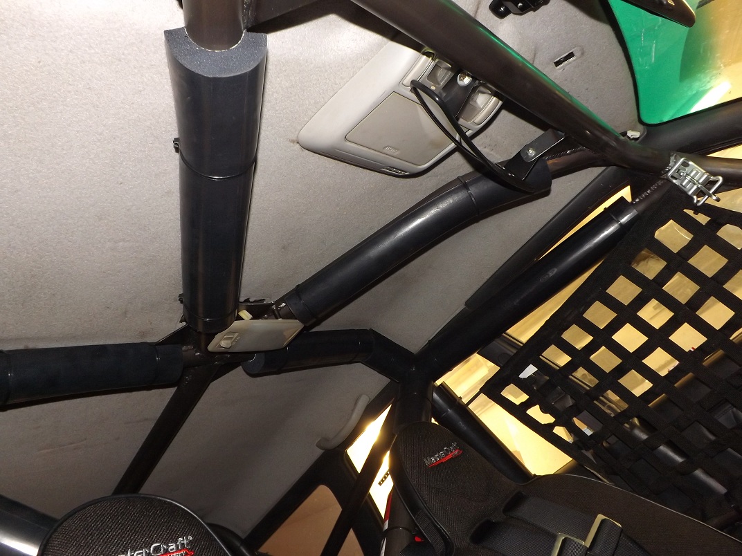

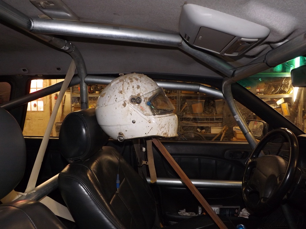

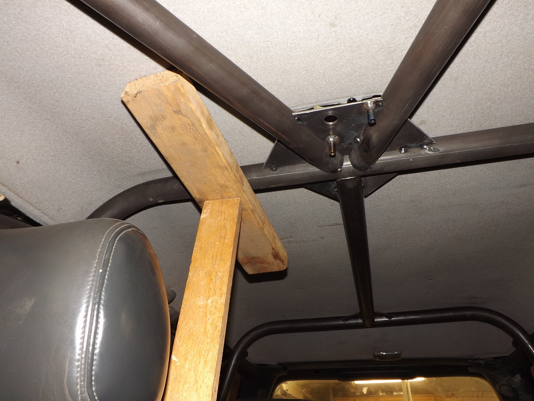

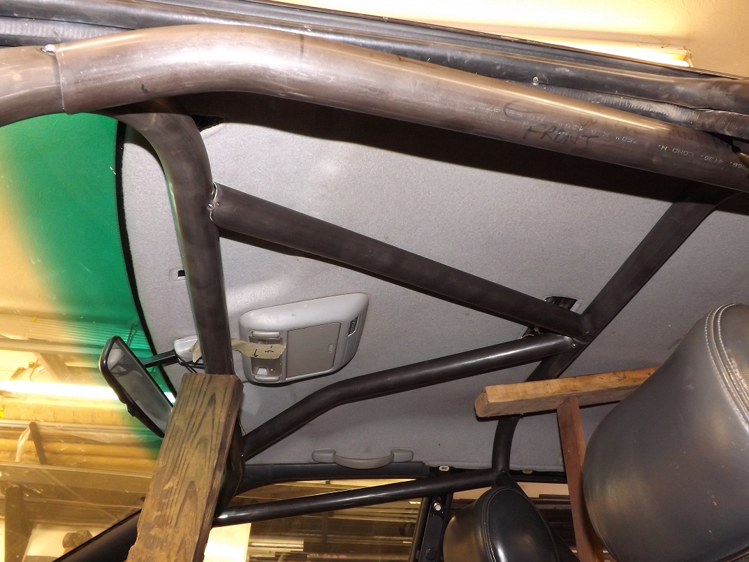

We thought it would be nice to still have the dome light so I made holes to mount that to the cage gusset.

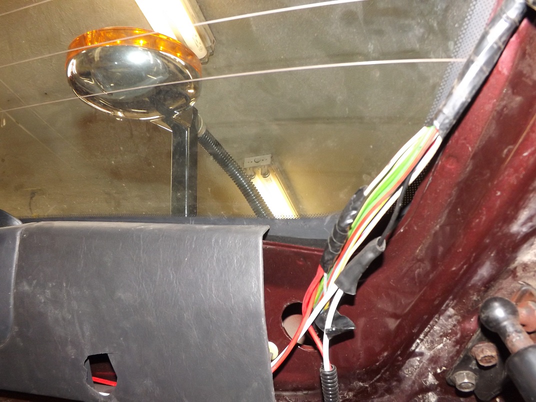

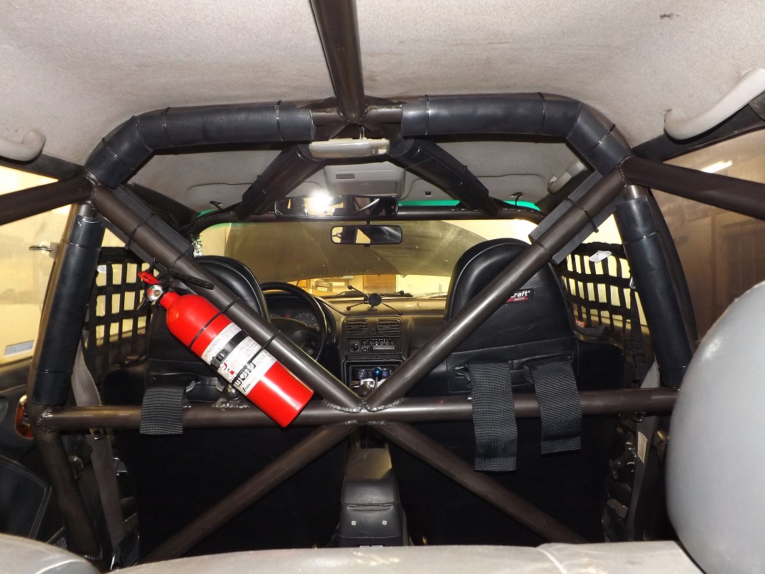

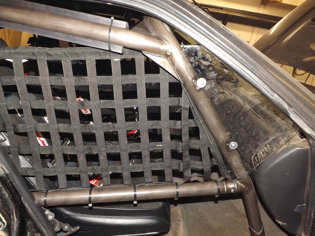

Here is how the main cage turned out.  The extra mirror is for the navigator so he can warn the driver when we're about to get nerfed.  Below the window net you can see the secondary door latch we need.  Tech guy wanted us to make the small polycarbonate "vent windows" to cover the rest of the opening the window nets don't cover.

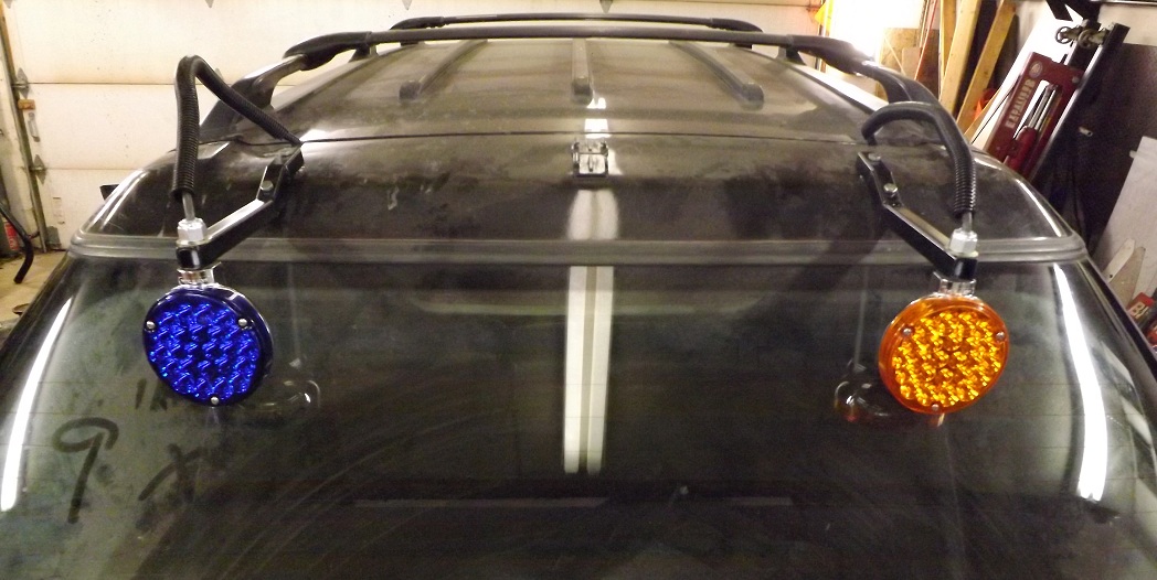

55W equivalent running lights in the rear, switched with the ignition, one amber, one blue.  These things are super bright.

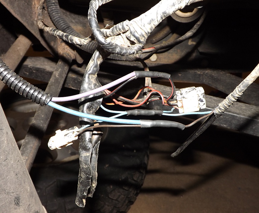

Turns out there is a wire going into the hatch that is switched on with the ignition, so that was convenient.  I think it was the white/blue one.  Spliced into that and the big ground wire.

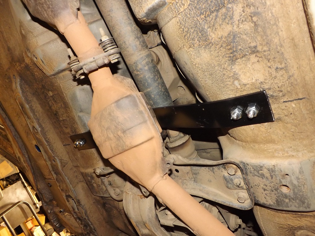

Have to have a 1/4" x 2" driveshaft loop so I bolted this to the floor with some big washers.

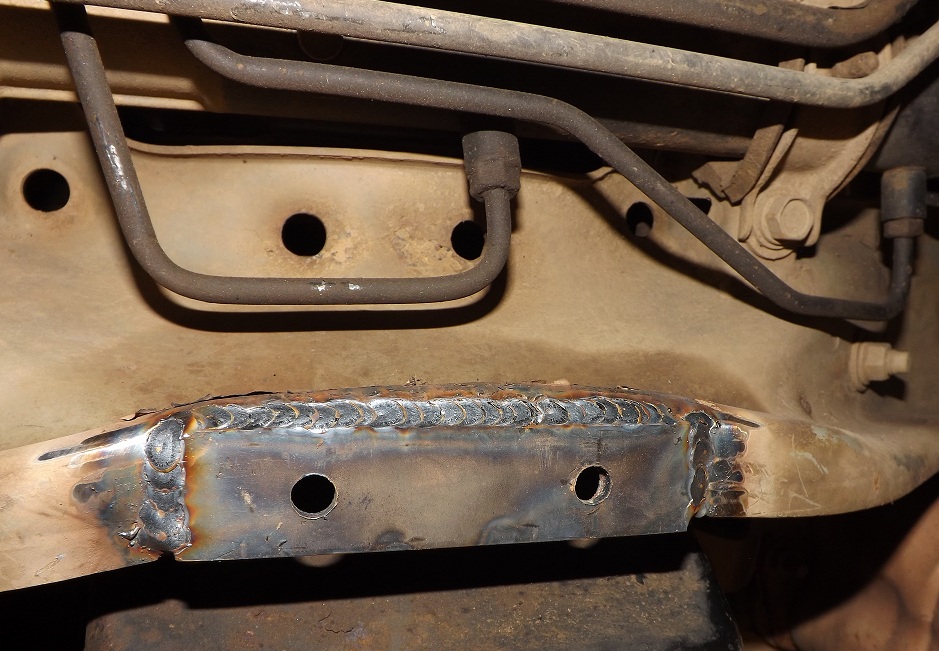

The tubing we'd added in front was ripping out of the radiator support during our trip back from Texas so we redid some of that when we got home.
The bolt holes on the bottom of the front crossmember were nearly ripped out all the way so I welded a piece of plate on the bottom of that.  Ideally we'd run the oil pan guard to the two bolts behind these also just to tie more things together but we decided not to this time.

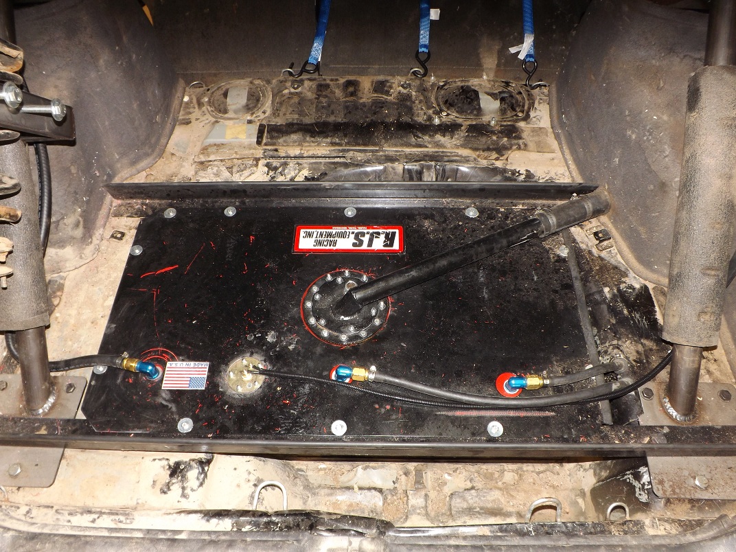

The fuel tank would only take fuel a quarter or half gallon at a time.  It sounded like it was filling up the fill tube and then it'd kick off the gas pump and drain into the tank.  I straightened out a couple of kinks in the vent line.  When I took the fill tube off it looked like the flapper was sort of cupped, so I weighted the edge of that.  While I had it apart I added a fuel level sender.  This one ranges from about 10 ohms full to 70some ohms empty.

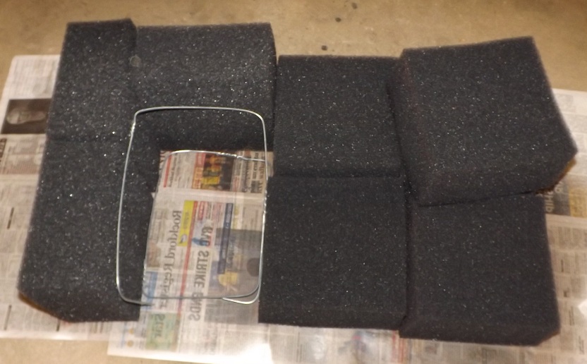

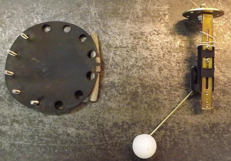

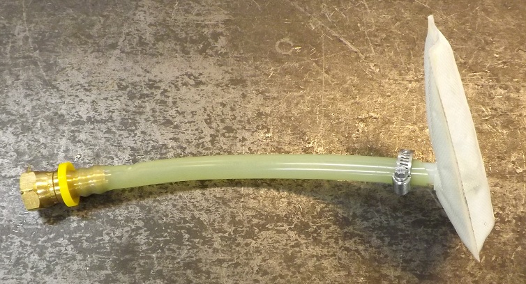

Since the float arm needs room to move up and down freely, I rearranged the fuel cell foam like this.  I wound up a piece of aluminum solder to keep the foam from shifting into this hole.  Fun to install all this through a 5" hole in the center of the fuel cell.
Added a fuel sock to the end of the pickup tube.

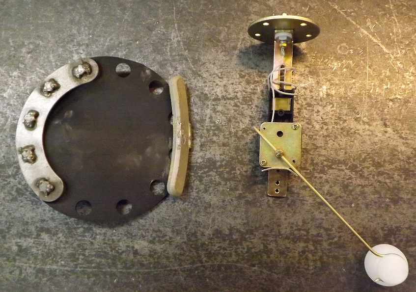

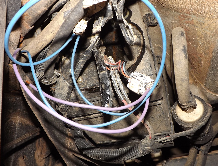

These pictures sort of show how I wired the sender.  For some reason I had to jump one of the wires from one sender to the other and then wire the other side of both senders to either side of the fuel level sender.  The small plug near the top went to the passenger side sender stock.  One terminal to the new sender, the other spliced to the driver's side.  First picture is how I had it mocked up to test.
Then I spliced and heat shrinked the connections.  Here you can see which wires went where a little better.  Taped and zip tied it all up after this.

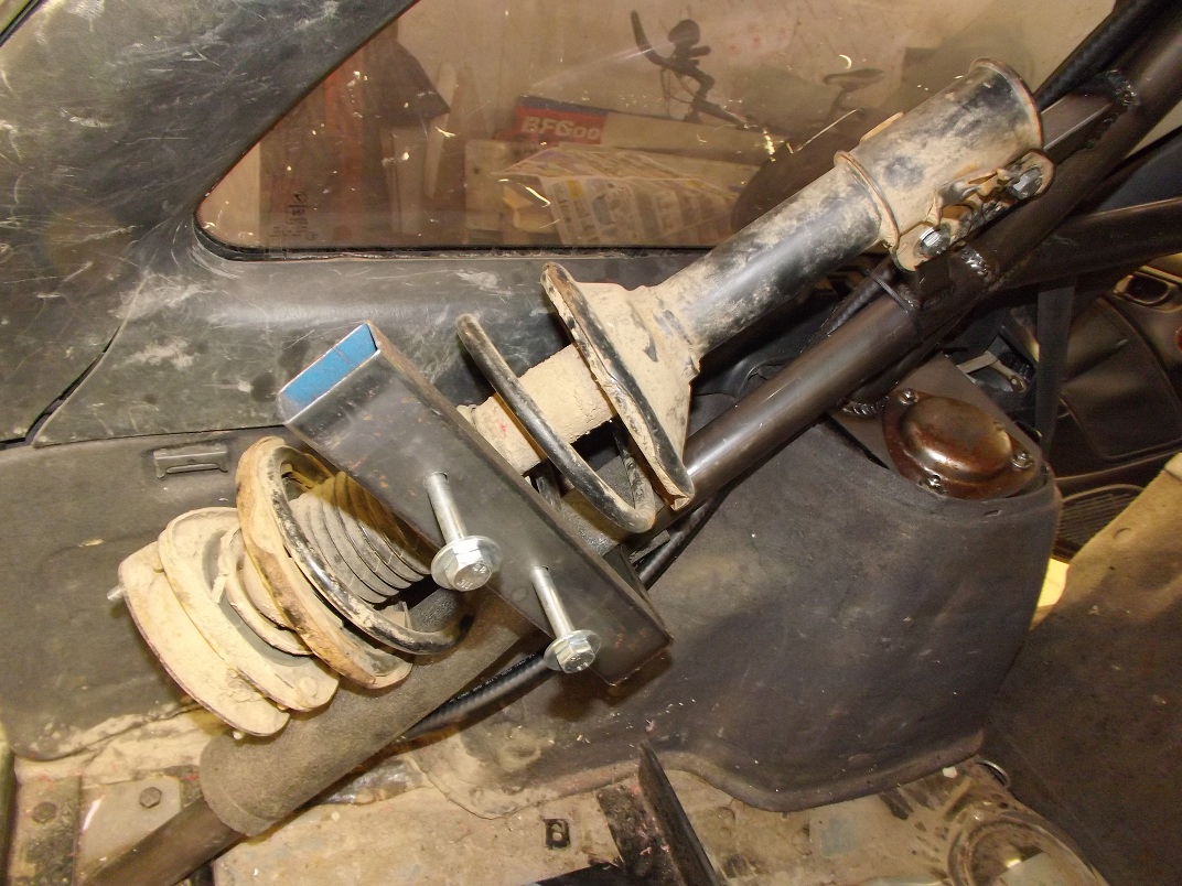

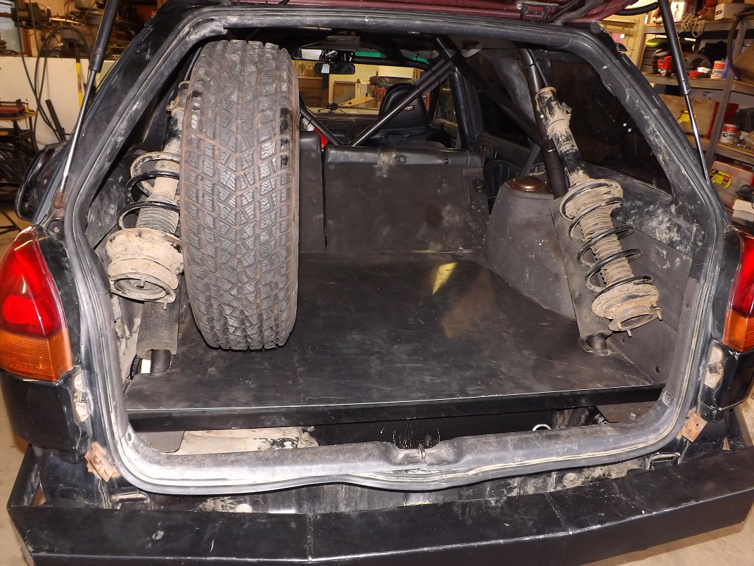

Driver's side strut and spare tire mount.  Set it up so there's about an inch all the way around the tire in case we run something bigger in the future.  Padded the rollcage tube so the strut didn't bang against it, but the two bolts hold it in place quite rigidly.  You can see the 3/16" steel plate on top of the strut mount too.
Passenger side spare strut mount.  You can sort of see the fuel cell vent hose in these pictures.  Has to go up and around the roll cage to prevent fuel coming out in case of a rollover.
Rerouted vent hose and fuel level sender.
Here's what it looks like with spare tire and struts bolted in.

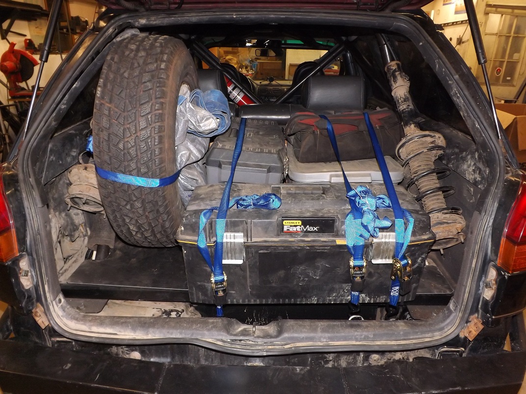

Loaded up with spare parts, tools, fluids, etc.

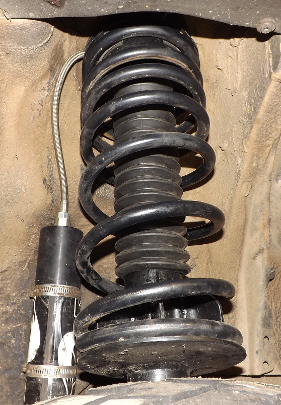

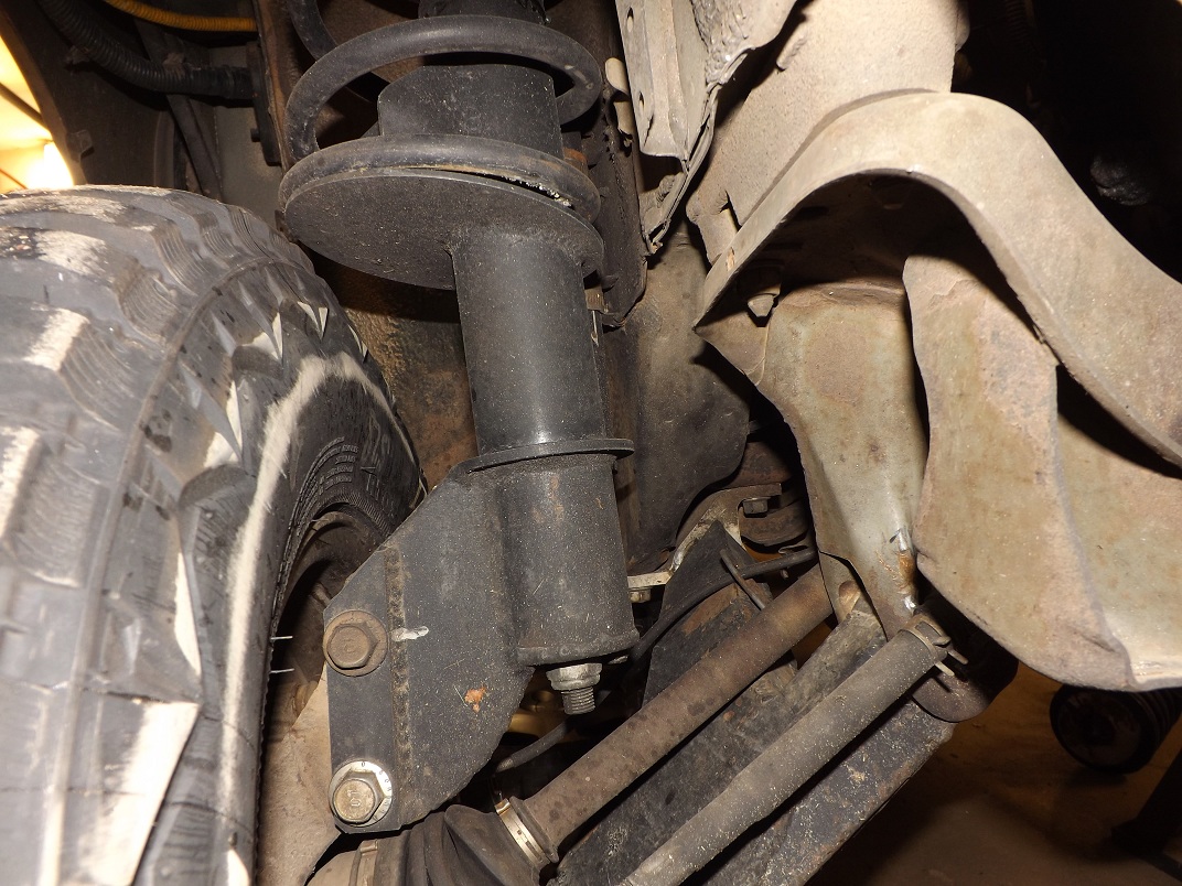

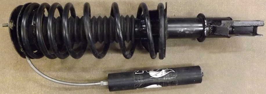

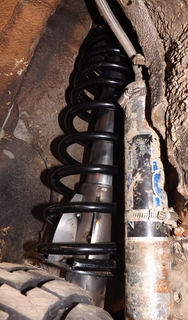

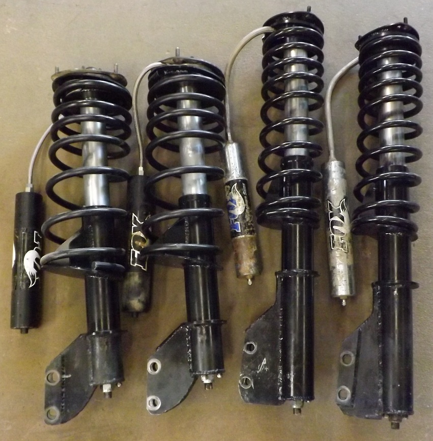

Here is the latest on the struts.

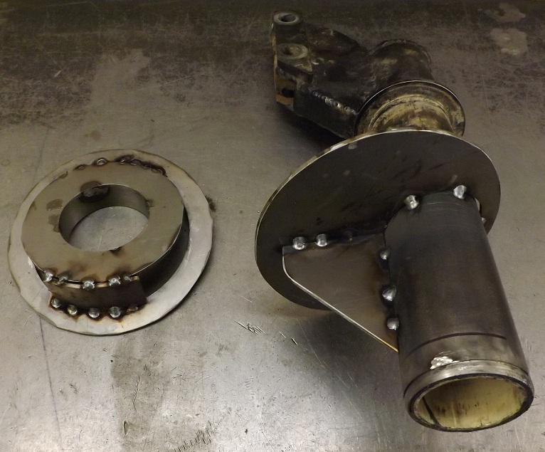

Got some Fox shock boots and put them on the rear struts.  A little modification was required but it's almost like the boots were made for the struts.  The boots are fully compressed when it hits the bump stops, so hopefully they will last.

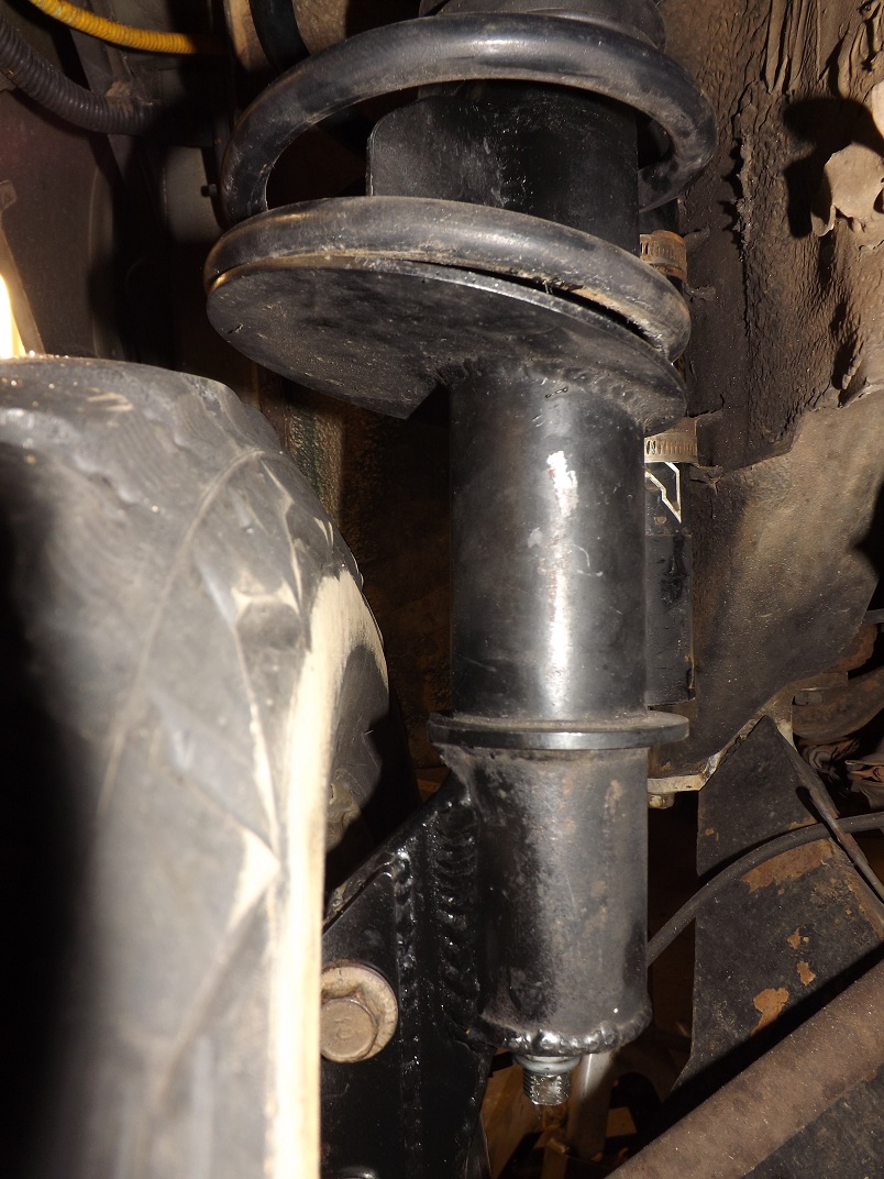

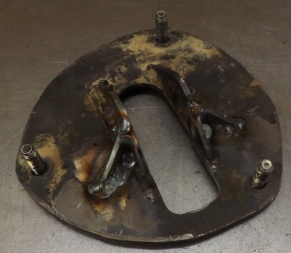

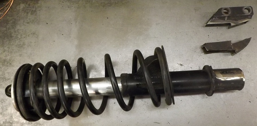

This is what the front strut looked like.  Way more sidewall clearance than we need.  This amount of offset caused a few problems.  One, it contributed to the friction/binding.  Two, it caused clearance issues between the inner side of the spring and the wheel well and reservoir.  Three, it made the strut swing front and back a lot when steered, which contributed to our hose pinching problem.
So I cut about an inch and a half out of it.
Also, it looked like the top plates were bending a little, so I gusseted them more around the slot to try to spread the load.
Here is what it looks like welded and painted.  Put the same shock boots on these, although I had to cut eight bellows off since the front struts are shorter.
Enough clearance at the top of the tire we should be safe even with new tires this size.
About an inch of sidewall clearance now.
The ride quality in town is good now.  I've hit a few things that send my Impreza flying and you can hardly feel them in the Outback now.  Hopefully we'll put it to the test this weekend.
