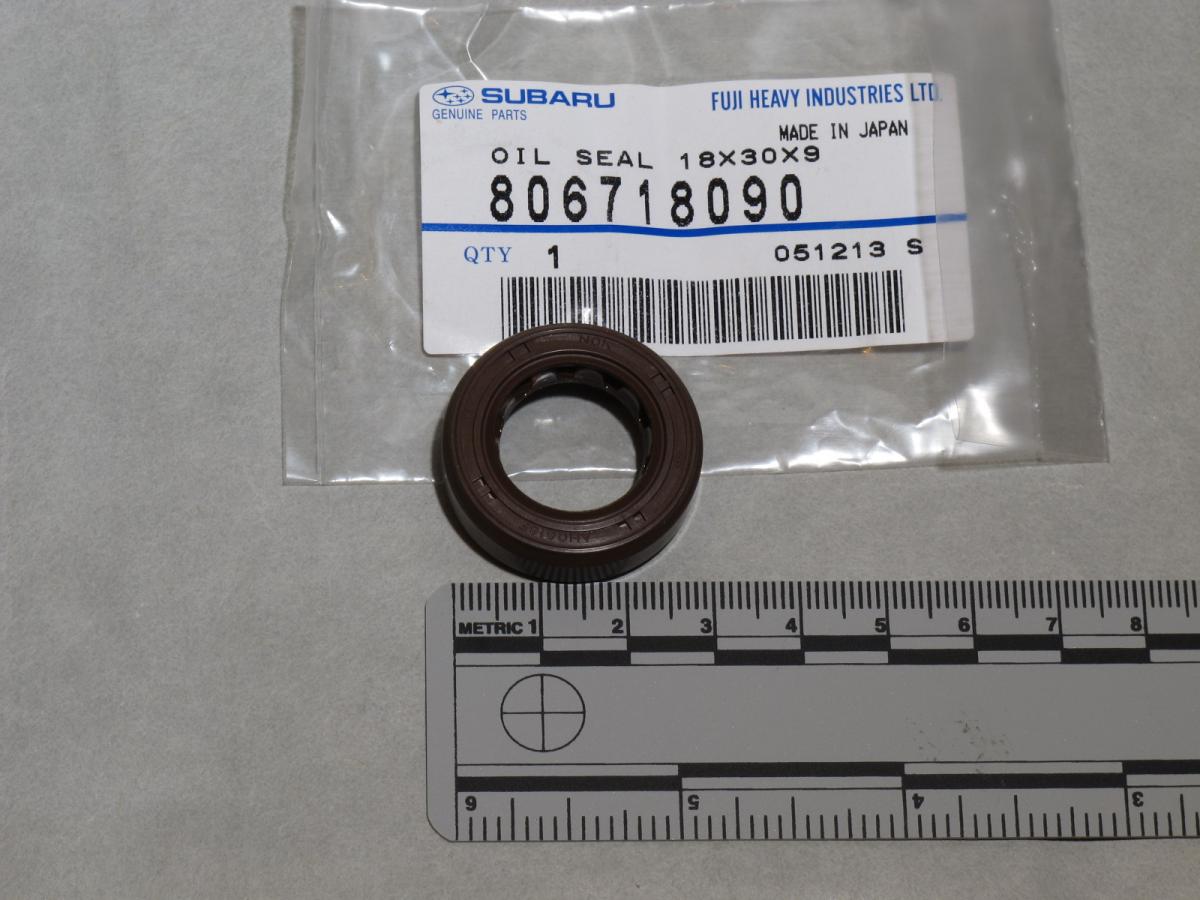

silverback Posted April 3, 2014 Share Posted April 3, 2014 What MilesFox said. The attached image is the stock Subaru oil pump shaft seal. Made of 'Viton'. If you are sucking air, a worn shaft seal may be one of the culprits. Quote Link to comment Share on other sites More sharing options...

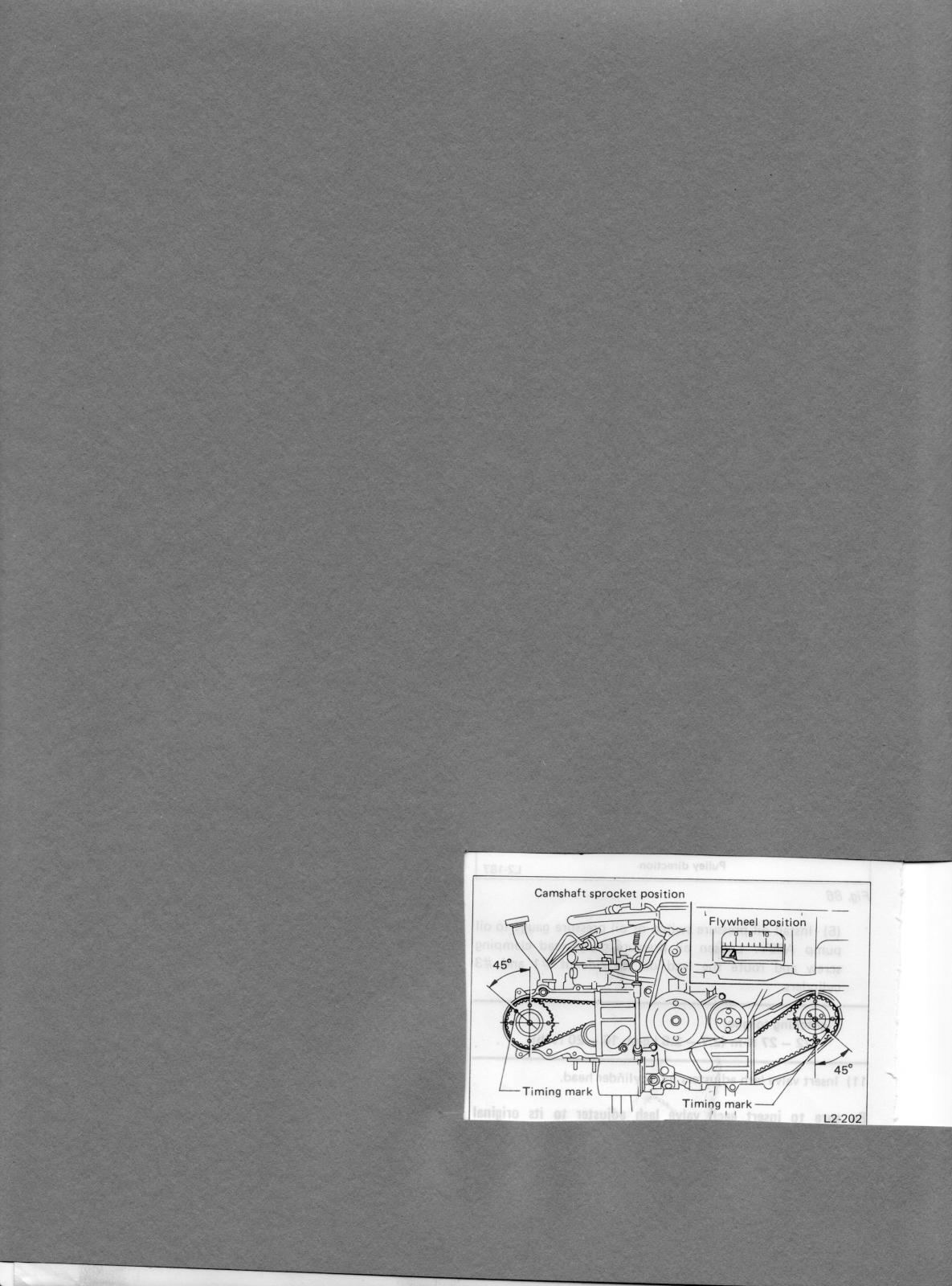

LucasP Posted April 3, 2014 Author Share Posted April 3, 2014 I'm just a plain idiot. I thought there were only four bolts holding the pump itself on... plus the pulley nut. Well after 3 hours I realized that there is a 5th bolt on the top that I hadn't seen. So ya... Then to add to my troubles I asked my gf to turn the ignition on to listen to music and she turned it on too far and bumped the starter with one belt off. So now I'm working on getting the belts back on correctly. There is a good video on youtube, but I can't clearly see the marks that I need to go off of. I'm laying under the soobie, looking at my 96 grand cherokee with full width axles and 37's and almost willing to deal with the 12 miles a gallon right now. lol. Thanks for the help guys. Quote Link to comment Share on other sites More sharing options...
silverback Posted April 3, 2014 Share Posted April 3, 2014 (edited) This will help. Print 5 copies; 1 to look at, 1 to spill beer on, 3 to slime when you are doing the belts. Also, when you go to install the pump, put 2 dabs, small dabs of sealant on the case split lines. Edited April 3, 2014 by silverback Quote Link to comment Share on other sites More sharing options...

LucasP Posted April 3, 2014 Author Share Posted April 3, 2014 This will help. Print 5 copies; 1 to look at, 1 to spill beer on, 3 to slime when you are doing the belts. IMG.jpg Also, when you go to install the pump, put 2 dabs, small dabs of sealant on the case split lines. That pic was literally my saving grace this morning. Tdc 15 minutes the "silver slayer" as I'm calling it was back on the road. Quote Link to comment Share on other sites More sharing options...
