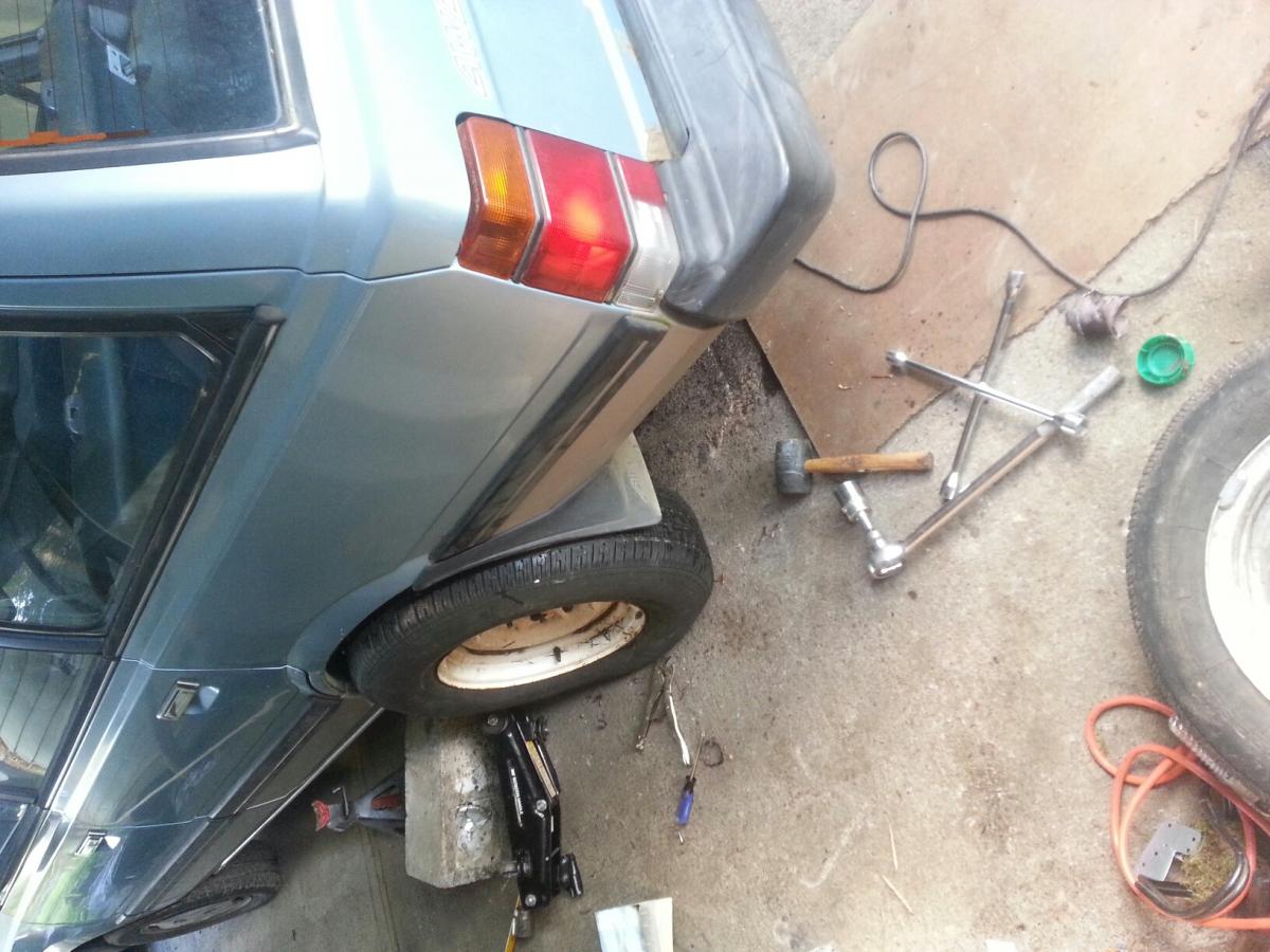

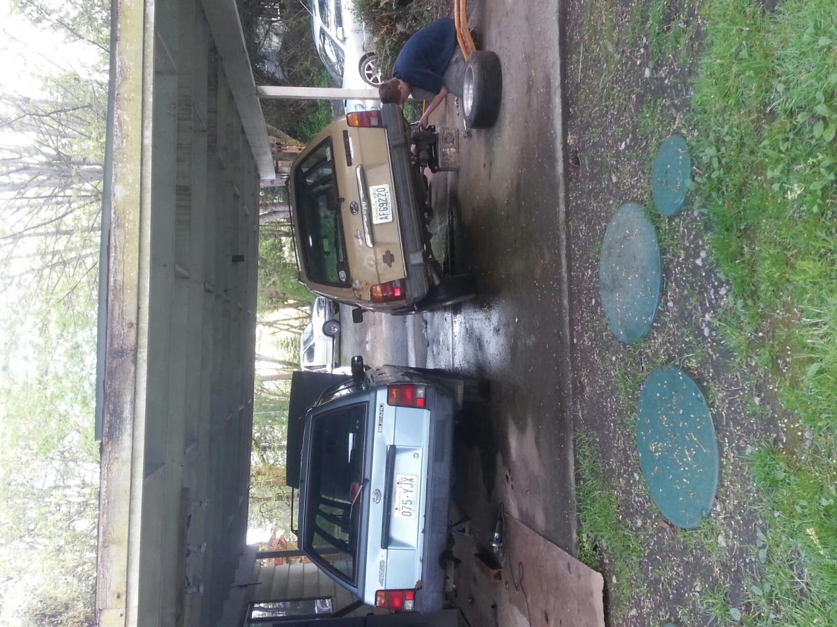

April 26, 201411 yr Author Well there on! Maybe because the Ea81 drums are warn they fit. I did have to reset the auto adjuster. Not sure if they work haven't gotten to drive it yet. Cheers! 27s stuffed under there

April 28, 201411 yr Author I measured the drums and they were the same depth in both spots i checked . So we will see. I only had to reset one self adjuster, the other drum just slid on. Both hubs slide straight on and bolted up know problem.
