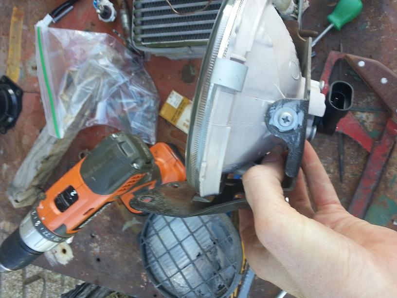

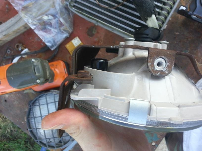

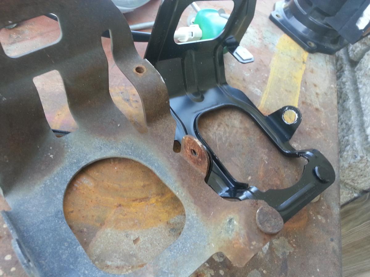

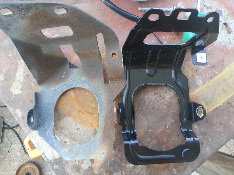

well my lights came last night and I looked at the old bracket and the new bracket and figured out that with a little modification to the old bracket the new lamp would fit. I had to trim the beam angle adjustment screw bracket and drill out the tabs to a larger dia then mount the lamp in the old bracket. it worked a lot slicker than I first expected
I had some trouble up loading pix on that last post. here are the pix of what I did.
Nice work..........is there any protective cover over the lens to lessen potential damage??
the old ones had the plastic grill in front I havent tried to see if the grill will snap on the lights yet, it looks like the lights have the tabs to hold the grill. I'm not shure how much good that plastic does. the new lights are significantly heavier plastic reflector and front glass.

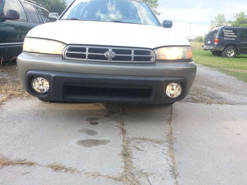

From your pixs, it looks like your headlight lenses are rather fogged up due to age. This cuts back the amount of light in front of your car. Various kits are available to clean off the frosting. I have used tooth paste on a wet paper towel to clean off the frosting. It helps, but is not as good as using a kit designed specifically to clean the lenses.

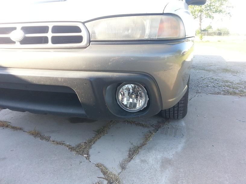

I got a rain-x product from az. The McGuire kit was about twice the price. I finally got time to mount the r side light tonight.
here's pix of final installed
