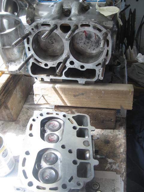

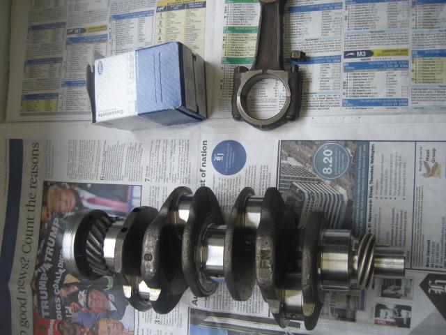

Engine was taken to Engine reconditioners.measured the crank,and bits.
Pistons were within measured tolerances,so life still left in them,so
didn't go for rebore and new pistons.So EA81 engine housings bore will
be honed,new rings STD standard size.Main bearings crank ground to new bearing
size of .010 for conrod bearings STD size.
of crankshaft after petrol washed blowen with compressed air,bearing
surfaces reoiled.

Cylinder heads skimmed.
Engine reconditioners total costs $270.00 NZ Dollars.

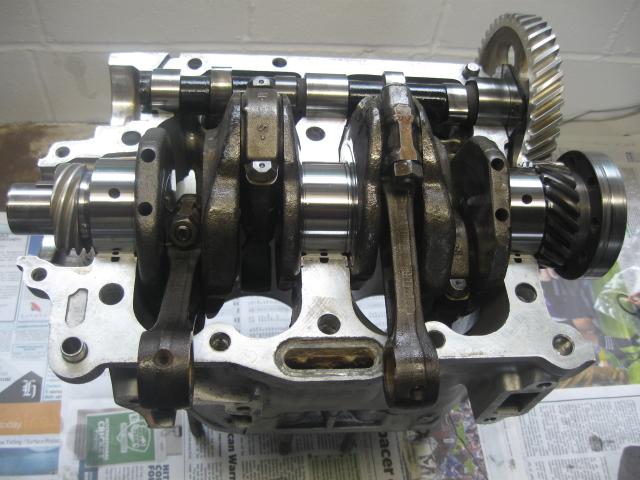

New bearings installed.All engine parts cleaned,
surfaces oiled,a mechanic was on hand,parts put back together
as Subaru factory service manual.
Main Bearings in one side.
Crankshaft in, and camshaft.These bits came from spare engine and conrods.
original camshafts and followers badly worn so thrown away.
All other engine parts reused.

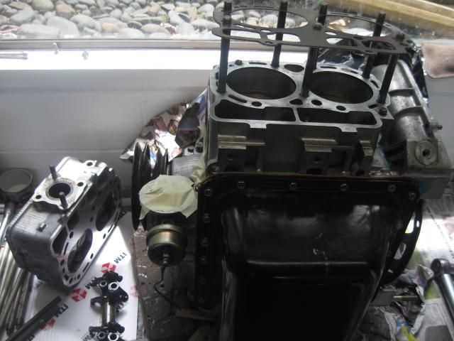

valves were lapped at home with valve paste,
while engine was away.
Freshed up engine in car.radiator sent away to be checked ,pressured checked.
