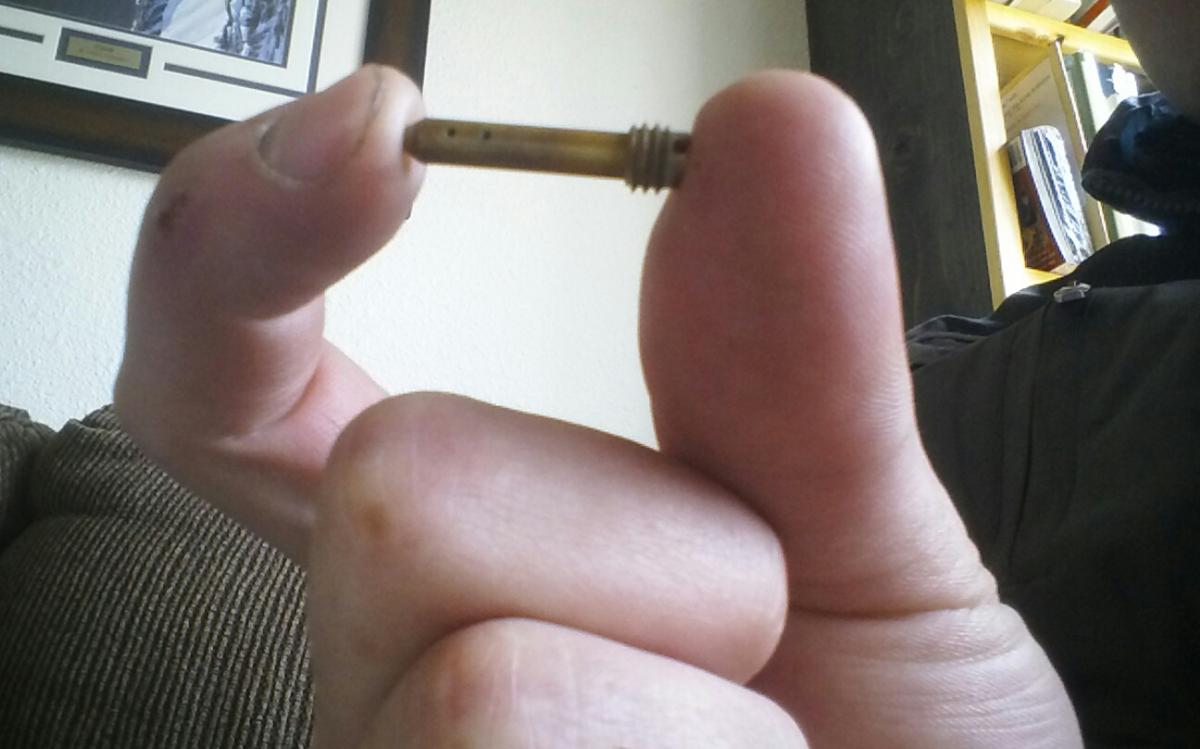

Is this the tube of which you speak of?post-54976-0-99500900-1427919082_thumb.jpg post-54976-0-64780800-1427917816_thumb.gifIf not, are the tubes in this diagram? if so which numbers?
Edited by Sapper 157
If it is #76 it is.
Make sure there is not a small piece of dirt inside.It does not take much.
I understand the confusion.Subaru does not call them emulsion tubes.
Check #23 as well
Might as well check the secondaries too.74.75
There are 4 emulsion tubes. No you must remove the top,of the carb to access them.
