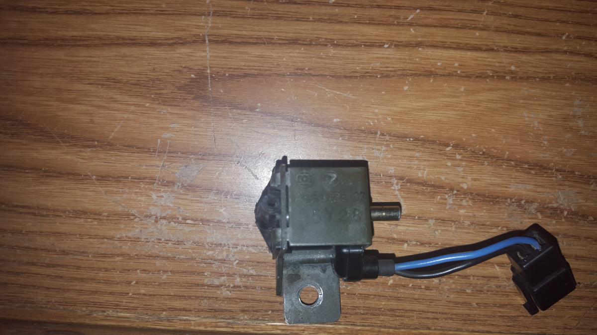

i did notice a small part located directly behind the thermostat that has a small tube going in to it that was broken. i took it to the auto part store and they could not seem to find out what it is. i also called a couple subaru mechanics and they could not tell me what it was either. if anyone can help me figure out what the part is or some other advice on what might be going on with my suby it would be so much help! i will post a picture of the part.

That is called a purge valve silonide what it does I don't really know. i have had one of those break too.. but I never died...

Plug the disconnected vacuum lines.
It will probably start.
All the solenoid does is to allow the engine to purge gasoline vapour from the charcoal cannister.

The plugs won't hurt anything. They are for reading codes from memory and clearing the memory. Just unhook them. I replace the solenoids with Toyota ones, since they don't break, or fail. +1 what others wrote regarding figuring out why it died.

What year and modle Toyota would have a erg selonoid that would work for this loyale ?

I will put a link to my Subaru mods page when I get home tonight. The Toyota model is not critical. They were using them at the same time frame as the GLs, 1988 ish. I have the very same solenoids in my current EA82s, that is how long the have lasted. I did modify the mounting brackets, and replace the connectors to mate with the Subaru harness.

Would this solenoid being broken keep my loyale from starting?
Thanks DaveT I'll check out that link when you post it.
Depends which port is broken.
If it is the one going to the intake manifold,then quite possibly.
If not,then no.
I think(not 100% sure) the steel port is the one connected to the manifold,so probably not.
