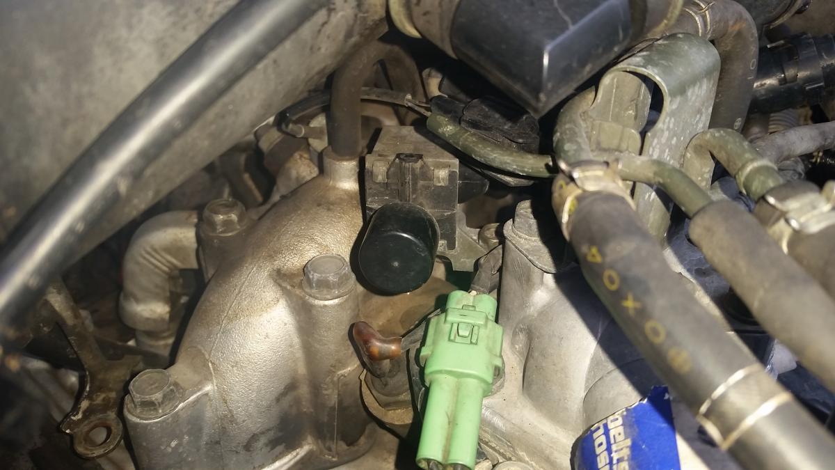

That is a soenoid. Probably the egr one. That vacuum leak will mess with it running correctly.
I use Toyota solenoids as they last ... well I never had to replace one yet. Since 1988.
Do you think i could just plug this leak for now? Or is that kinda important solenoid?
Plug it. It will run fine. You might not pass emmisions, but it won't hurt anything.
