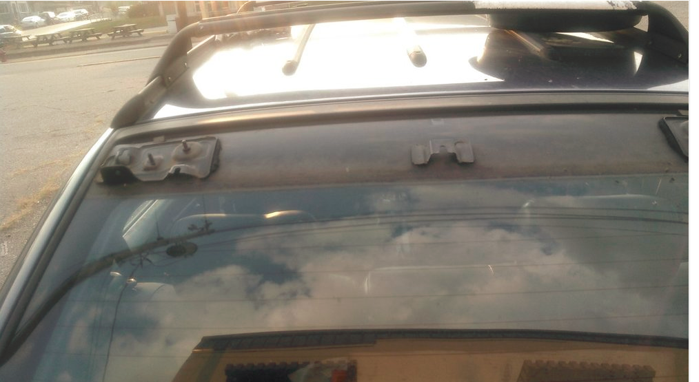

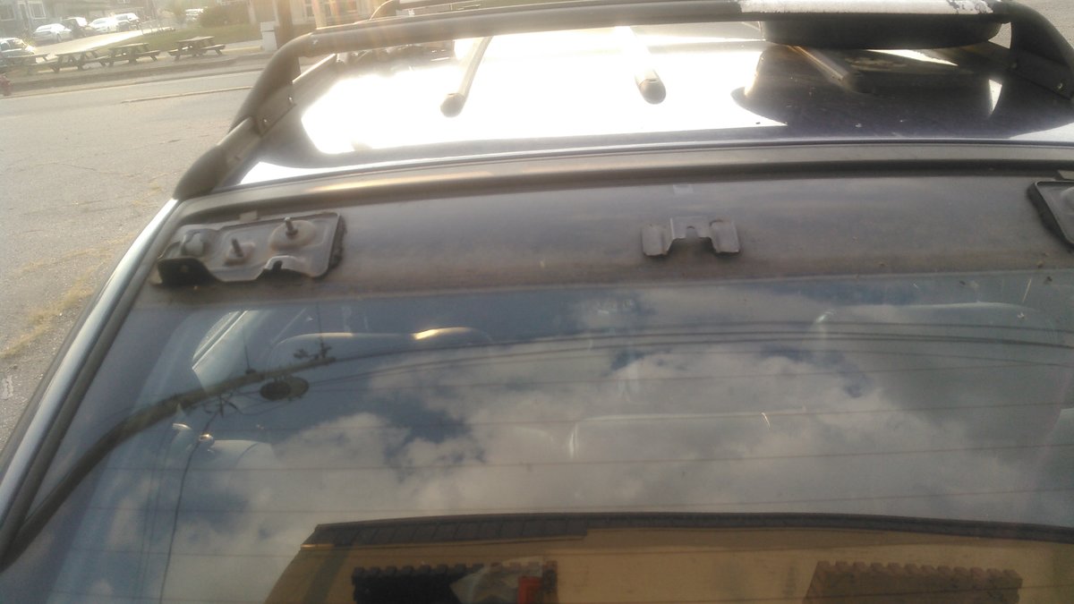

11 hours ago, brentlysubaru said:
The top spoiler attaches by a couple brackets that are glued on the glass.
That pic is priceless! Thank you! Now I know what I must hunt for, or try to make. I tried to find them in parts break down, without success.
Your welcome. I pulled the spoilers and brackets off a car I was scrapping. Took a pic to remember how they went back on. A while back I found the brackets on a Subaru website they were around $47 a piece. I just went back to it and they didn't list then anymore. I guess that they were discontinued.
