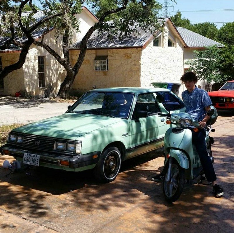

Thanks guys for the tips. @ebarb @jono @DaveT @Dee2. Had a friend of mine who's good with older cars look at it. Seems that the distributor was firing in the wrong order. Moved it a few teeth and aligned with tdc and it turned right over!

Feedback is what we like . Nice looking old beast. Is the colour the same as your bike or some optical digital illusion?
