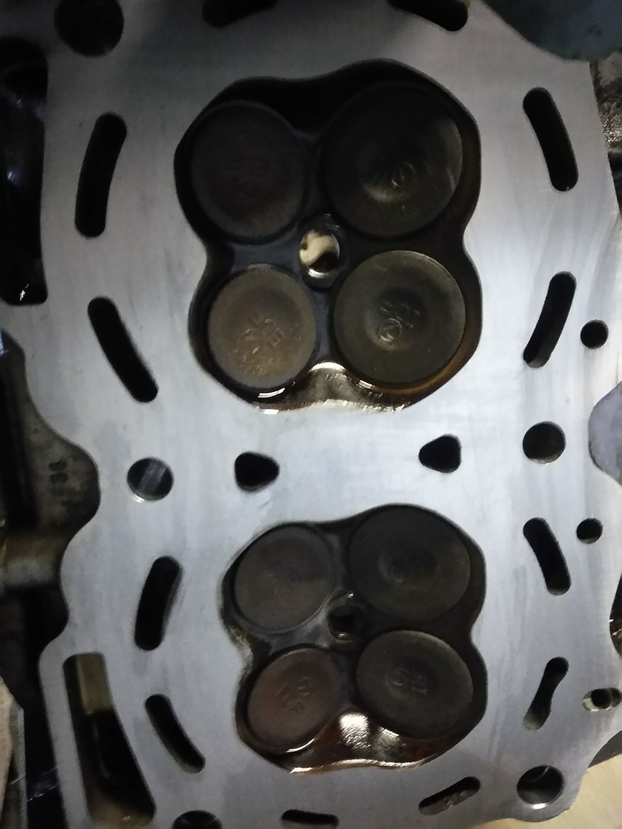

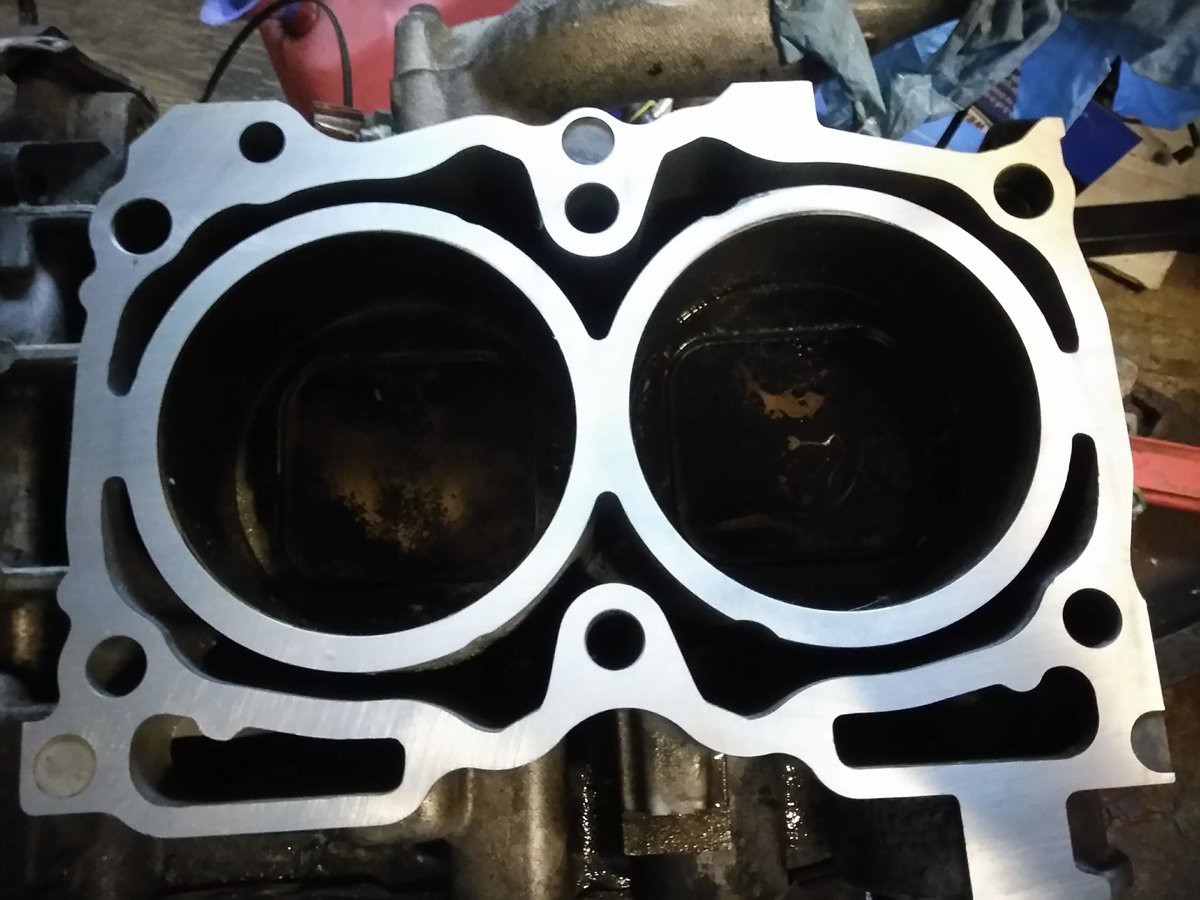

November 1, 20187 yr Author so I have this one bolted down do I have to replace it? can I just remove the bolt, (center intake side) and chase it and install it again. or just leave it. What dealer are you using? the one in Vancouver Washington wants 80.99 each. i got to find a better dealer. maybe I can get them at a different dealer and return them to this one? Here are the surfaces before bolting it together. I do have a spare bolt, so I will see if I can slot it and chase the other side. Edited November 1, 20187 yr by whynot
November 1, 20187 yr Any of the dealers in Portland..... our account is through Lithia Subaru in Oregon City. Subaru of America MSRP is 49.95 retail. parts.subaru.com Gresham Subaru is good. Carr Subaru in Beaverton has largest inventory and lowest wholesale pricing for high dollar customers. I have been offered 33% off retail to do my business with them but the distance is too far and I get 28% with Lithia. Having that relationship 1 mile from my shop makes it much easier to run down between deliveries if we need something quick (pretty much a daily). If you haven't run it - just take it back off and chase the threads - retorque it with Amsoil assembly lube. If you can't find anyone up there that has it I carry the assembly lube here at my shop in Milwaukie. It's like $6. GD Edited November 1, 20187 yr by GeneralDisorder
November 1, 20187 yr Author so I can take the head back off, and use the same gasket again? never done that before, always had to change them. Just making sure. If I can then I will do that. Also how big of a slot in the bolt. I have a cut off tool, and a 4" hand grinder, Thanks again.
November 1, 20187 yr I would put the bolt in a vice, and use the cut-off-wheel. Slot the threads 180 degrees apart all the way up the threaded section. Width of the cut-off-wheel, 3/16 depth or as close as you can. Try to keep the edges nice and tight and sharp. Yeah the gasket should be fine. It probably needs more torque than it got with the creaking bolt anyway. GD Edited November 1, 20187 yr by GeneralDisorder
November 1, 20187 yr Author another question. I used 220 grip paper to surface, is that good enough, or in an old post I found to use 220 then 320. I am taking it apart again, is it good enough, or hit it with 320 before going back together. Thanks again for all the help.
November 2, 20187 yr We actually use a 150 grit cloth backed media. https://www.amazon.com/INDUSTRIES-4245-Emery-9-Inch-11-Inch/dp/B000BPNMZ4/ref=sr_1_cc_6?s=aps&ie=UTF8&qid=1541177698&sr=1-6-catcorr&keywords=ali+150+grit We make two passes - the media sheers down to a finer grit so on the second pass it's much finer than 150 grit anyway. GD

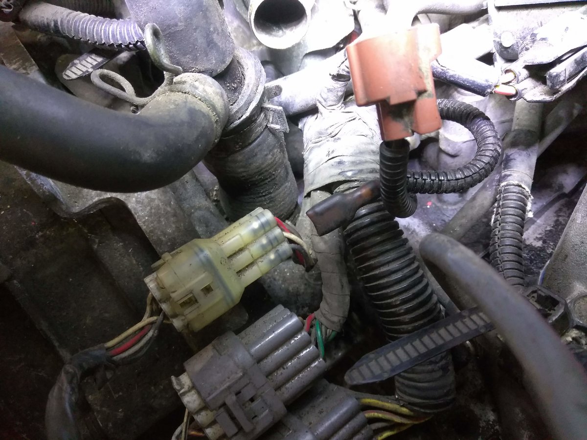

November 12, 20187 yr Author back again. maybe I should start another thread.? Got the engine back in. Very hard to start. but when started idles fine. Also have code p0117 coolant circuit low input. can you tell me where to look for that? if I did not plug something in, would that also relate to the hard start? Thanks Doug
November 12, 20187 yr Yes - that is the coolant temp sensor on the back of the coolant cross-over. Next to the gauge sender. Both are at the back to the left of the throttle body. GD
November 12, 20187 yr Author so i found thee 2 plugs, the spade connector i found where it goes, the 2 pin one, i can not find a home for. i assume it is one of the two you mentioned. going to go look again,, also on the crossover near the other one? also, the alt. is not charging. does it go anywhere except to the battery? the bolted wire and the plug connection.
November 12, 20187 yr Yeah it's right next to the one with the spade. Much easier with the intake unbolted. LoL. The alternator just has the two connections. Check the fuses in the main panel under the hood. GD
